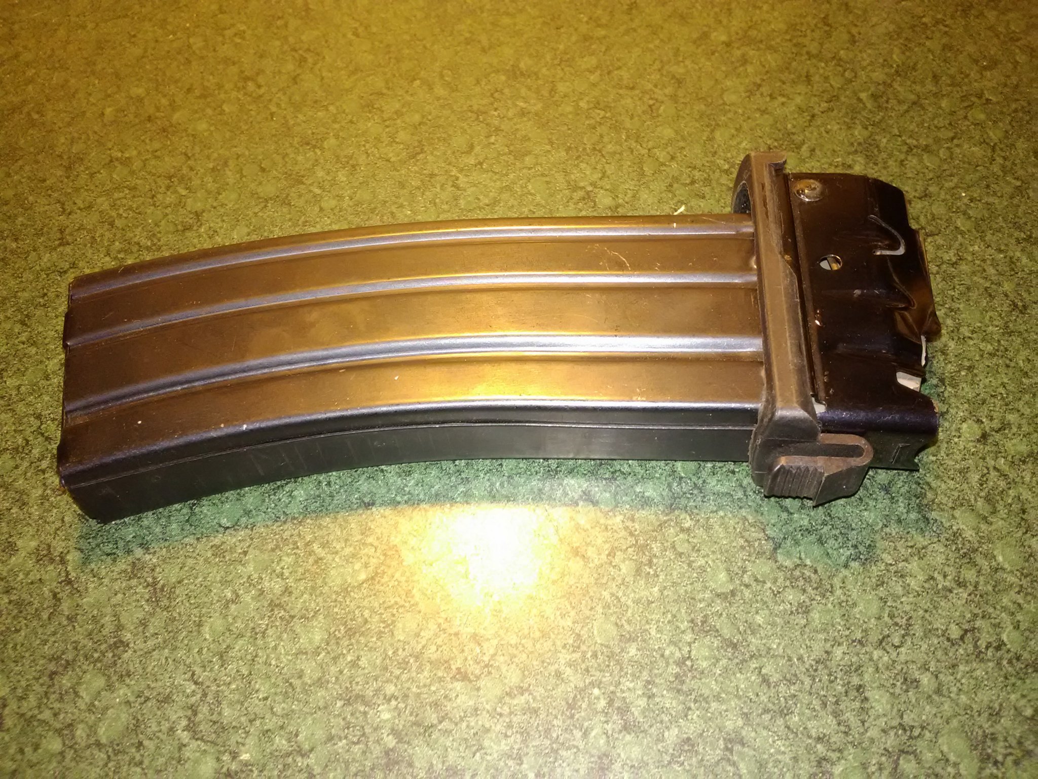

The Savage Axis extra magazines are expensive. I have a .223 Axis and wanted more than 5 rds, so I took the magazine, popped off the plastic part, and welded an AR-15 magazine to the bottom of it. Cut off the top of the AR mag, did my welding magic, and popped the plastic part back on... Works like the original, but now holds 25 rds.
I had to grind the plastic follower a bit to fit just right into the top of the Savage feed lips, but it works just fine. I think you could use just about any .308 metal magazine, if you were so inclined... A 10 or 20 rd'er could be cut down to accommodate whatever number of rds you wanted.
