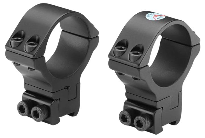

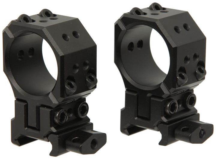

You can shim but you have other option. The mounts below are adjustable for windage and elevation. Once set, they have set
screws to lock their positions so your not dependent on friction. They also have less expensive elevation only mounts.
The second photo is elevation only. They lock also.
