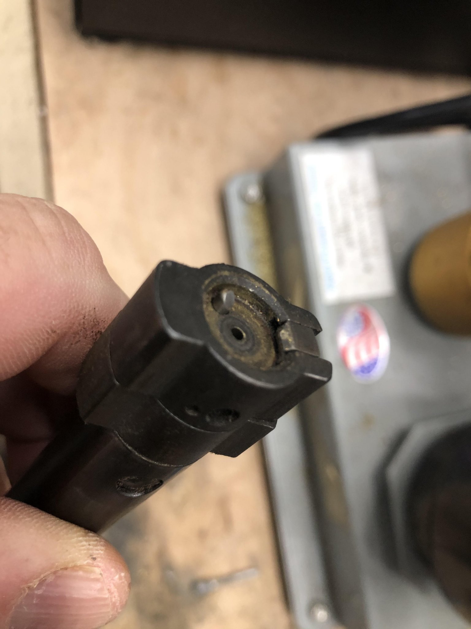

ok I watched the video. would you take a picture of the bolt face. I had the same thing with mine and it turned out to be a very simple fix. The ejector plunger didn't have a bevel cut and was forcing the base of the cartridge over to the right and would bind in the chamber.

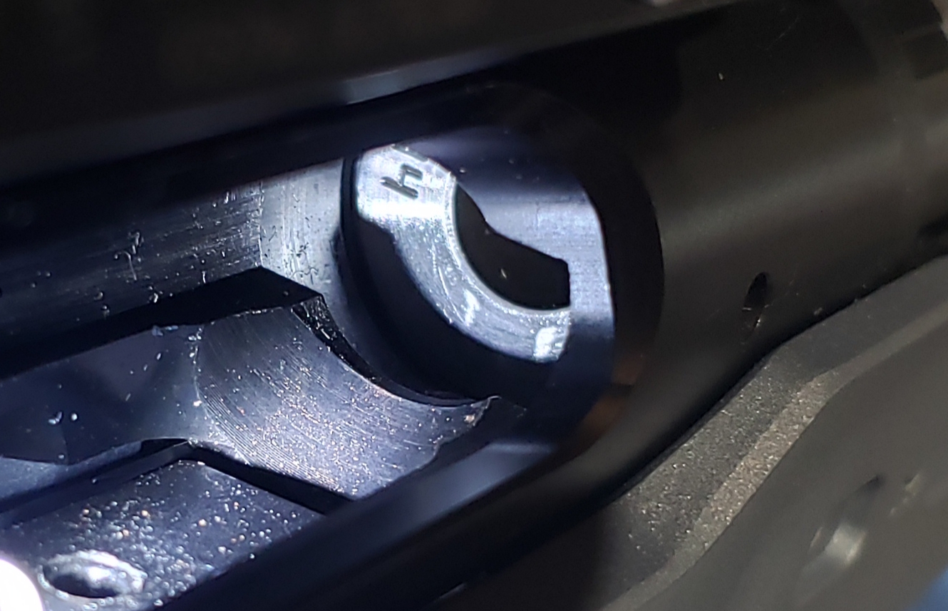

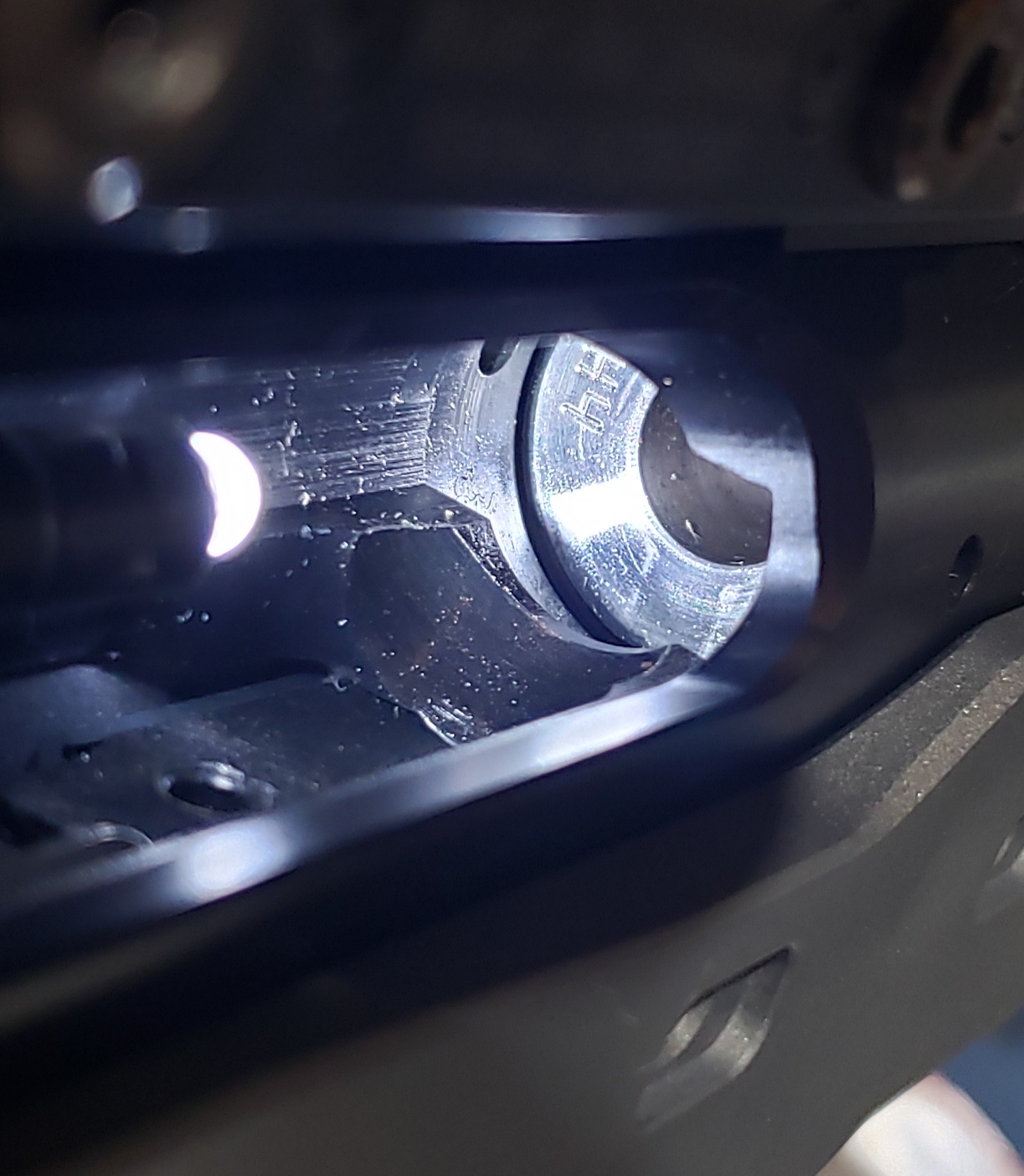

Whats the chamfer look like around the breech/chamber? I bet its sharp and case is digging in/hanging up crooked. Once pressure is let off bolt handle, case falls down and feeds in all the way.
For the ammo that I tested in my video mark I do not see any scratches on the copper jacket either.

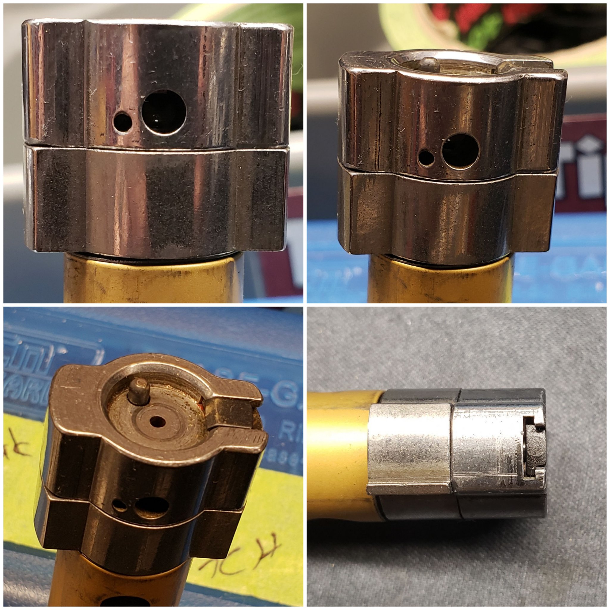

I posted this awhile back but will throw it out there again. I have seen this problem with savages before. It was with the ejection upgrade kit many buy for savages considering they extract okay but eject like shit. The rounds were doing exactly as what you are describing. Bending magazine feed lips did dick. Taking the plunger ejector out and taking off a small amount of material so it doesn’t protrude so far away from the bolt face fixed it 100%. It’s literally a few dollar part. It can’t hurt anything to try.
Reactions: CodeMonkey
I do have the ejector kit installed, and this sounds reasonable (and I have a spare).
I measured the factory ejector plunger length to be 0.100" from the pin notch and the aftermarket elector plunger at 0.125" from the pin notch. I ground about 0.010" off of the aftermarket plunger leaving about 0.115" length measured from the pin notch.
That seems to have done the trick. I ran 5 rounds from the Magpul and MDT mags through the action several times and didn't have any binding. The Magpul seems to run smoother, but both worked perfectly. Ejection is still better than the factory setup and I can't really tell that shortening the plunger made much difference (I think the stronger spring accounts for a lot of the improvement with the ejection kit). Thanks @wade2big for the help!

Exactly, 99% its the ejector. I stretched the spring, took a tiny bit of material off the tip to give it a bevel and took a tiny bit of materiel off the groove in order to give it .030 more travel. Then put a slightly larger ball bearing under the extractor. A couple other things to really enhance the rifle was bedding the 20 MOA rail to the receiver and the chassis. Now it comes takes a beat down and has zero POI shift. TW-25 is awesome lube for these guys. The word is a whole new trigger group is on the way. I'll be excited to see what that is like.

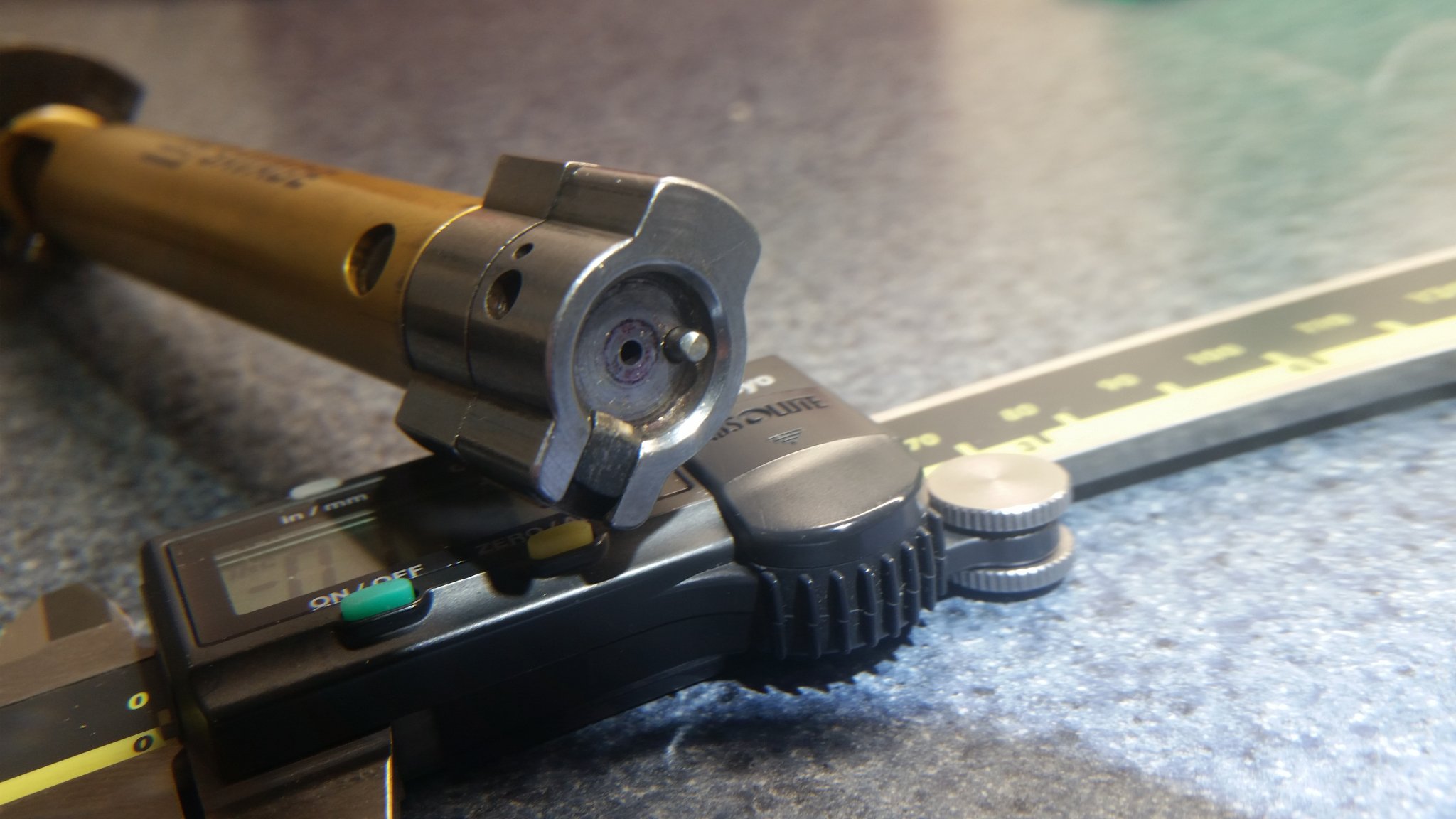

I've been having the exact same issue shown in the first video.
Then I removed ~0.004" from the ejector pin and added a small chamfer but I goofed and didn't put the chamfer on the correct spot.
I no longer have any jams or feeding issues and can load rounds as fast as I need to.

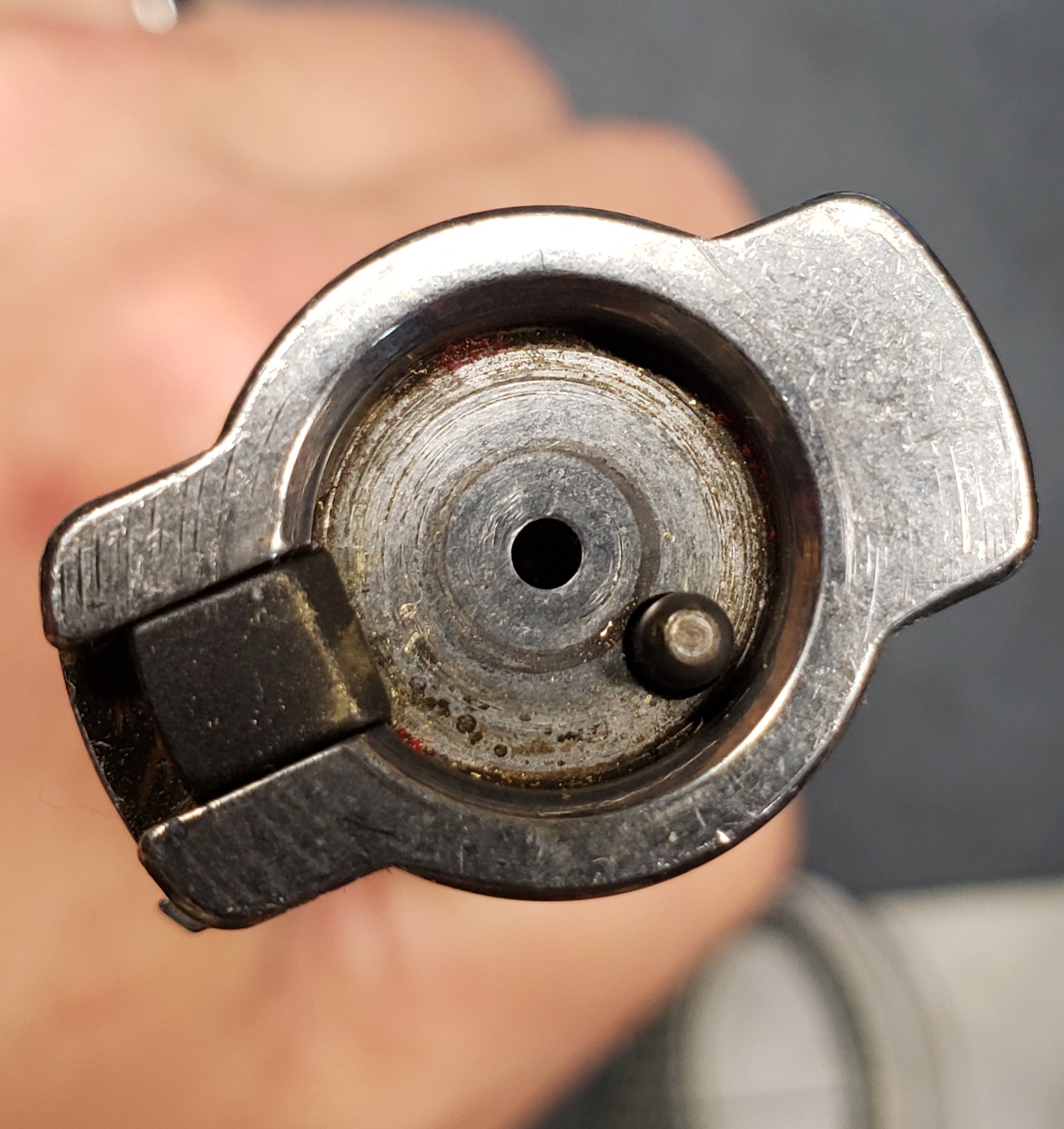

Huh, guess I'll buy some ejector pins if pulling mine helps it feed correctly.
Put in one of those kits when I rebuilt a Savage and now I have to load slow as the rounds hit the breach face at the top if I run the bolt to fast.

Pulled the flat face ejector that came in the kit and pulled a rounded savage from another bolt head. Cycles great now.
I noticed the one that came in the kit stuck out passed the head and also the relief cut for the retaining pin was to long causing it to stick out and catch. So it's basically junk. The whole kit is not worth the money. All you essentially get is just a larger ball bearing for the extractor.
