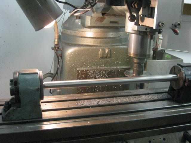

Here are my homemade tools.
First I cut the barrel down to 20 inches and threaded it 5/8 24
Then came the muzzle brake machined out of some 304 stainless.

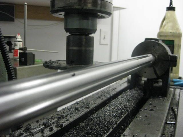

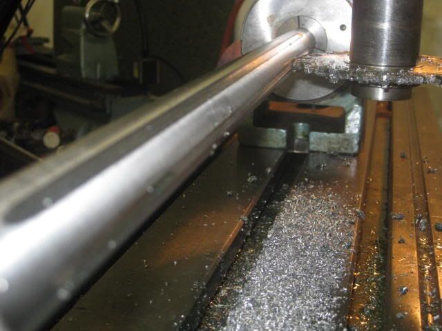

I then wrote a program to flute the barrel.
I know a lot of people use a 1/4 ball endmill, but I have used this set up many times and it works great for me.

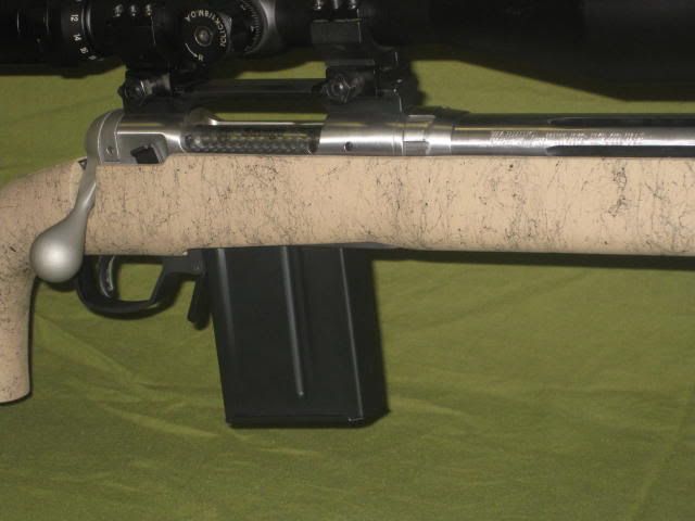

I ordered a Bell and Carlson Stock, I'm very happy with the fit and finish, I believe that this is the best bang for your buck on the market, It has a nice Alum bedding block the fit was perfect. I also installed a CDI bottom metal, and ACI mags.

But that's a button rifled barrel. Everybody know that you can't flute button rifled barrels. The bullets will come out upside down or something.
Nice job. Looks fantastic.
Re: Savage finally finished and ready for the range
I've heard all the hype about fluting barrels, I've never had any bad experiences in the pass, not to say that I won't in the future. I've always taking the safe approach to fluting in my eyes, I only flute a .1875 wide and never exceed .075 depth, which equates to a very shallow groove. With this depth the wall at the front of this barrel at is smallest point is still over .200 thick and at the receiver end is .287 thick. I don't believe that I'll have any problems, also when the money comes around I had planned on a Broughton Rifle Barrel so if there are any issues I have to scrape up the cash sooner. Anyways looking forward to shooting this weekend, I have a 600 yard range calling my name. I got to finish loading my Sierra 175 HPBT match with 43 gr of Varget. I post my results.

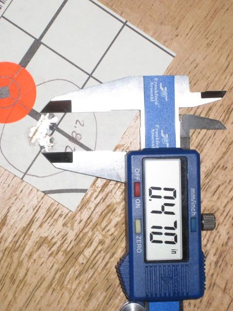

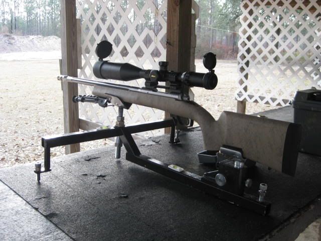

Well I got to the range today and did a little testing. Overall I'm very pleased with the results, I had to fight the wind somewhat. I played around with bullet seating depth and I think I've found the best depth for accuracy.
She looks good on the rest.
I loaded 3 rounds in .002 increments from my max bullet length I watched my groups tighten up and then loosen back up. This was when things started to come together.
The best of the day and now I going to reload all my bullets to this seating depth.
