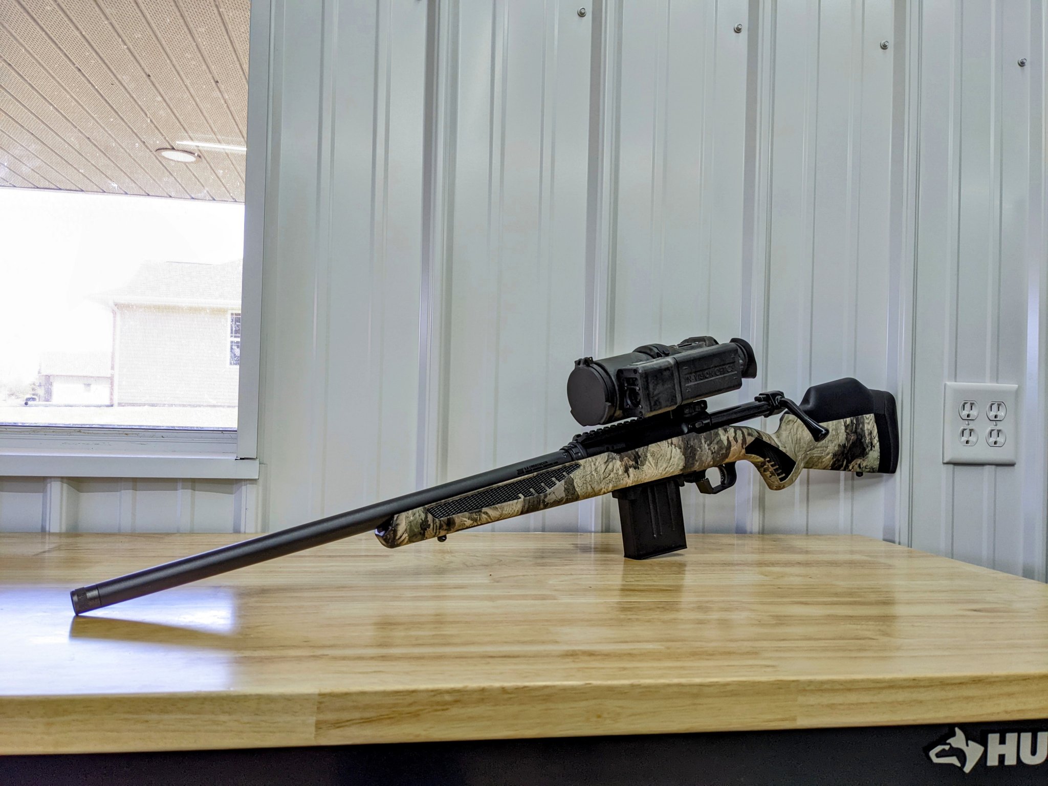

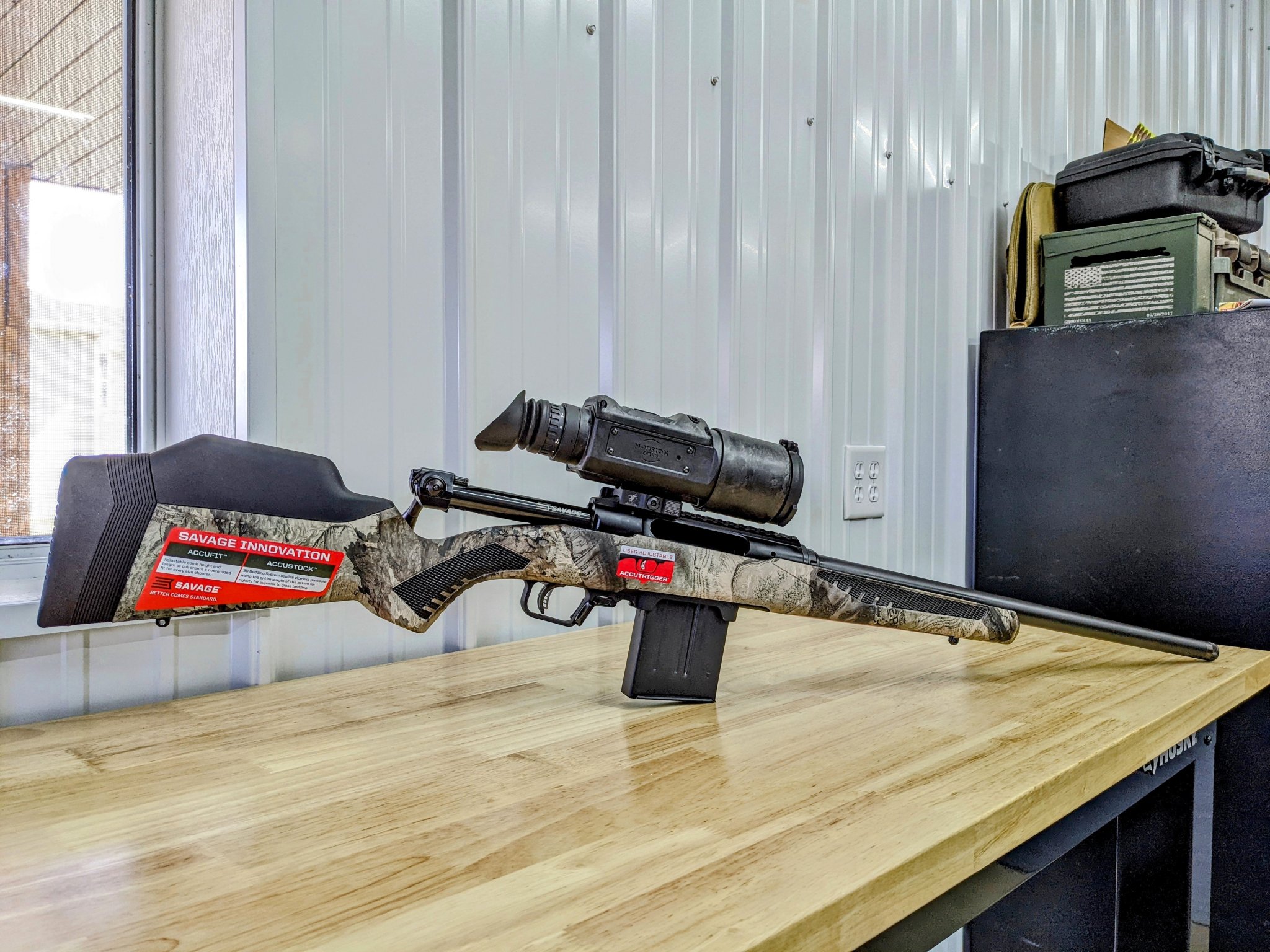

Sorry in advance for the long read.... About 5 months ago I called a local gun shop asking about this rifle. Guy i spoke with said he couldn't find any right away but would keep looking and get back to me. Never heard anything from him. Had completely moved on.. (bought 2 other rifles since we spoke) Last week i get a call and he says I've got your Savage Impulse Predator here come on in and sign the paperwork when you get a chance... I said uhh what?? Explained to him that was 5 months ago or better and nobody ever called or got back to me!?!.. We agreed id go check it out and make a decision after... Well here we are lol Wasn't real excited about it but after just working the bolt and trigger im very excited to see how it shoots and try something different!! I'm a right handed shooter but since it's ambidextrous I'm going to try working the bolt with my left hand from the start. Will be for coyote hunting at night off a tripod.

Anyone else have one? Curious to know how it's shooting and if you're happy with it
I just felt the bolt on one in a Cabela's. It felt awful. Way hard to cycle unless you really forced it. Seems like a nice smooth bolt action disturbs the gun way less and is just about as fast in the right hands.
I kind of felt the same way while holding it and working bolt in right hand but on a tripod it's much better and after swapping bolt to left side and changing the angle of handle more forward it feels VERY smooth to me. And i get zero hang ups. Time will tell but on a tripod it's completely different.
