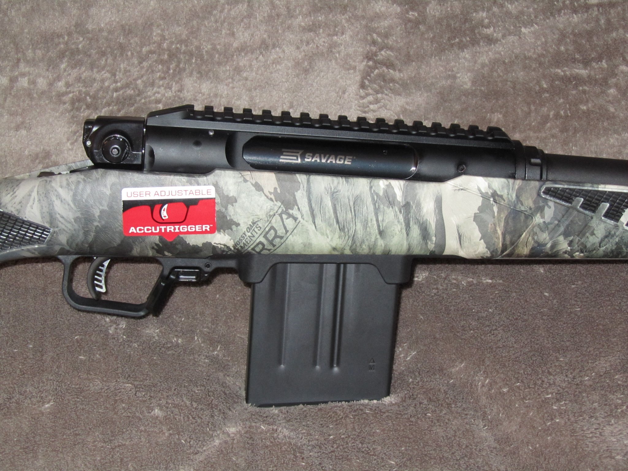

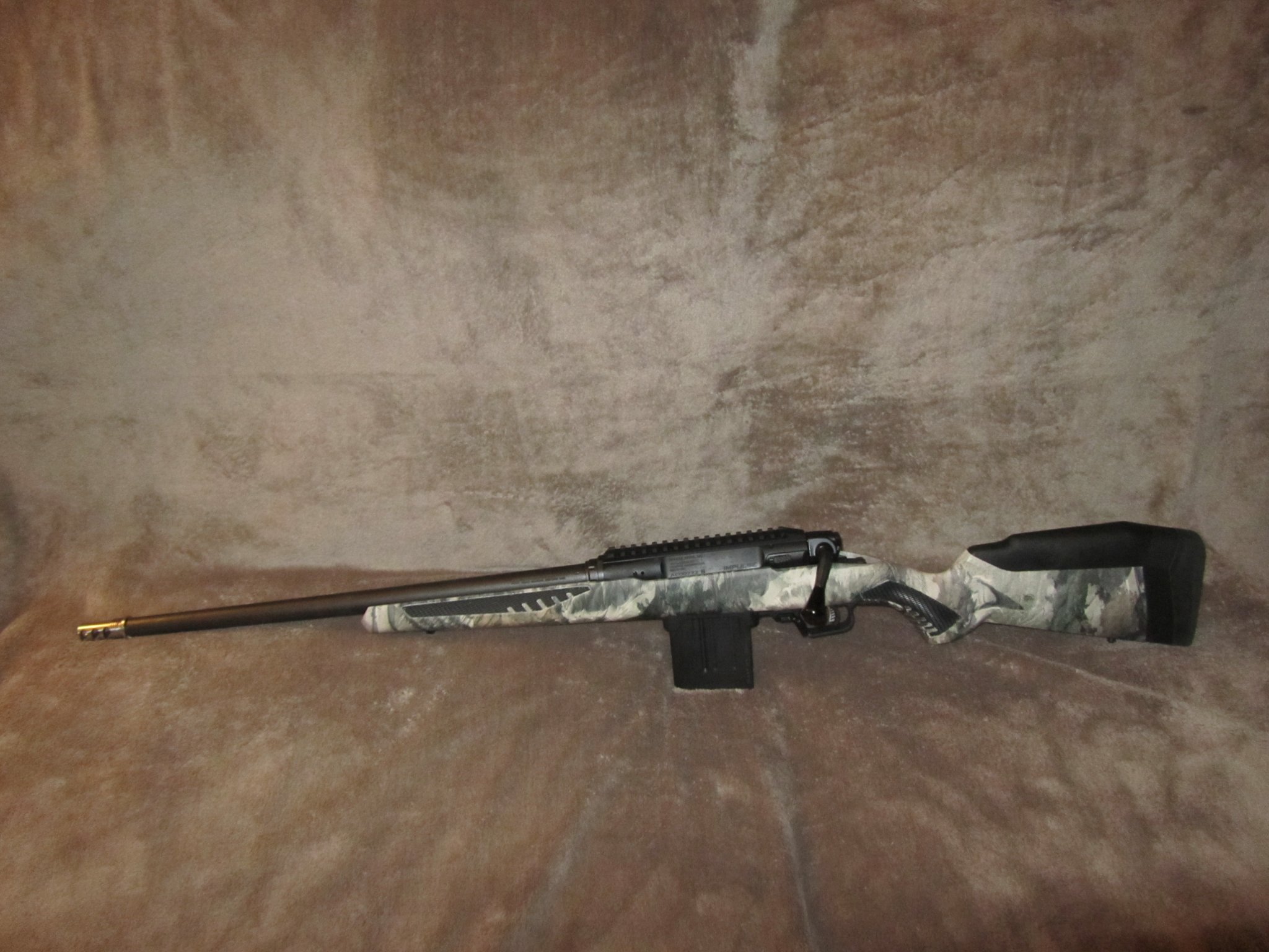

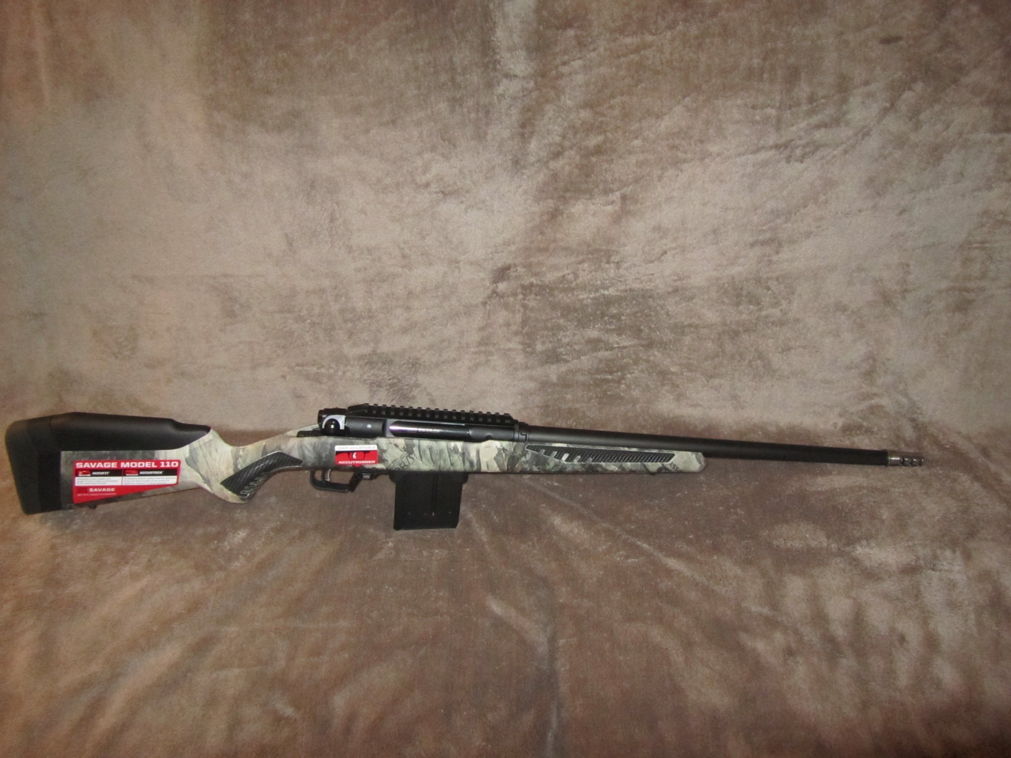

I got my Impulse Predator in 243 last weekend.
Great rifle, but very barrel heavy.
For better balance, Savage should've offered a fluted the barrel on the Predator model, like they did with the longer barreled Big game model.
Trigger was set to 2lbs from the factory and passed the drop test.
The Predator model is short action and only accepts Metal short action AICS magazines.
Pmags will fit with severe modification, but won't function at all because of the amount of material that's removed to make it fit.
Everyone has complained about feeding issues with Savage factory magazines.
Savage was listening and has taken care of the issue.
Even though it uses a barrel extension, they kept the barrel nut.
Being I'm a senior member of the barrel nut community, I salute Savage for doing that and see it as Savage giving the middle finger to the barrel nut hater club.
Bravo Savage !
As with most Savage rifles, it's accurate out of the box.
It was rainy and windy today at the range and it still shot small groups with all of my test loads.

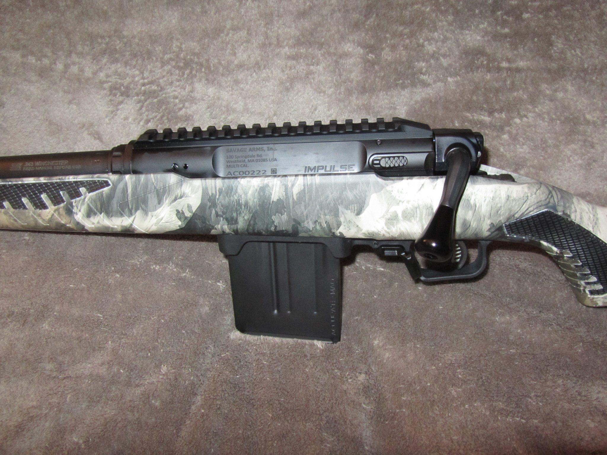

I'm a southpaw and had no issues with brass being ejected from the right side only port.
I actually prefer a right side port, as I can inspect the chamber easier and load single rounds with my right hand without losing grip of the rifle.
Every other function on the rifle is totally ambi.
If it came with a fluted barrel, I wouldn't have one complaint.

Mine is 8 lbs without optic+ rings and unloaded 10rd mag.
All of the weight is in the barreled action, which makes it barrel heavy, like almost every American made rifle.
A Fluted barrel will solve the weight/balance issue.

Bolt was slow out of the box, but slicked right up after a thorough cleaning and an application of slide glide + kroil.
My 70+ year old uncle has no issues operating it.
One thing to note, Almost every person that has tried to cycle the bolt for the first time forgets that it's straight pull and try to lift up on the bolt while pulling it, causing it to bind.
They have no issues once they get used to just pulling it straight back.

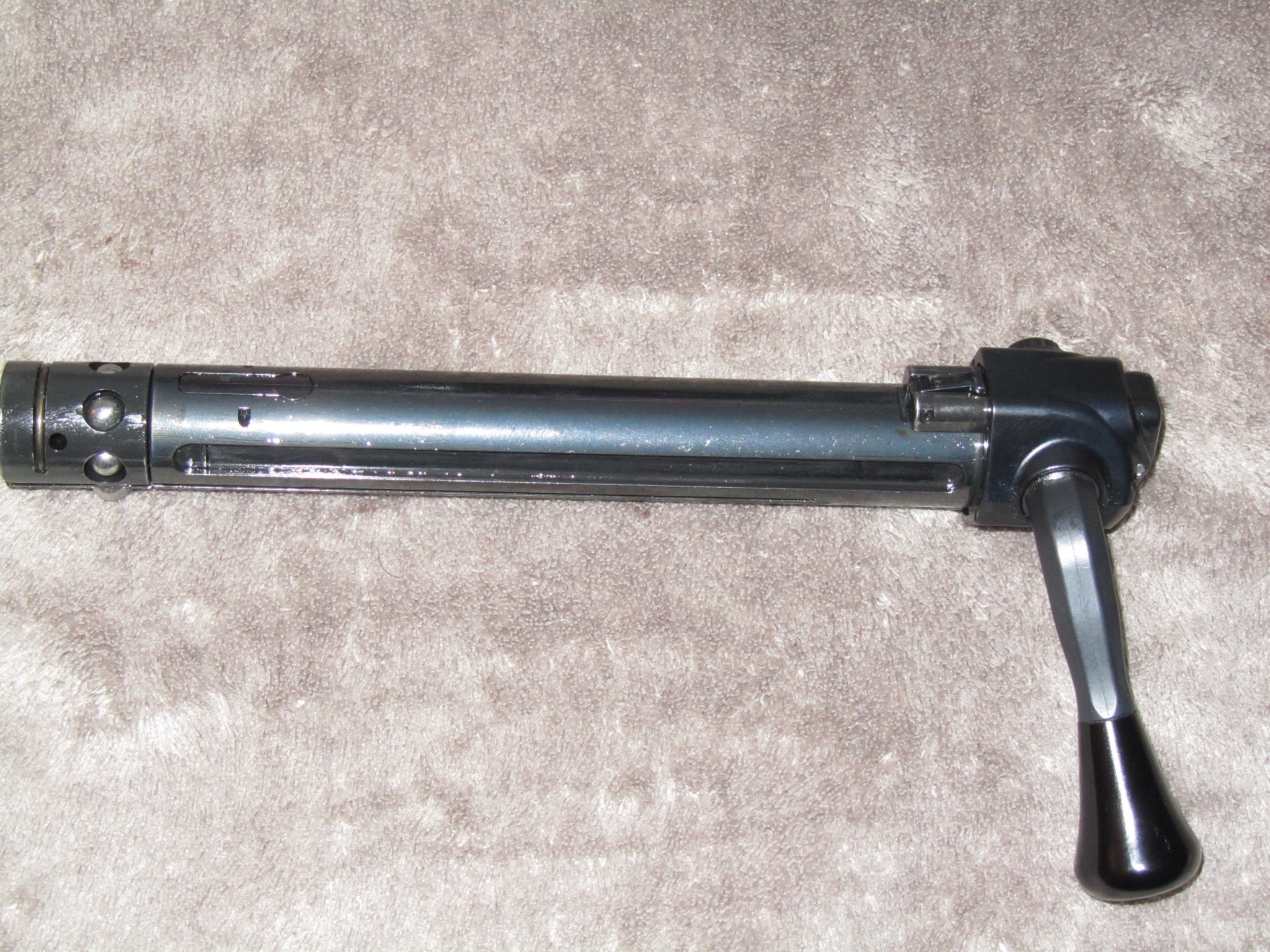

The action inlet is totally different than a std rifle, that has a recessed area for the bolt lugs to lock into.
Being it's a straight pull, it's a round hole that the bolt head enters and behind that, there's a circular groove where the bolt's bearings lock into it.

Barrel screws into extension.
Extension with barrel attached is then inserted into the receiver and mechanically locked into place.
A lot of rifle manufacturers use this type of method.
That lovely barrel nut means you can change barrels yourself.
If Savage makes barrel extensions available, you can have multiple barrels head spaced and ready to go.
Of course you'd have to remove the action from the stock to do it, so it's not as easy to swap barrels as a DT or AI.
