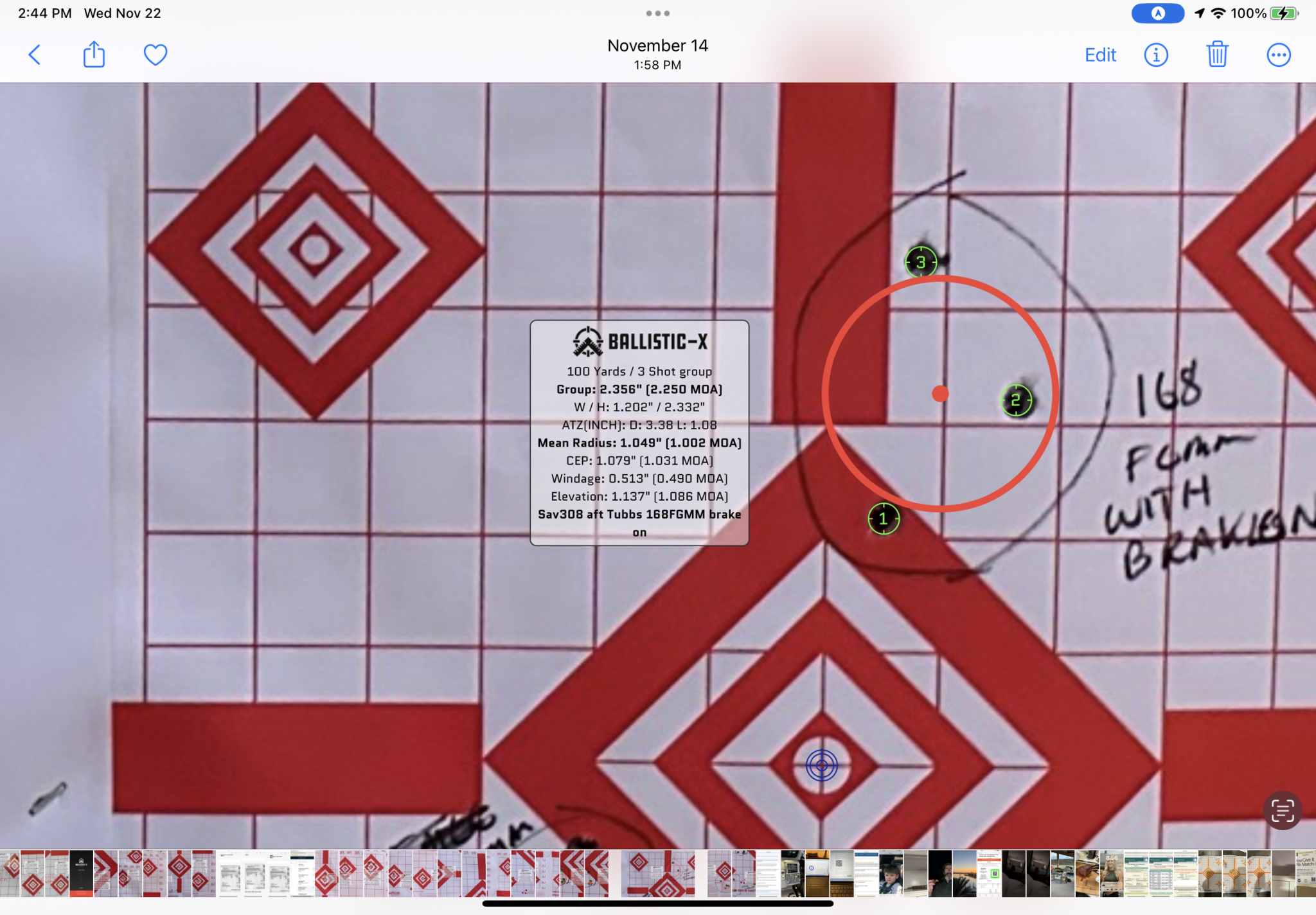

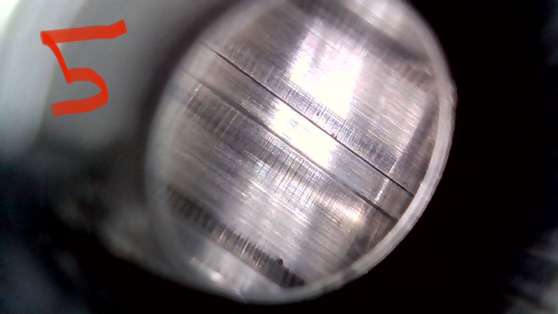

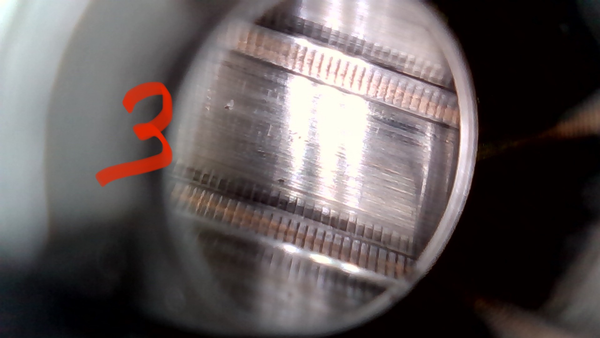

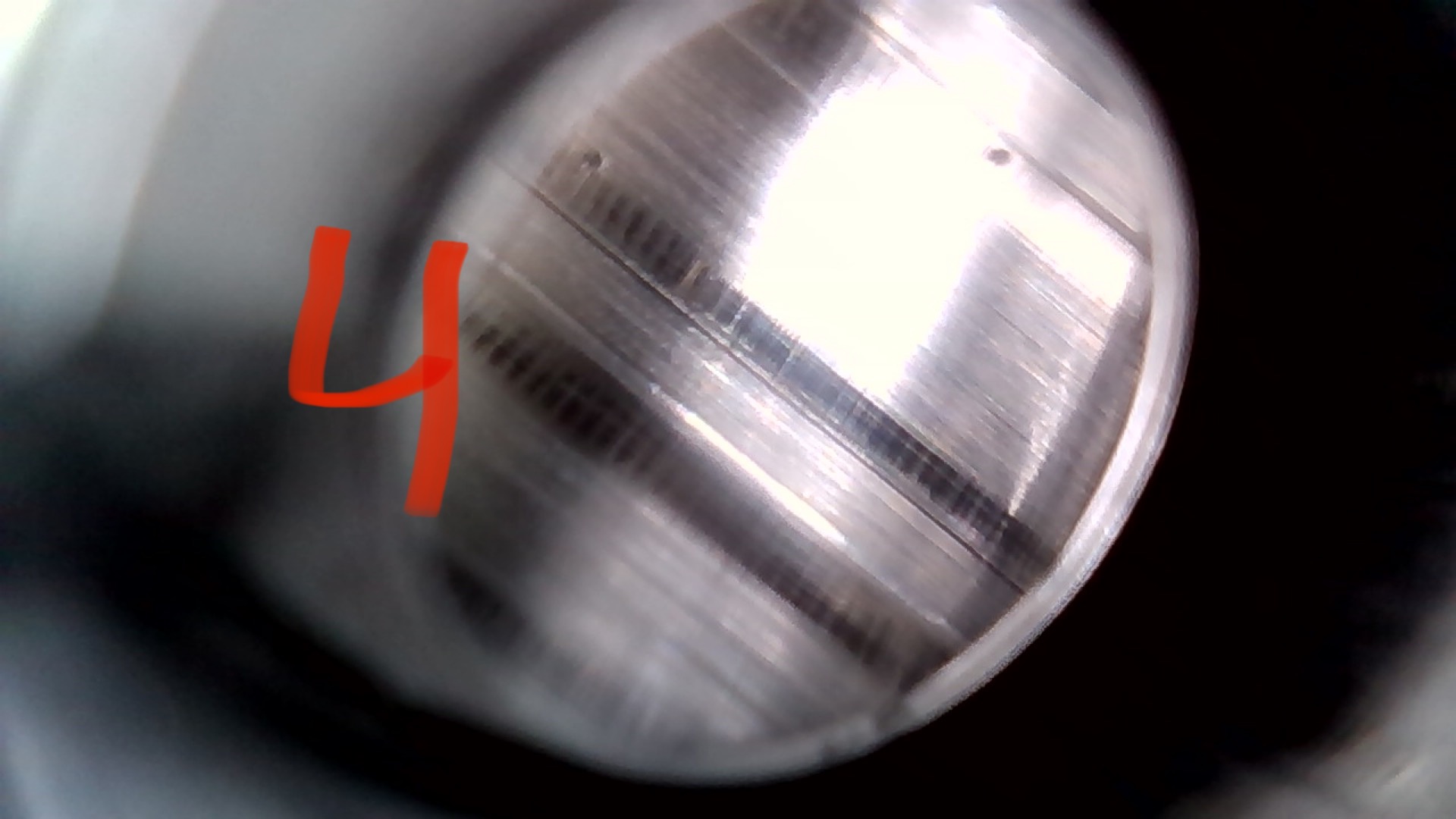

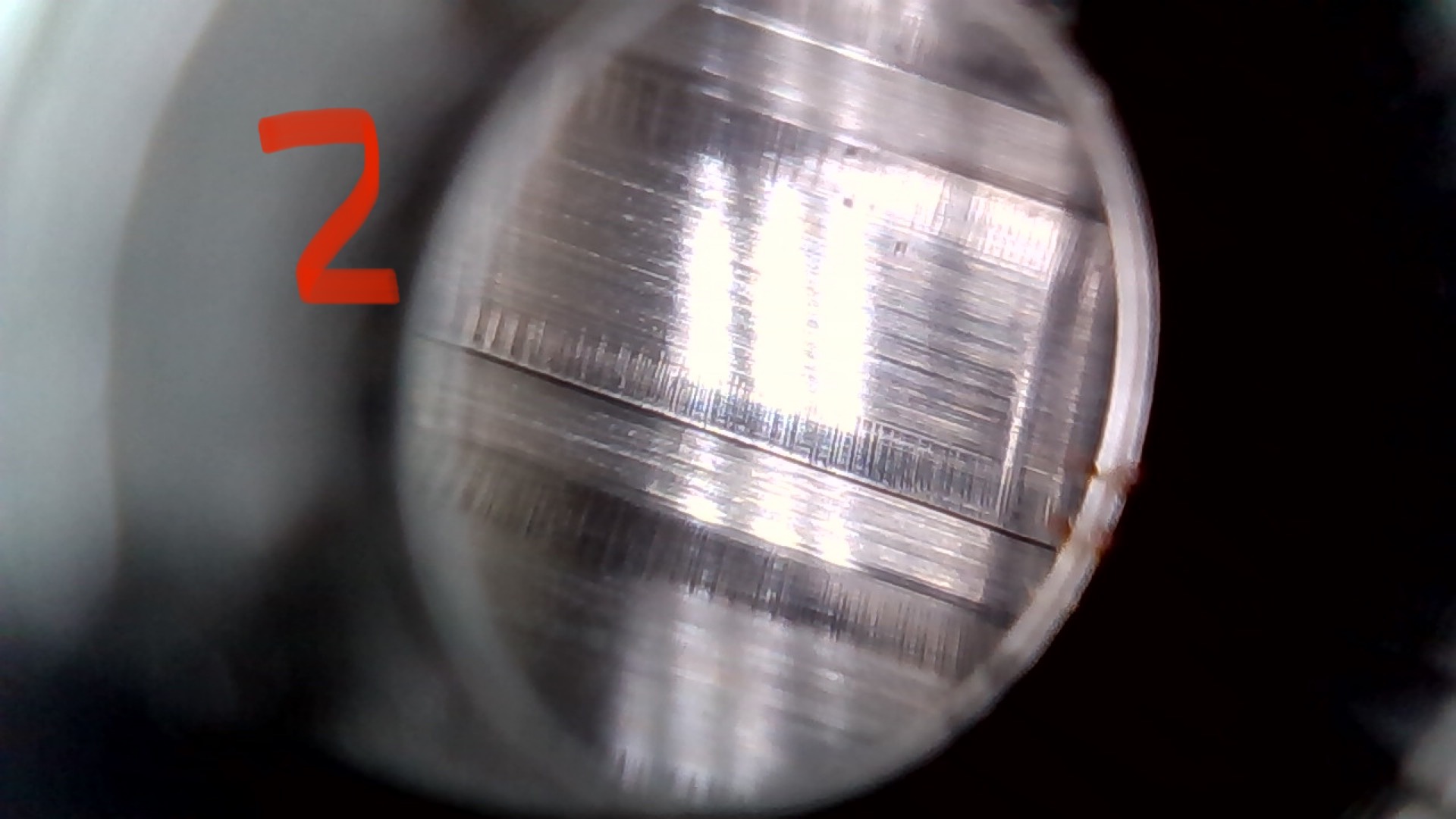

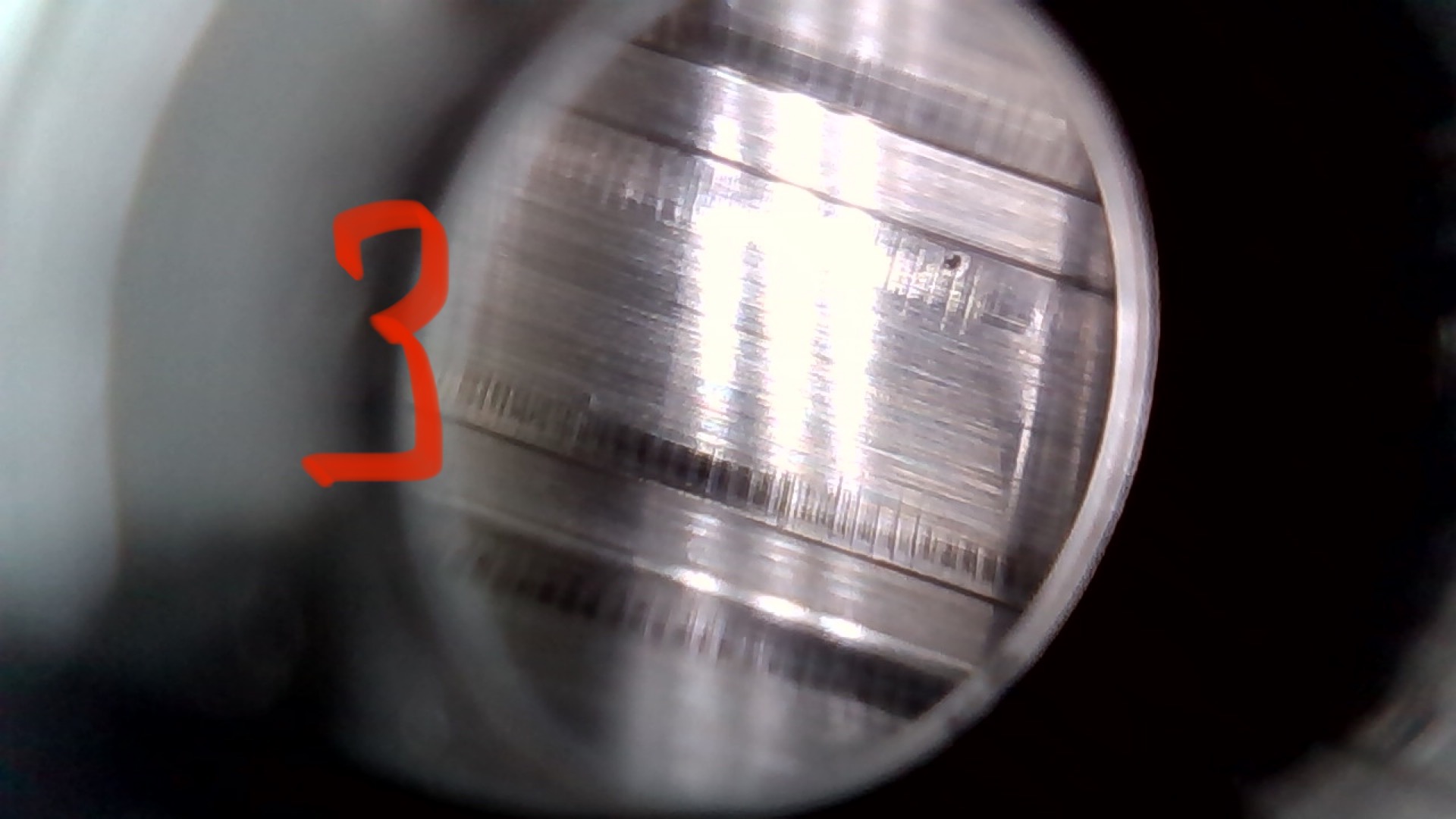

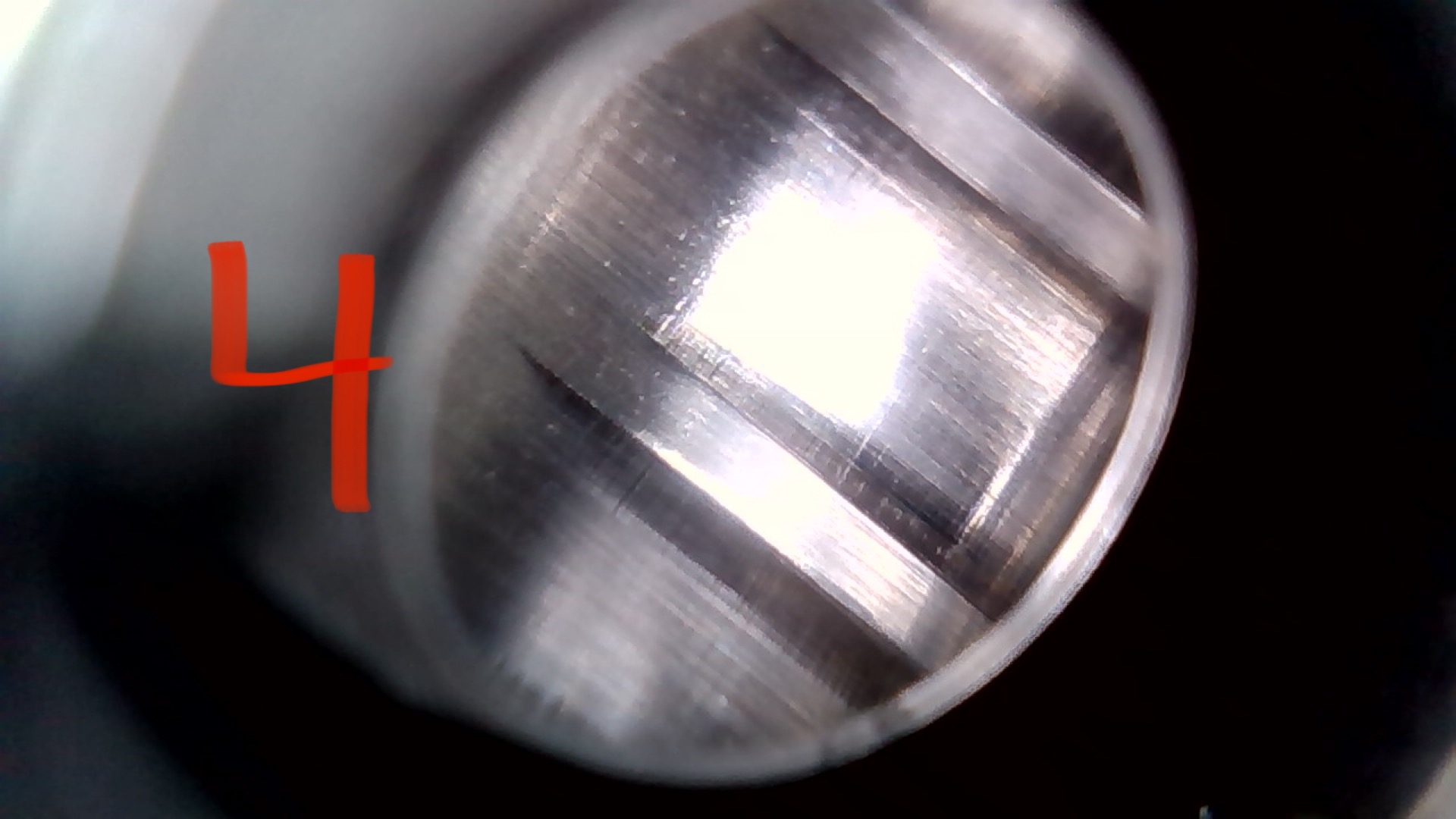

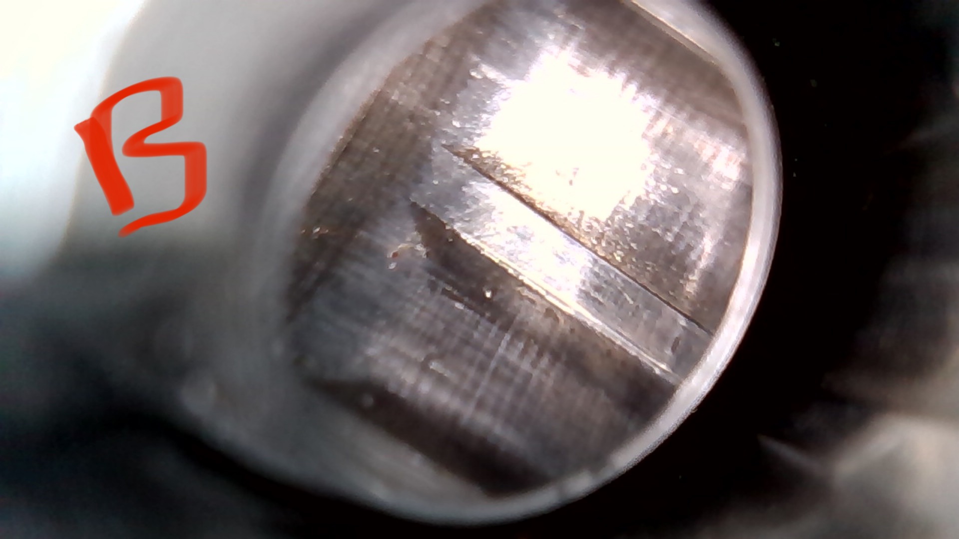

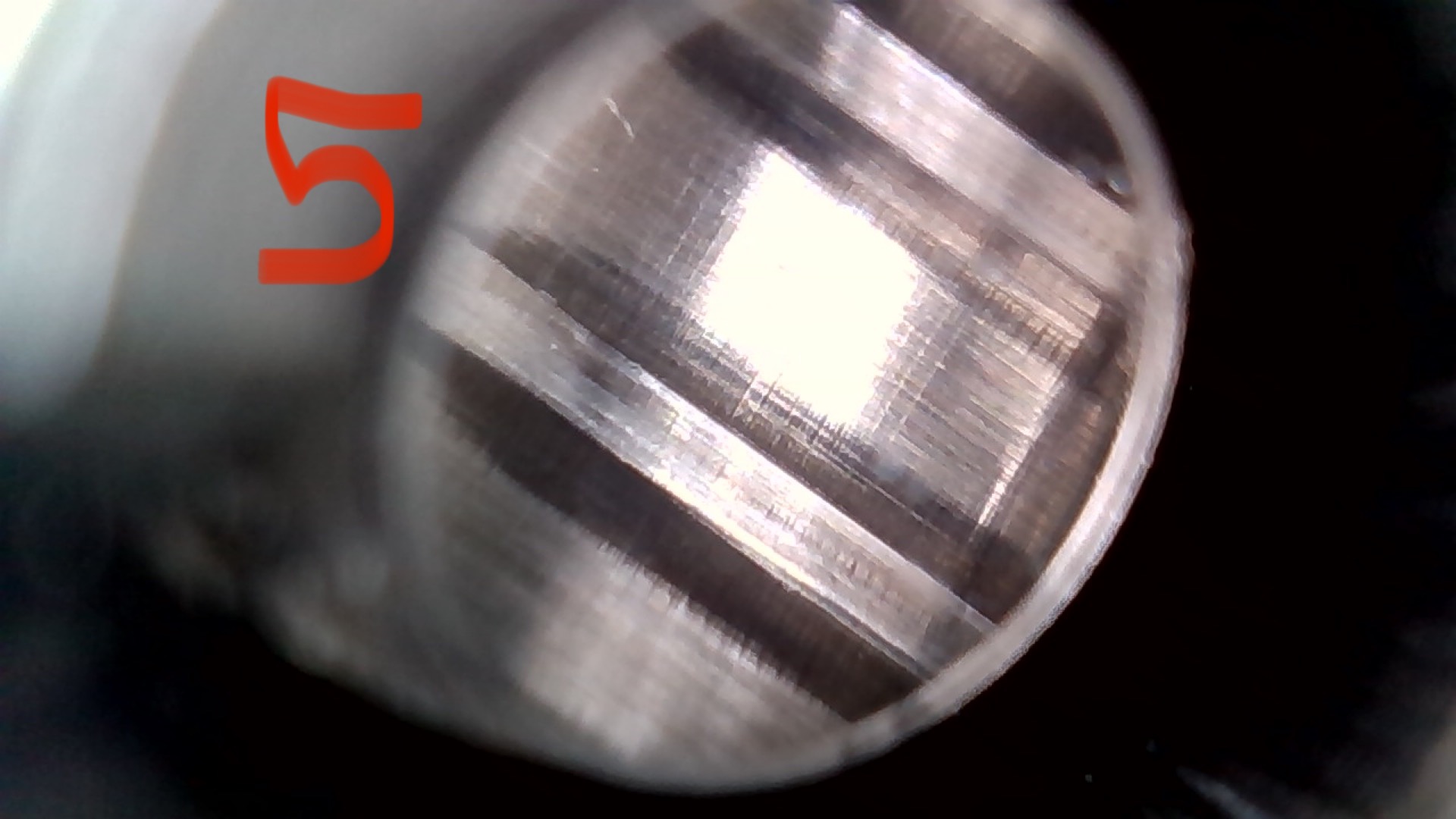

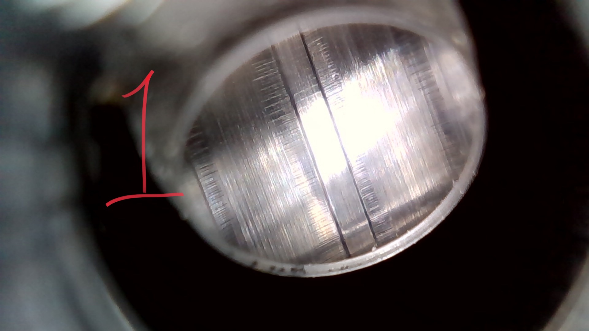

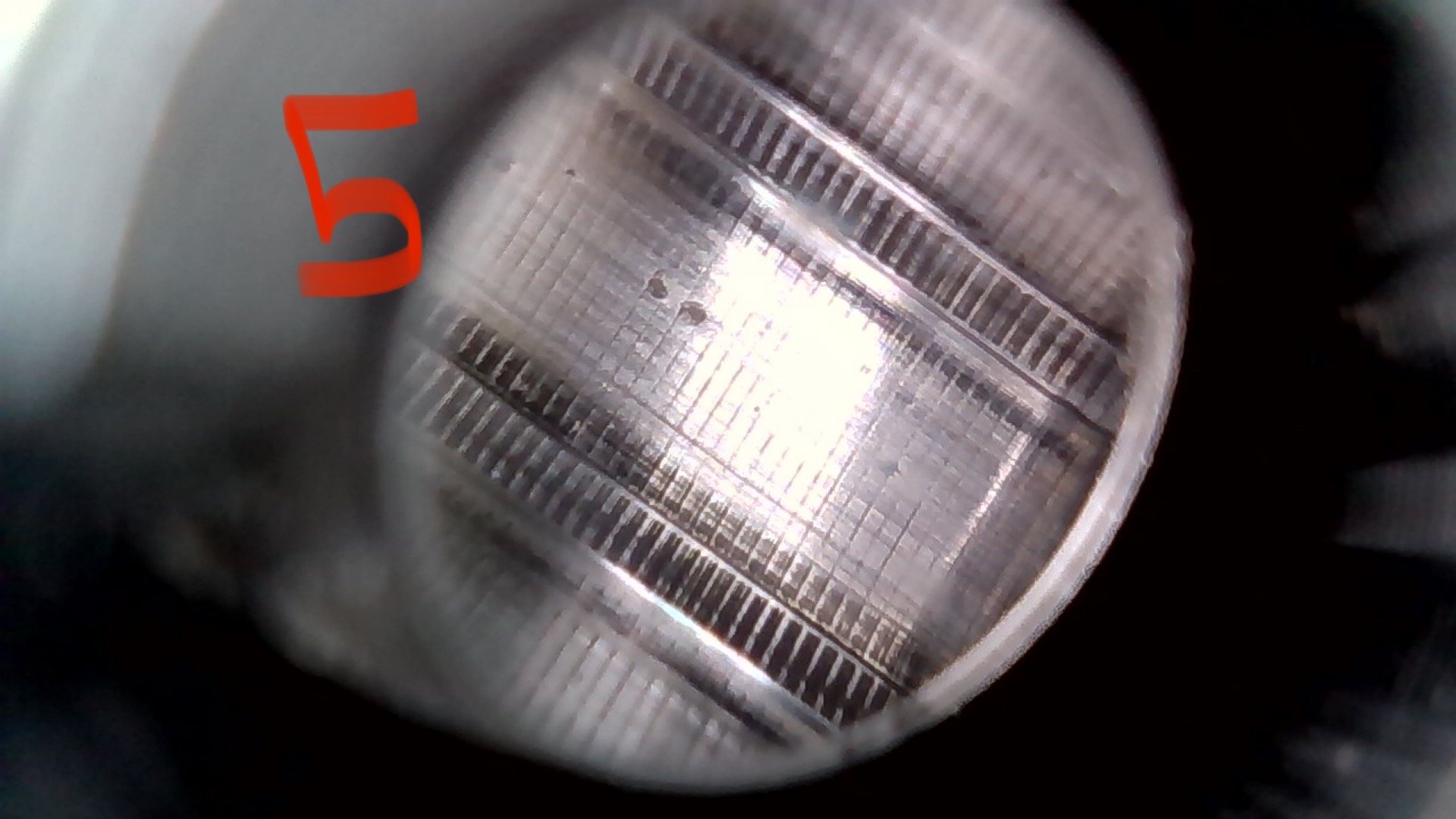

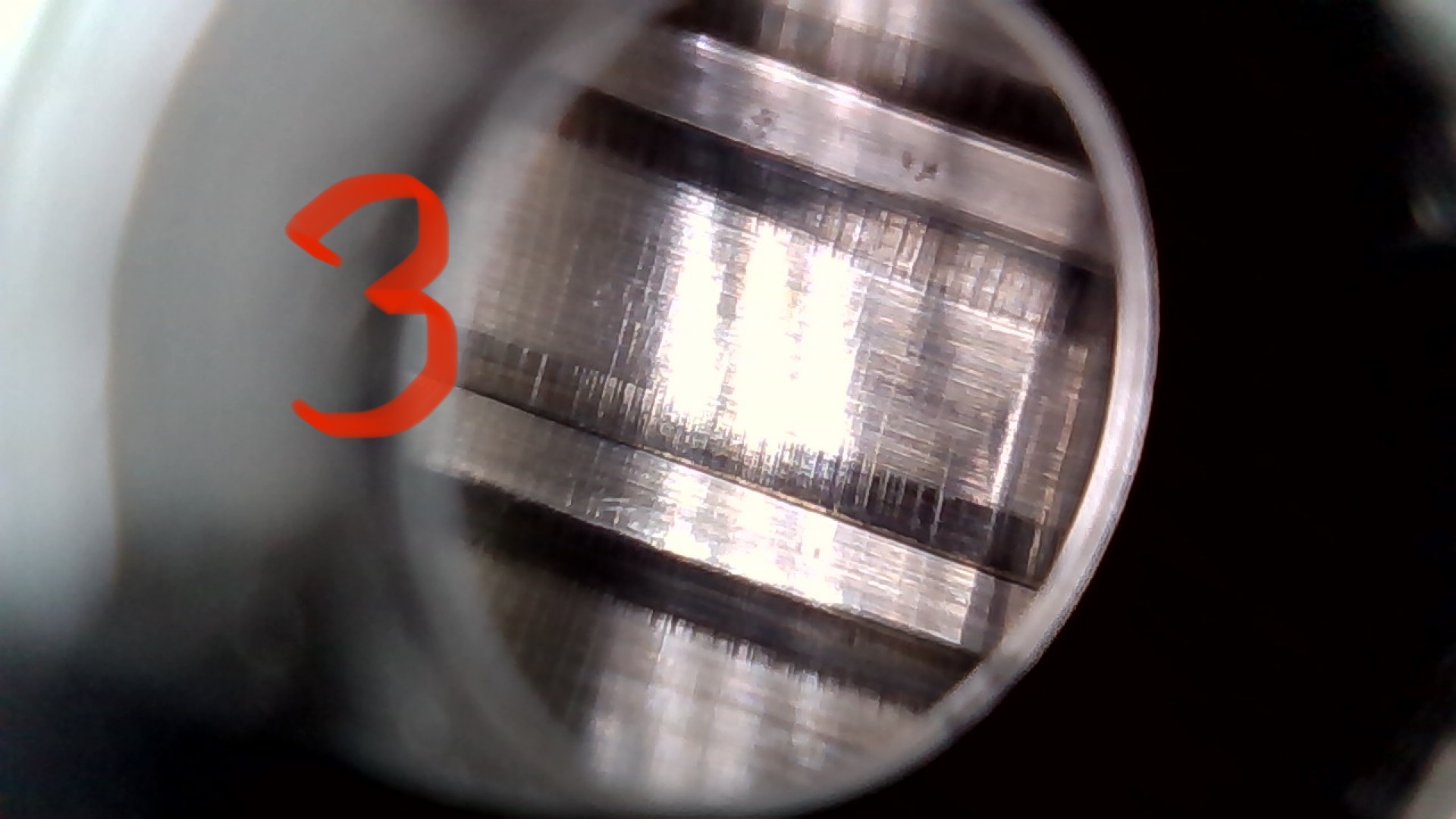

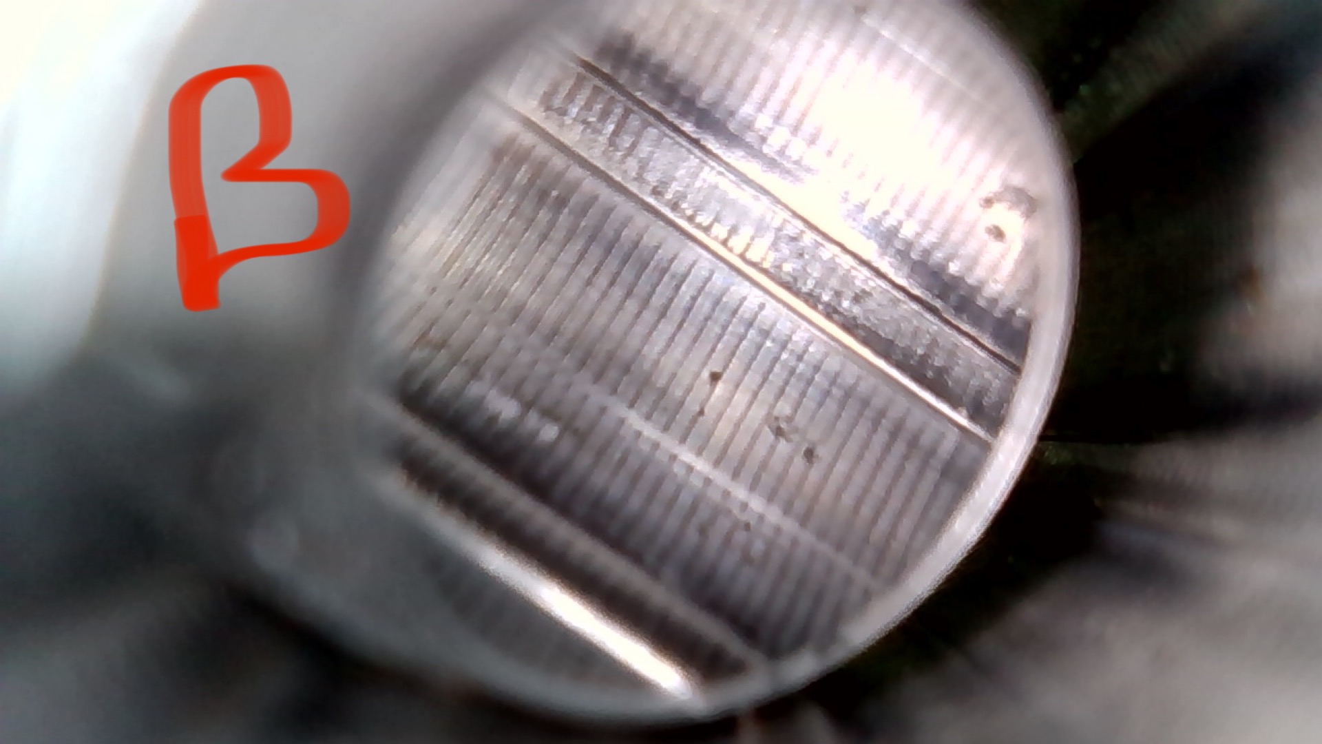

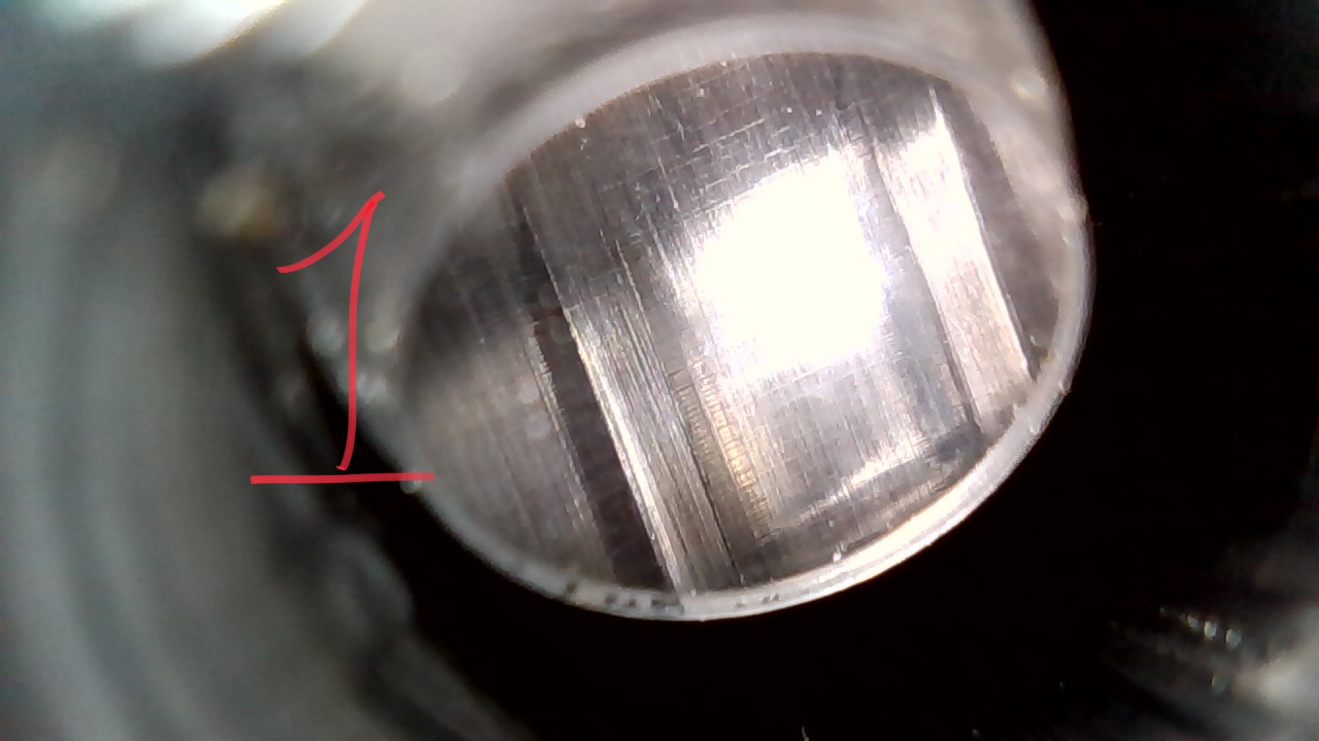

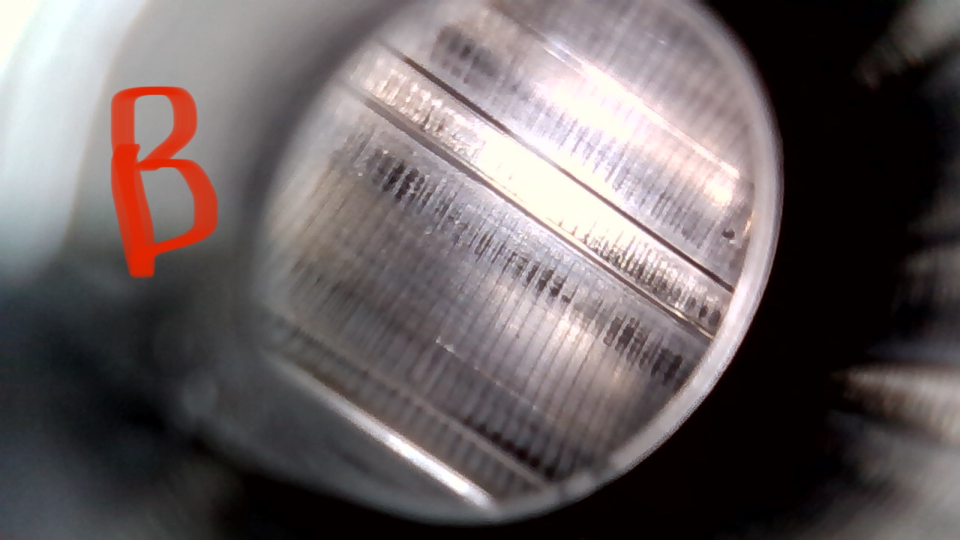

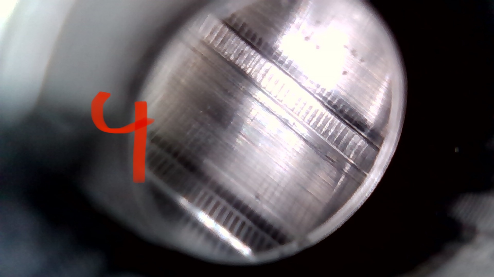

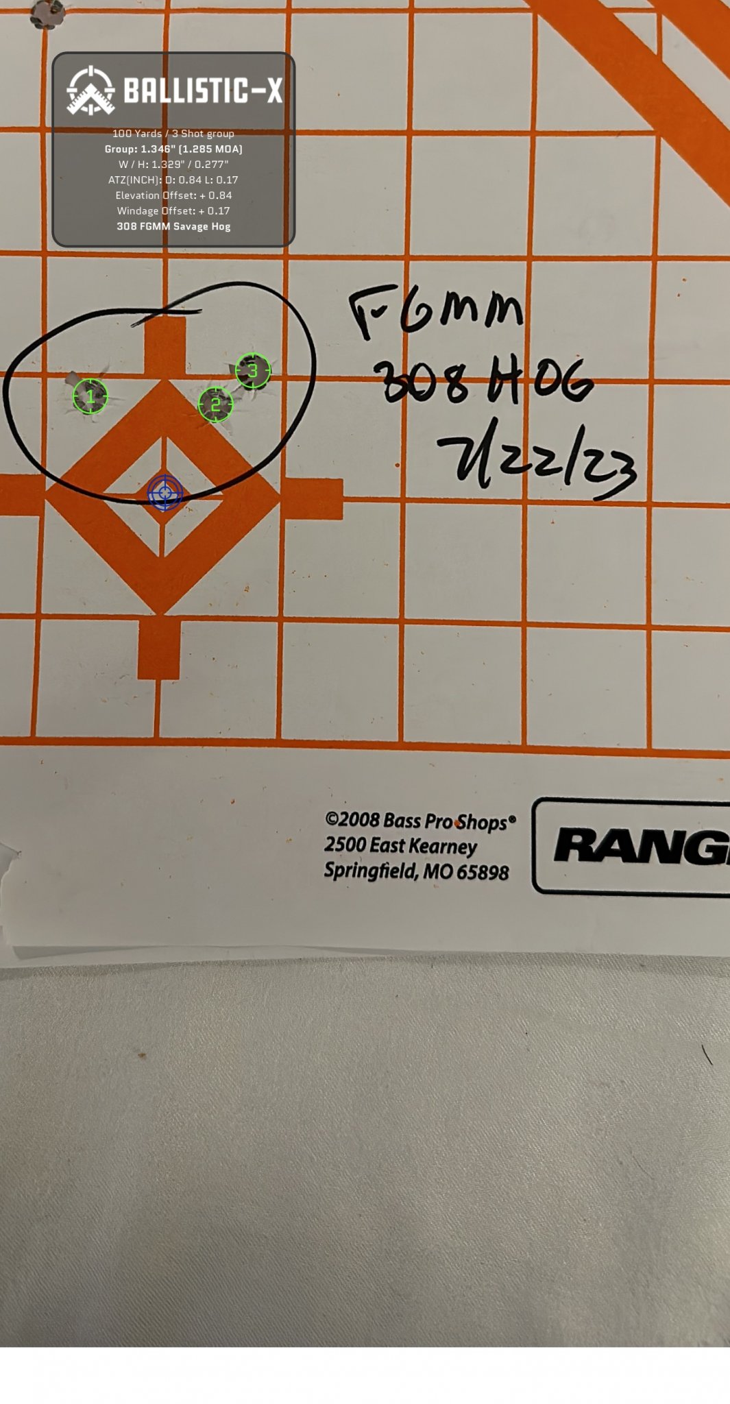

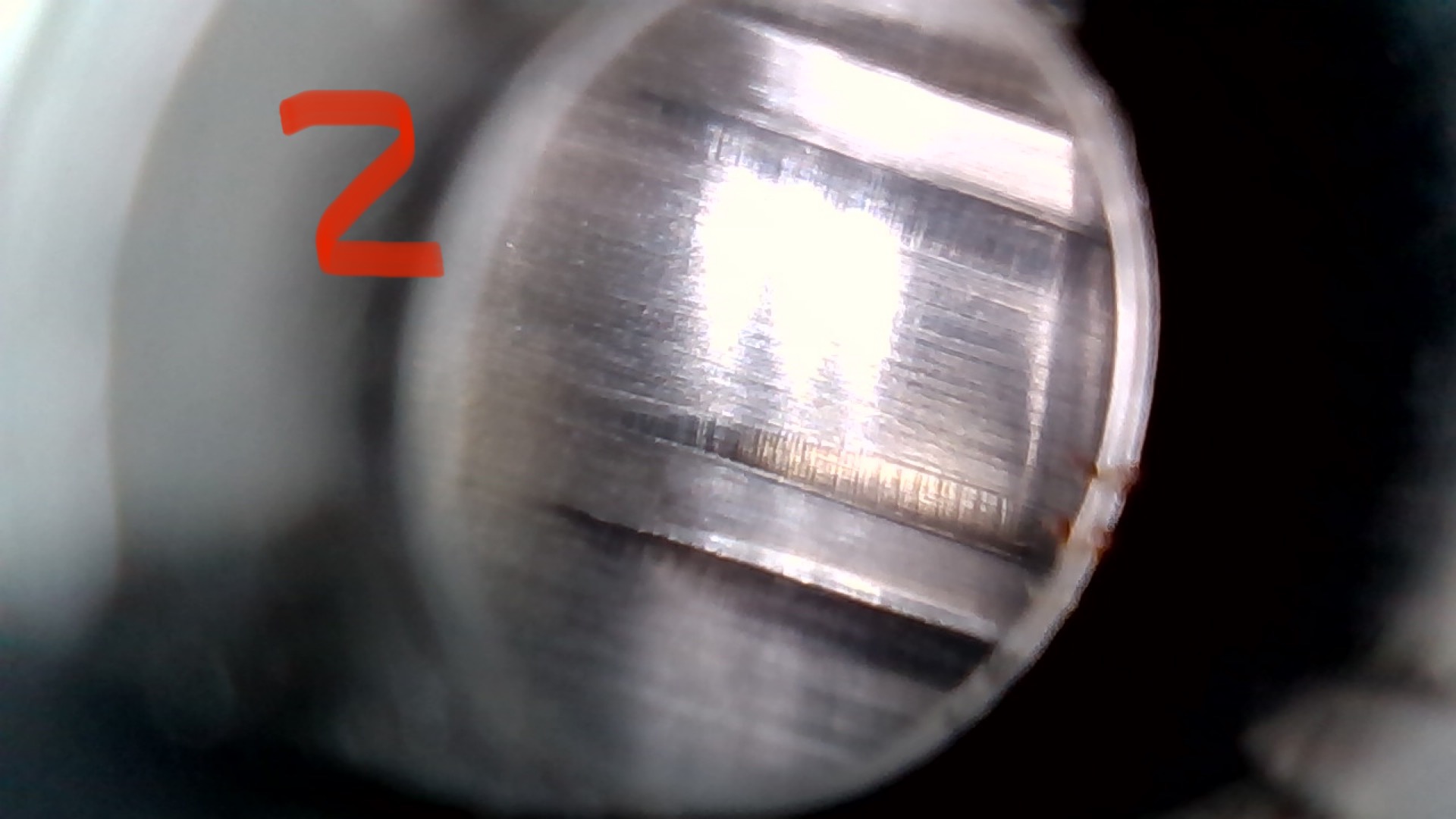

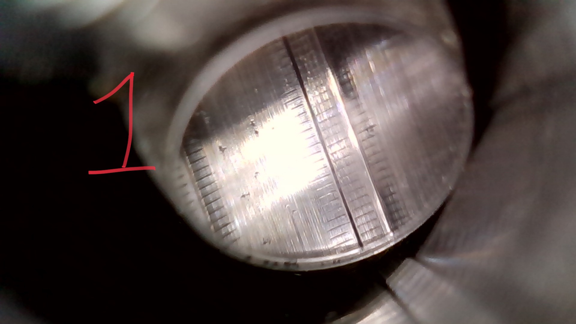

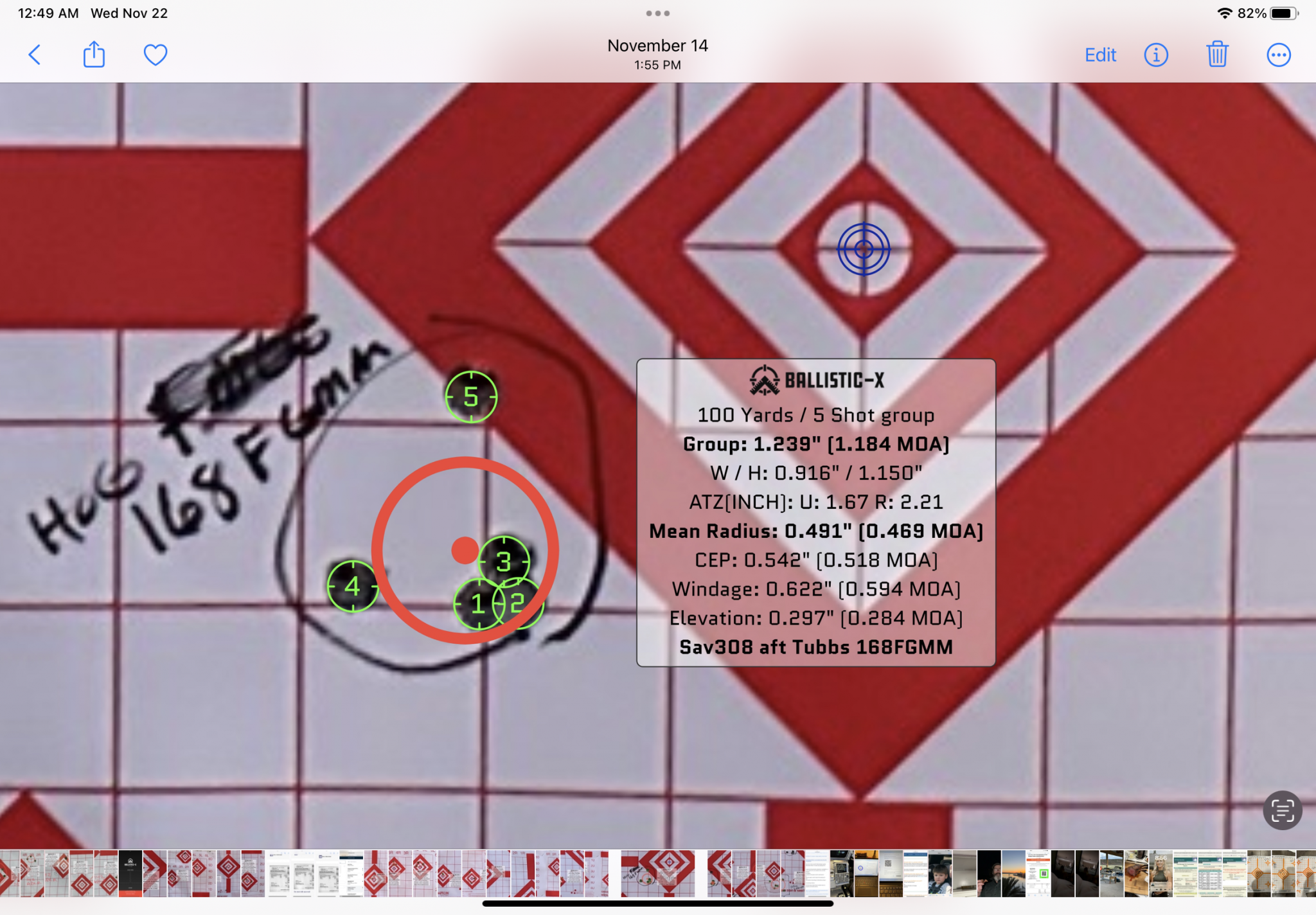

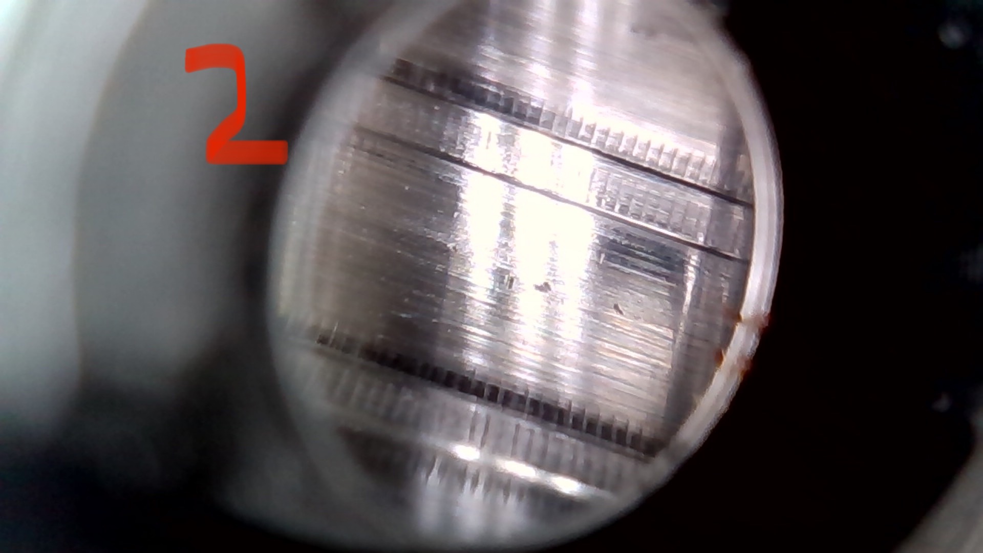

    I restocked tge gun in a Oryx Chassis, but it did not improve the groups. I had a Tubbs Final Finish kit sitting on the shelf and I figured, why not, what could it hurt? First I shot a group with FGMM 168, then I let the fun begin. I’ll post pictures of the three same spots as I progress through the five different grits. They are labeled counting down from 5.
    Ballistic-X-Export-2023-08-23 23:02:57.406183.jpg

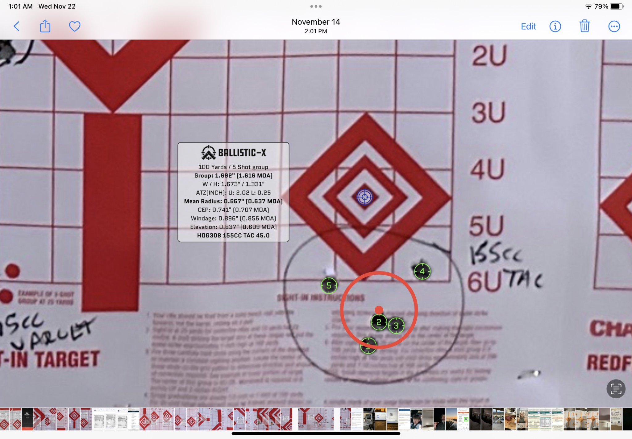

    The results. It shoots basically the same. I wish I would have shot a 5 shot group the first time, it likely would have been larger. Also, can you imagine if I had stopped at three shots on this target? I would have been singing Tubbs praises, but a five shot group tells all, or at least a little more. It cleans easier, but not even close to as easy as my PVA 6.5 barrel on my Origin. I’ll try some load development with some Nosler 155 and 175 Custom Competitions I have on hand with H4895 and maybe TAC, but I don’t have much hope. I’m seriously considering a X-Caliber barrel that’s on sale right now or maybe a Criterion from NSS. Or I could sell it off and buy a Tikka or a Solus from PVA……..decisions decisions.

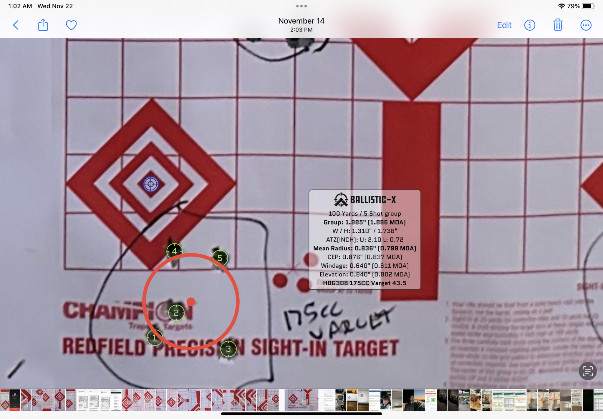

    Here’s a couple loads I threw together and ran through it without any development.
    155 CC with 45.0 TAC and F210M
    Next is a 175 CC 43.5 Varget F210M
    Yikes! What would you do? Should I waste more time trying to “develop” a load that will shoot, or re-barrel? Or sell it off on Gunbroker and start over?
    That's a normal savage barrel, and it looks pretty clean.
    Yeah, it was clean after 50+ patches of Boretech C4, then Eliminator, and I didn’t count how many with JB. Took over 1.5 hours.
    I’ve got a 1898 30-40 Krag that looks worse as well as a Ruger 77 7 Mag I bought in the early 80’s and they both shoot well and are easier to clean.
    I’m actually not concerned by the looks considering what I paid for it, but I would like it to be a better shooter and not take so long to clean up.

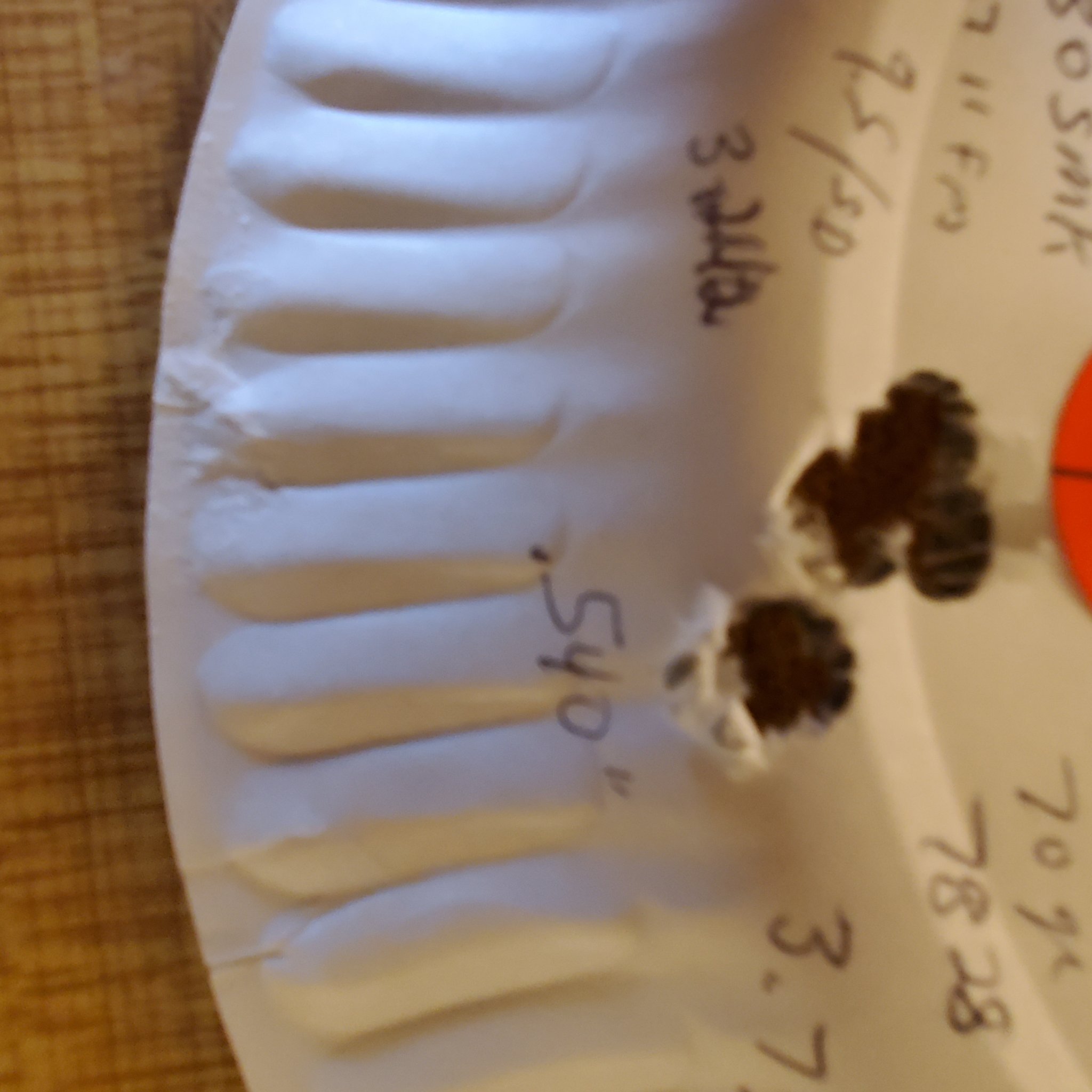

    I just purchased a 300 Win Mag Rem 700 ADL for its action,...but decided to shoot it first...scoped the barrel, it needed help, so I lapped it, then polished it, I put the action in an MDT stock, also threaded the barrel for a muzzle brake, installed a brake I had on hand.
    Used only one powder, old deteriorating lot of imr 7828, and a few match bullets, and mixed head stamp range brass. It shot pretty good for a $540 rifle, in an aluminum chassis, a hand lapped barrel, and added muzzle brake. Never broke it in, never cleaned it, during the range trip. Storm was coming in, fog and raining, I fired 5 shots as quick as the scope was on the 5 went into .6" this barrel gets hot after 3 shots, and I did not allow it to cool. Too hot to touch but still shot decent groups. The cartridge overall lengths ran 3.6" still fit the detachable mag but past book COAL..up next to the rifling.

    It looks like the final finish has smoothed out most of the bore without damage but the shape of the throat looks changed
    Good observation! It definitely changed. I need to go back and use my Hornady OAL tool and see how much it changed, I’m guessing I need to seat my bullets further out to get the same jump to the lands. That could make a difference in groups for sure.
