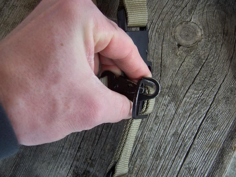

The sling I have has HK style hooks but it is my understanding the sling can be made with any hardware. The sling I have is used and one thing that concerned me was the gate on the HK style hooks had a bit of side to side travel. It did not hurt the operation of the sling but it did concern me as to the life expectancy of the hardware.

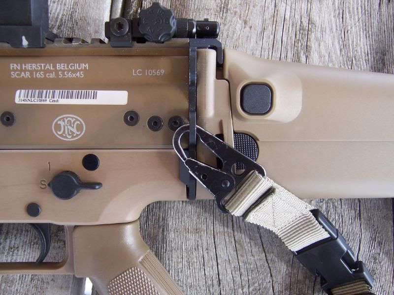

This is a picture of the front HK hook and a piece of machined aluminium hardware with a loop near the center of the sling. This piece of hardware allows the shooter to unhook from the front attachment of the rifle and hook onto the loop making the sling go from a two point to single point. All this can be done with the sling on the shooter and takes only seconds. The aluminum hardware is not soft, I tried to bend it on the tailgate of my truck and was unable to. I almost want to believe this is an alloy and not 100% aluminum.
My preferred method was to insert the hook into the loop and press the gate onto the loop. This allowed for a faster attachment and less need for good dexterity with gloves on or in cold weather.

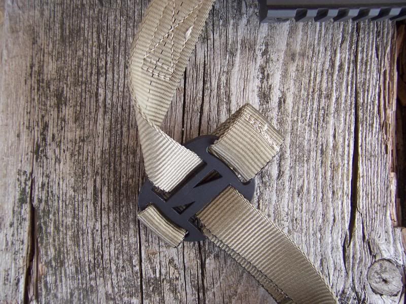

A few pictures of the hardware that allows the sling to adjust. The hardware is made of aluminum and is surprisingly stout. The nylon loop attached to the hardware is plenty big enough to grab with a few fingers and push or pull but I found it very natural to slip my thumb into the loop and push or pull to adjust. I had no problems finding the loop and never found myself searching for it.
Backside of the hardware.
