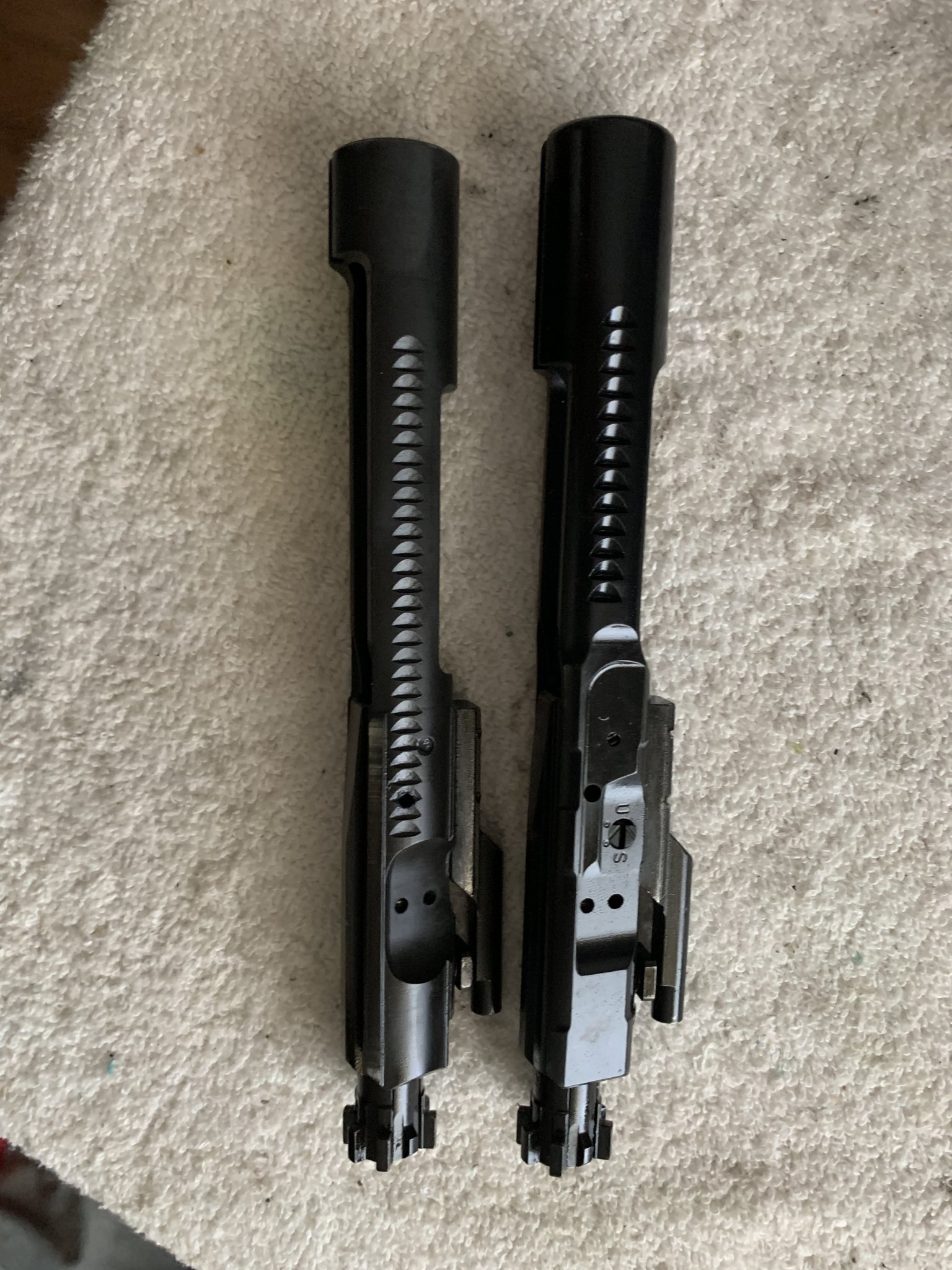

    Asking this as to see what your opinions are on my issue:
    Just FYI I stole the image from google as I did not have my phone handy to take a pic of my issue but it’s identical to this.
    10.5” PSA CHF Upper in 5.56
    Jamming as shown in the pic below. Tried different mags with same issues.
    Running a full auto BCG it would do this while ejecting Brass at 4oclock position.
    Switched to a AR15 bolt carrier and had no issues for about 30-35 rounds and 6 mags. However brass eject forward now at about the 2 o’clock position.
    Do you guys think I’m good to go with the AR15 bolt. Or is brass ejecting forward an issue. FYI the bolt failed to lock back on one mag when empty.
    Just looking for a place to start. I’ve seen lots of possible fixes but figured with using 2 bolts you guys may be able to narrow it down a bit.
    Thank you

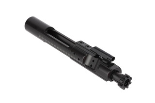

    Is one bcg heavier than the other? Could the weight, combined with recoil spring, be causing the jam due to cyclic speed?
    The bootleg is the FA bolt. Which is having the issue
    Other is a Bravo company I believe. Pulled from another upper
    I think I’ll pull the bolt head on the bravo and try on the bootleg. See what I end up with for results
    At least get weak ejector/extractor out of the mix

    I checked them but (and I know your not supposed to do this per say) with a piece of scotch tape on a .223 gauge. I do not have a field gauge. But probably should invest in one....
    If I read right, this is a classic type-3, not a true double feed: failure to extract the previous, then both that brass and a new live round try to both get back in the chamber.
    Start with extractor cycle stuff:
    • Does it eject well, and consistently, when not causing stoppages?
    • Check for extractor damage, and make sure you have an o-ring around the extractor spring; it is possible to loose the cartridge halfway out when springs or other things fail to work right.
    • Then, onward to springs and buffers, etc as above. Do a check that it locks back every time (get a pile of mags with 1 round loaded each).
    Ok,
    Ejection is consistent
    And I ripped both bolt heads apart an both are missing the orings... checked 2 other ones I have here and they both have them.
    So I robbed the extractor with oring off of the other gun and will be trying tonight. I have to do some work at camp. So I’ll try there before my neighbors start complaining
    So I will try:
    Same bolt head and bolt I just ran 10 rounds with. With new extractor installed. I’ll run a box of 50 through with the mag I used when having issues and report back.
    Thank you by the way guys! Didn’t expect so much good feedback so quick.
    Will also try multiple mags with 1 round as suggested to

    *Update*
    Original problem:
    Ran 10 rounds in a 20 round mag with 3 fails. Prepared to run 3 rounds in 4 30 round mags to test the function. First 2 jammed up.
    Switched the bolt as stated above. 100% with no FTE/Feed etc. Just had 2 o’clock ejection
    Swapped bolt heads and ran original BCG that jammed up. 10 rounds out of same 20 round mag as before with no fails
    Checked the extractor for the Oring and as stated above both extractors were missing them. So I’m lucky I have some extra stuff to try. So I pulled an extractor from another BCG that had a Oring and installed in current BCG (bootleg)
    Off to camp with 6 mags and 60 rounds of same ammo used above.
    - Ran 6 mags in a row of 1 round a piece. 100% locked back every time
    Ran 3 rounds a piece through all 6 mags. Zero jams and locked back every time - 100%
    Loaded the 20 round mag up and did rapid fire. Enough to get a bit of smoke going. Zero fails ran 100%
    Went back and fired 1 round through each of the 6 mags. 100% lock back rate
    Loaded the remaining 16 rounds in a 30 round mag and let loose on my steel target. 100% with zero fails.
    60 rounds
    6 mags
    Zero Issues what so ever
    3-4 o’clock ejection
    Thank you everyone who made suggestions. Especially to shoobe01 as I think he nailed the issue. Now to find some orings for the other extractors!

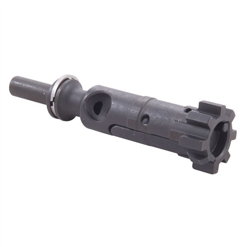

    When describing a problem and then the subsequent parts swapping you have to use the right names for things or it gets pretty hard to follow.
    This is a bolt:
    This is a bolt carrier:
    And together they make a bolt carrier group (bcg):
    You can change out a bolt or a carrier independently, but anytime you swap bcg's it means you changed out the whole unit.
    Reactions: shoobe01
    This is a bolt:
