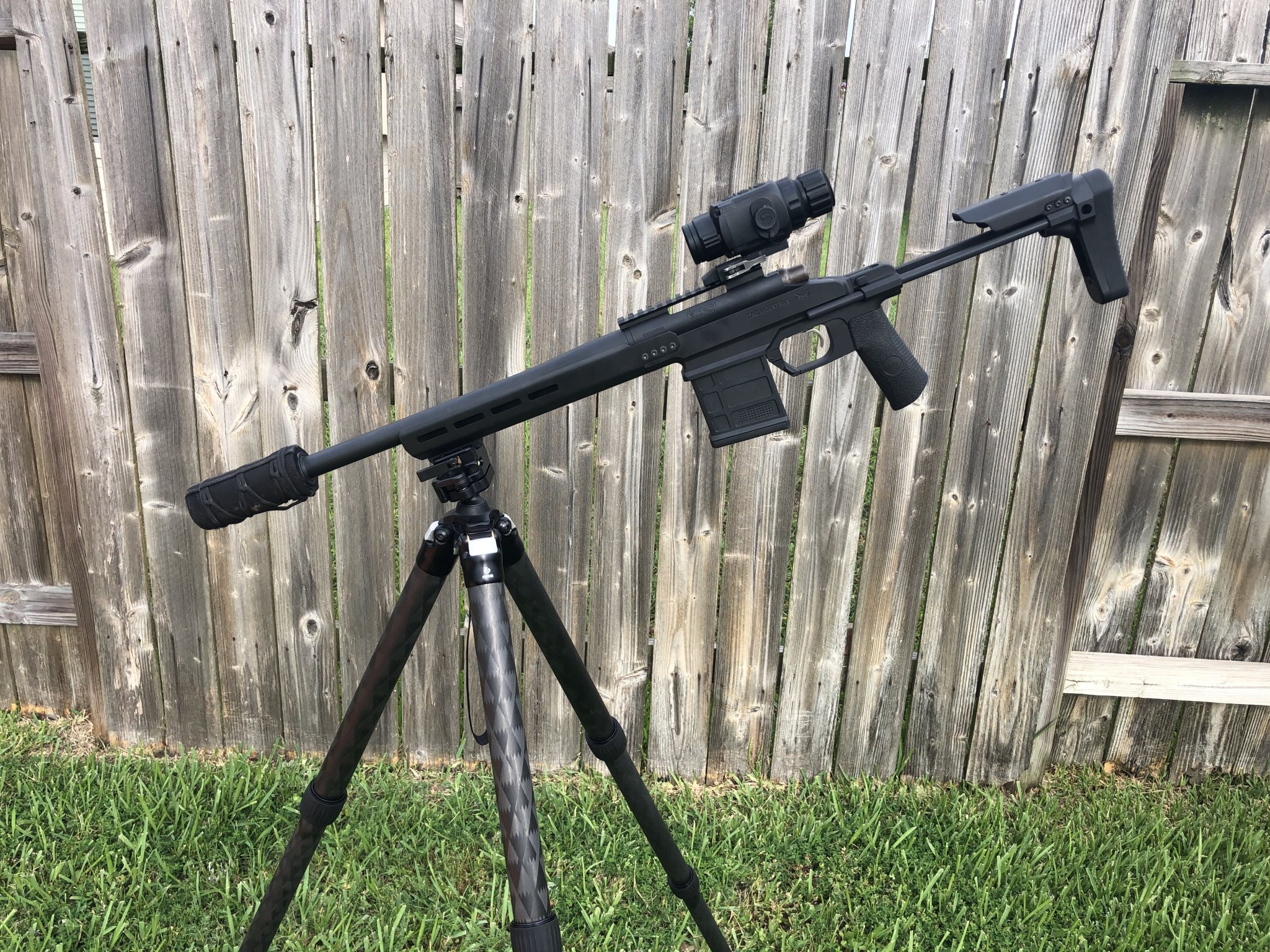

When I went down this same road, I ended up with a pinned 14.5” 308 in a chassis with a collapsible stock (JTAC Industries.) It was small enough to scratch the tiny rifle itch for me, and 308 in that barrel length is nothing an animal would laugh at. Here it is, with thermal.
That is really nice. How are you able to put a suppressor on a pinned barrel? Do you like shooting it? is it loud?
Pin the suppressor mount to attain 16” OAL for barrel. In this case, TBAC Ultra 5. It was great to shoot, and I killed a lot of hogs with it. Really fast 110’s were murderous. The suppressor was just enough to make it not uncomfortable without hearing protection.
