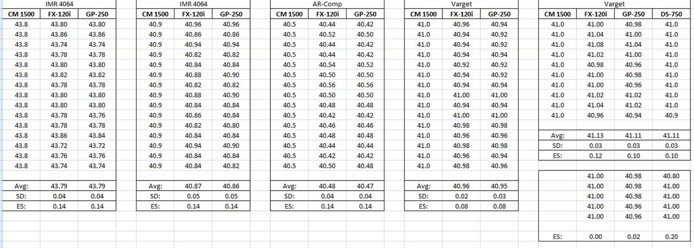

Before I purchased my FX-120i, I was getting pretty good results with a GemPro-250 (they're not made any more), but I was frustrated with effort it took to keep the zero from drifting to get consistent measurements. I did figure out a procedure to get the consistency I was after, but it added a lot of additional time for charging my cases. I decided to get the FX and it was way easier and faster to get my charging operation done. I mention this to give you some idea the kind of things you might want to be looking at in order to make your decision what might be of value to you.
Below shows a comparison I did to see how the four scales I had compared, mainly how they compared to the ChargeMaster-1500 with some different powders. As you can see at the far right, my DS-750 compared quite well with the ChargeMaster. But given the FX is more accurate and more consistent, you can see how much difference there was in this test.

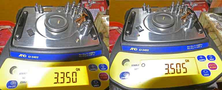

@Sparky308
I bought the EJ-54D2 on sale from Scalesgalore ($357 shipped). Price is now over $450.
It is a load cell type scale.
It has less range than many milligram scales, 52 grams in the high range. It also has a low range of 22 grams with an extra digit displayed (counts by 0.2 milligrams, or 0.005 grains).
Since it's there I use the low range with the extra resolution.

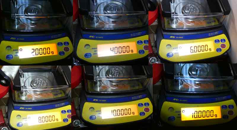

I have a range of "Good" mass standards and have checked linearity, full scale, and zero drift with autozero OFF.
With a 20 gram calibration on the low range I have a linearity error of one or two counts (-) @ low grams values (1-5 grams) and a (+) count at 3/4 range, 15 grams. My main loads are around 30 grains. I can pick the calibration value and at 10 grams calibration it is linear from 1 to 10 to within a count.
AandD Specs:
With a good zero full scale should be very stable with the temperature coefficient of the EJ series higher than the FX series,
20ppm/C vs 2ppm/C.
Repeatability spec (Std. Dev not Extreme Spread) is 1 mg for both the FX120 and the EJ-54D2 (0.4mg on the low range)
Linearity, error at lesser values is +/- 1mg with the FX120 and the EJ-54D2 high range (0.6mg on the low range).
Repeatability for the EJ-123 is 3mg, Linearity for the EJ-123 is +/- 3mg.
A "Good" check weight near your target load is a good idea to verify you are not in a high(er) error zone due to linearity error.
I would run your scale with autozero turned off (if possible) to see what is going on behind your back.
Then turn it on after you have troubleshot any stability issues. A pan should ALWAYS return to zero with autozero ON :).
