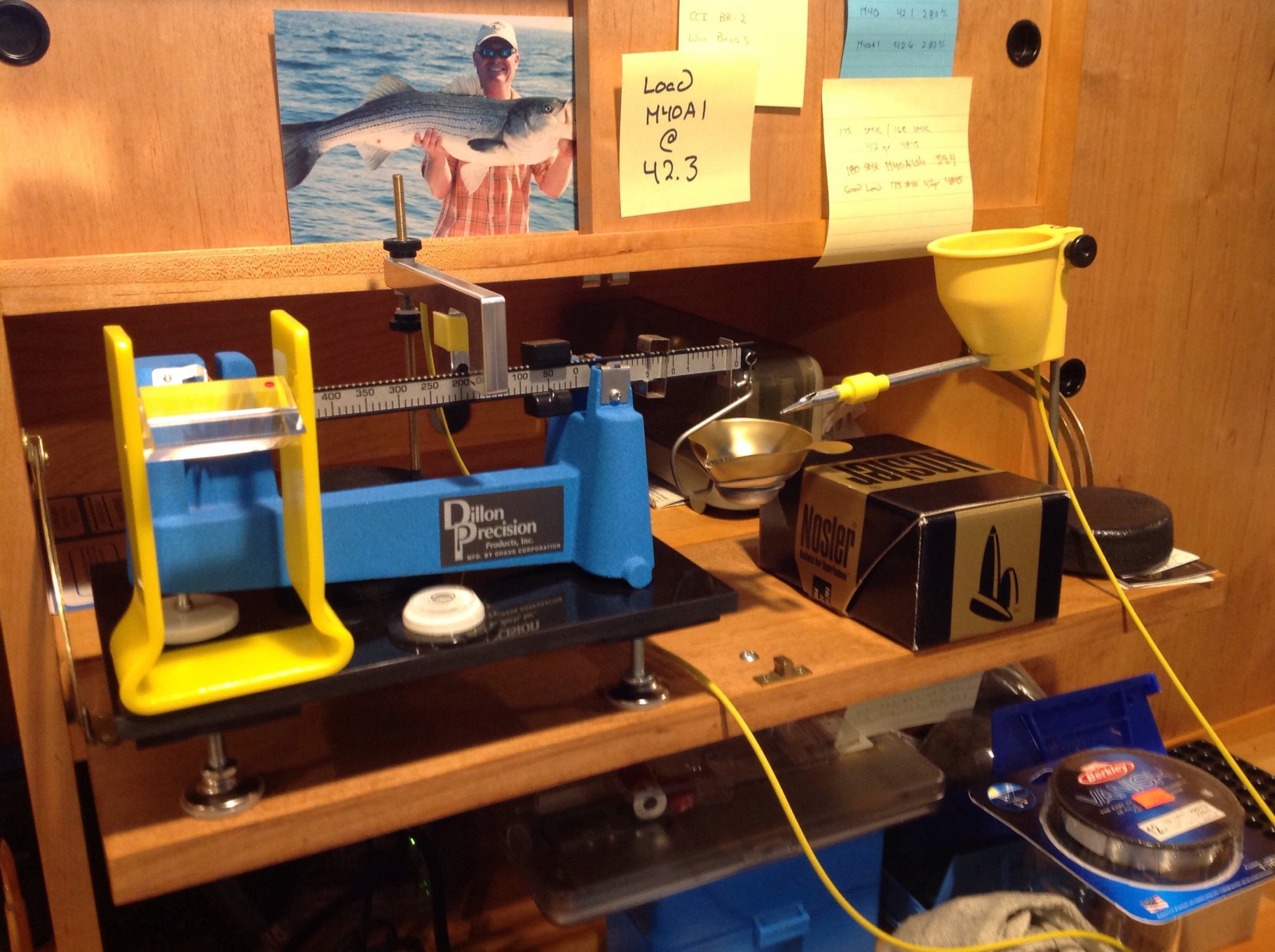

    Get a Dillon eliminator. It’s an Ohaus made 505. Get a little diamond stone and touch up the prisms, counting your strokes. I use a pair of 3x loops to keep an eye on mine as I sharpen them. I trust mine more than I trust my fx120i. It will weigh to the kernel as well. I have had the electric scale drift on me. Not the case with the balance beam. As long as gravity is the same today as it was yesterday, I can trust it.
    Been using a Dillion beam scale for better than 20 years. It replaced an equally accurate Lyman scale that I accidentally knocked off oft he shelf. When the Lyman hit the floor, it was toast. Keep checking the Dillon with scale weights. All’s good so far.
    Dillion works fine. But with all beam scales be wary of drafts or breezes hitting the scale. It won’t settle if wind is hitting it. That means no fans, and air conditioning vents directed elsewhere or shut off. Gets hot here in Louisiana, but a bad charge is even hotter.

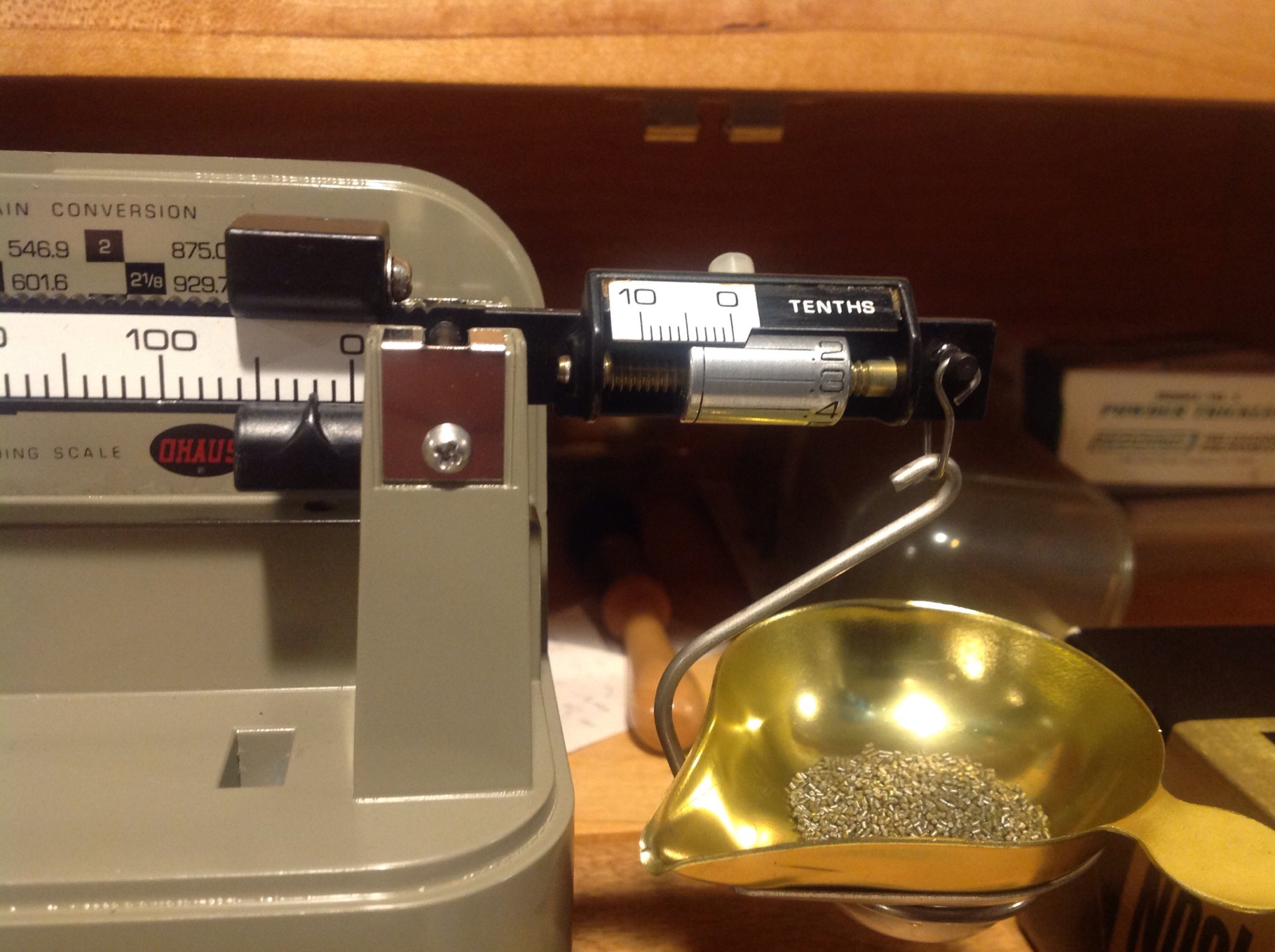

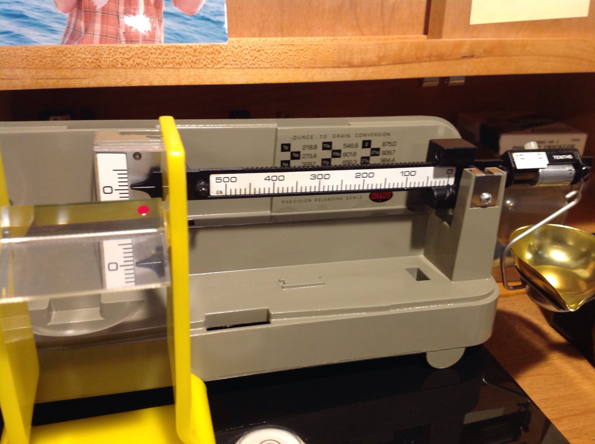

    I got this RCBS off Ebay......came in the original box, original directions, looks new....too lazy to go downstairs and check out its designation product wise....
    image-jpg.7771445
    image-jpg.7771446
    It is older than 30 years anyway and a fantastic beam scale. It closes up nice in its own little plastic cocoon to keep everything dust free. Made in the USA when we made shit in the USA.

    That's 1010. And a damn good one looks to me.

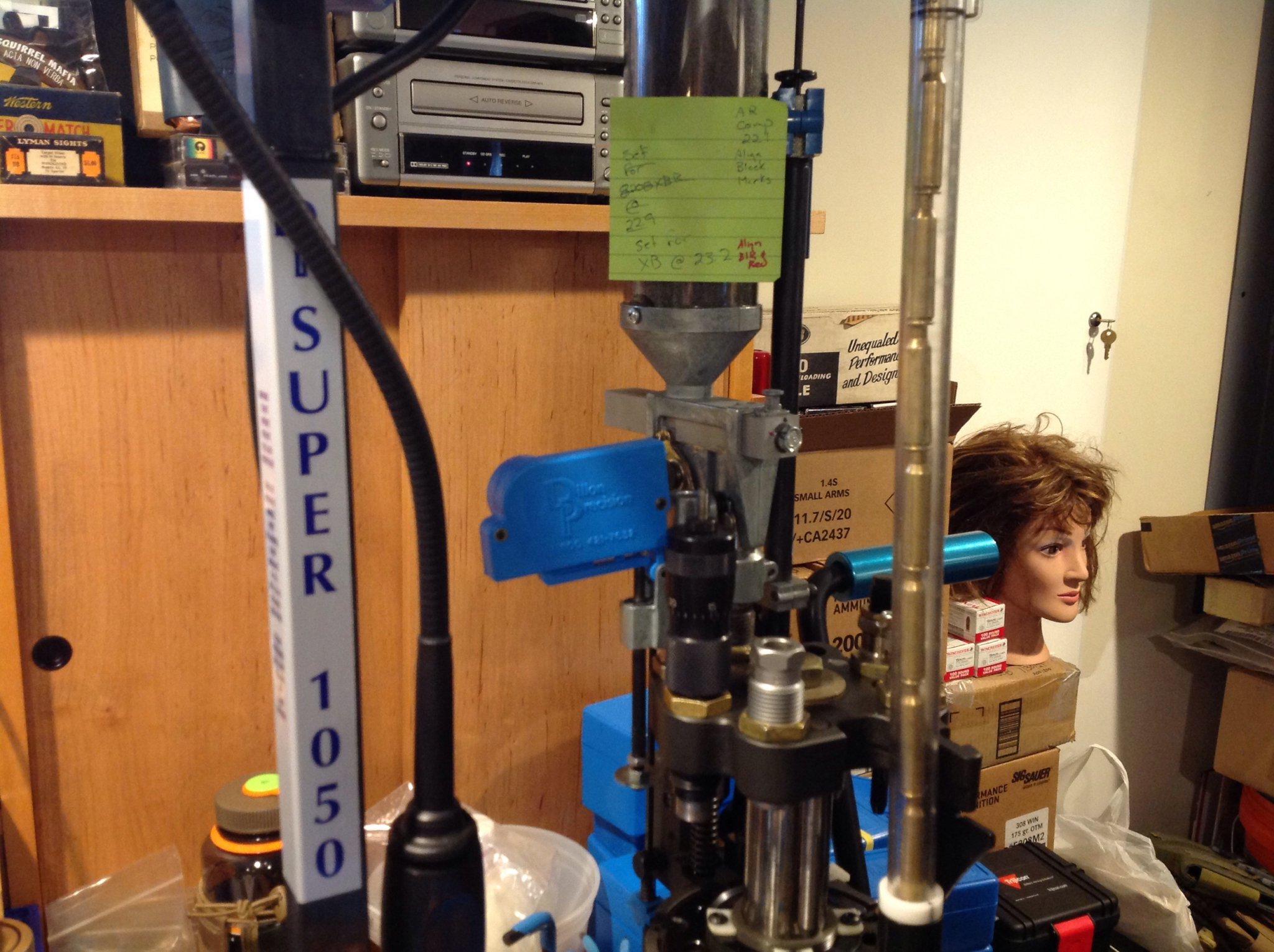

    I am currently loading with a powder that the Dillon is very consistent with. I check initial drop than do one or two QC checks as I pull the handle.
    When I load 4895/4064 logs I go to trickling each case.
    I cant use the RCBS pictured above because I trickle with the Dandy trickler and the electronic eye beam cut off. The design of the RCBS prevents using the Dandy Trickler so I resort to a Dillon....
    image-jpg.7678297
    Works absolutely fine for me, I am in no hurry when loading 30-06 and .308.
    The electronic eye beam is reasonably easy to dial in.
    I pull a powder charge from the Dillon just under my desired weight yet outside the error factor of the Dillon when dropping log powder. I set the eye beam to try and get exact but its usually a kernel or two under which I tease into the pan using the "jiggle" feature of the Dandy.
    Looks "Rube Goldberg" as fuck but works pretty good for me.

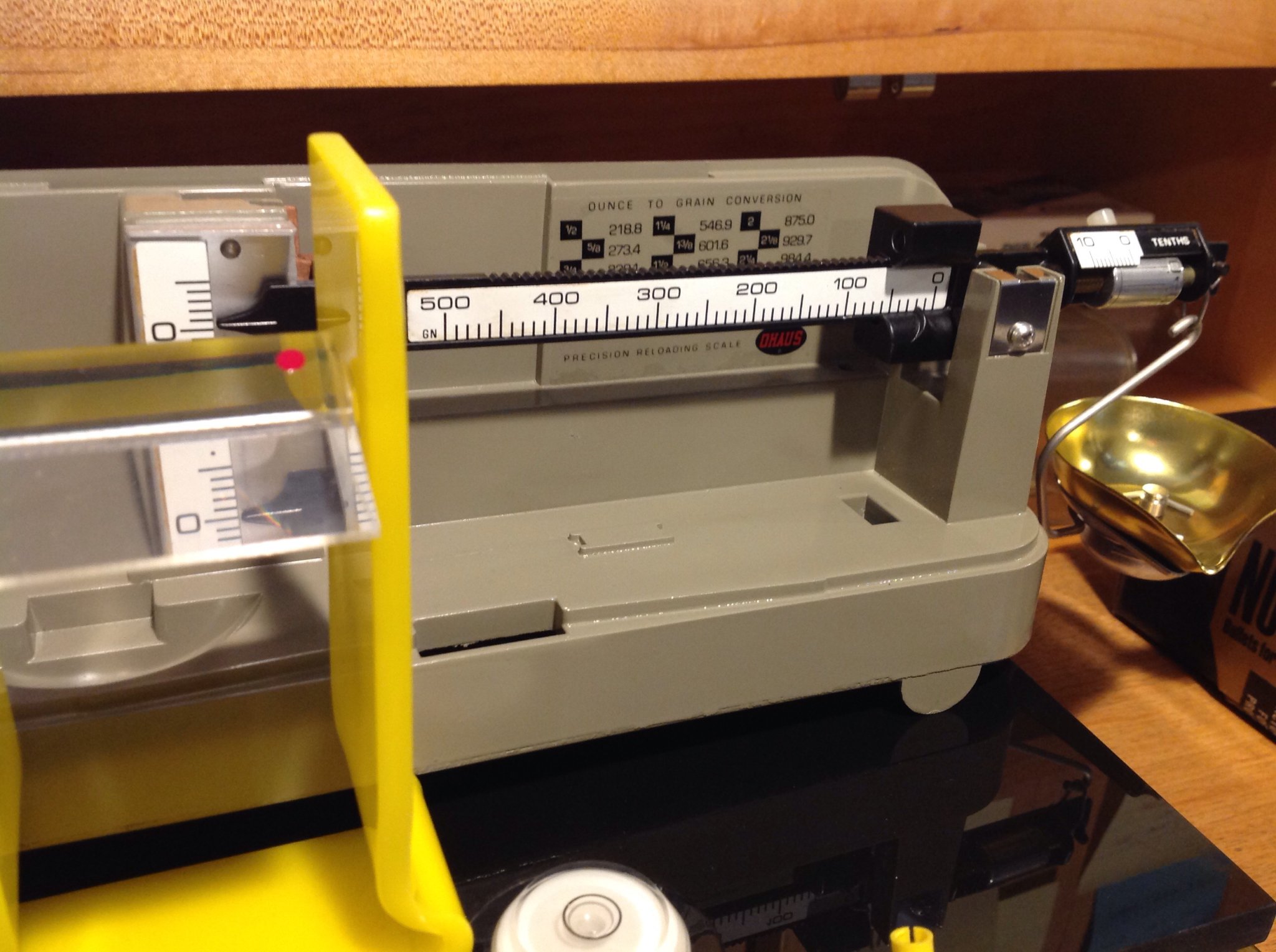

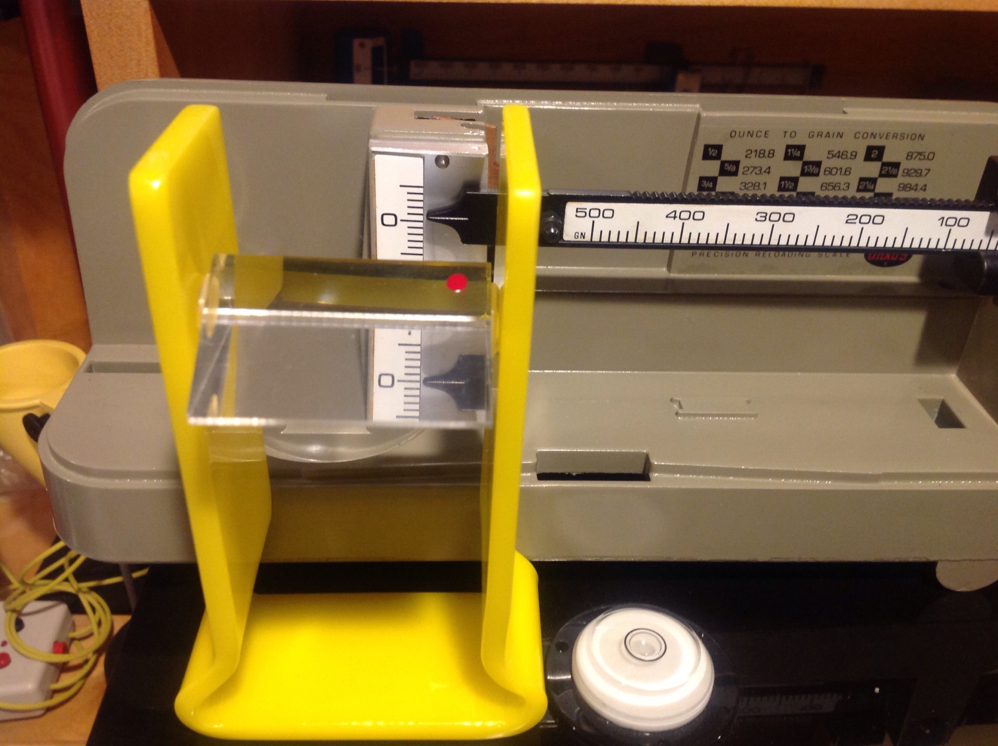

    Forgive my stupidity, I'm incredibly new to this, but what is that mirror thing called on the front end of the scale? Is it so you don't have to bend over to get the reading?
    Its a prism Dandy used to sell so you can eliminate some parallax error in reading the indicator because you twist it in the two mounts to set it in a way that is comfortable to view and thus repeatable.

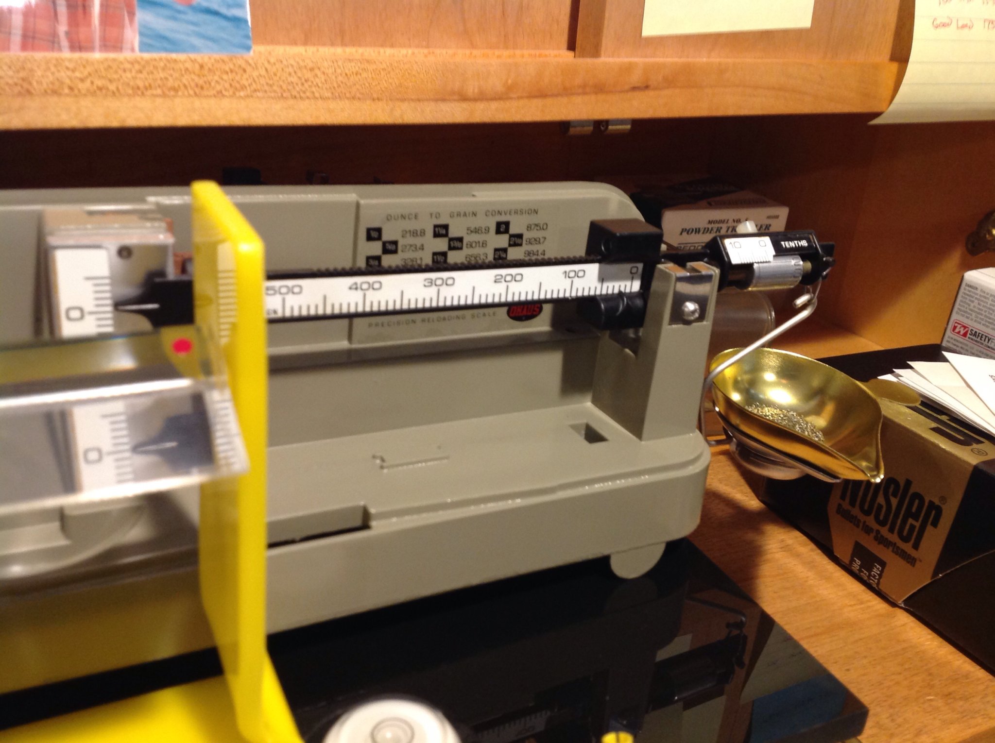

    If anyone ever asks "Whats parallax error?" this kind of shows it.......
    image-jpg.7771445
    Am I a half grain over or dead nuts?
    image-jpg.7771445

    A almost must have in my opinion is a 10-10, 5-0-5 and I believe Lyman had a similar model.
    I use other scales for speed and convenience but my 5-0-5 keeps them honest and help friends new to reloading.
