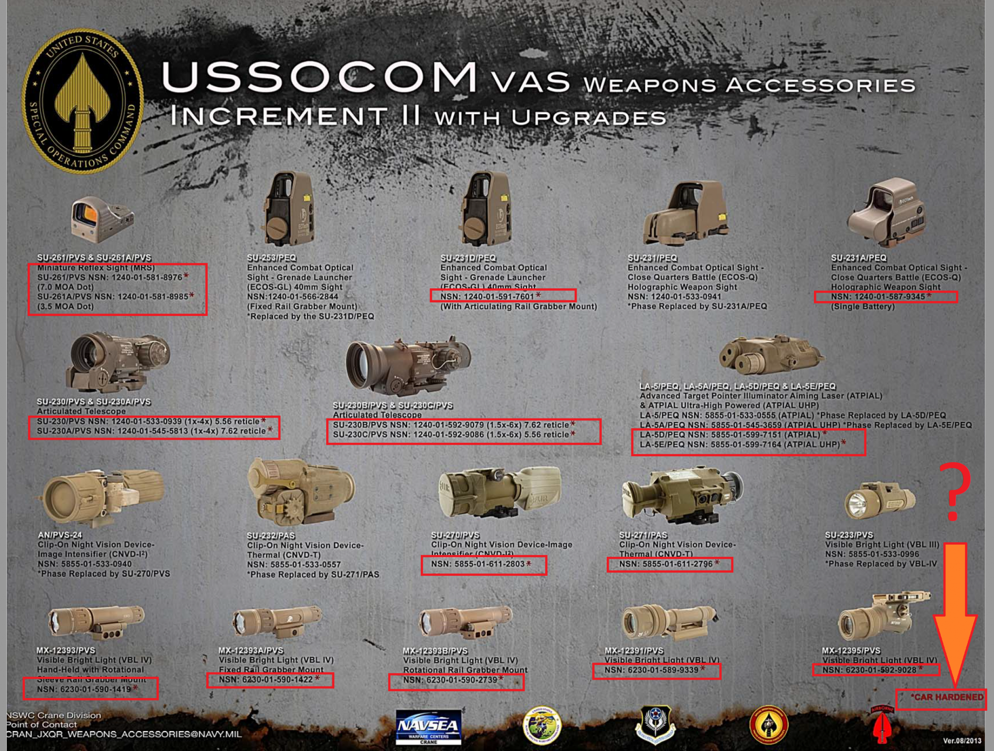

    My primary concern with the SCAR is using 118LR or any suppressor other than a SF SOCOM RC2. Not saying others don't work just fine. But I can't support what I can't verify.
    FYI these were the items that were hardened against constructive interference by NSWC Crane. Always a good bet with any of them on the commercial market. in addition and optic manufacturer that has won a DoD contract in the last 5-7 years will have an offering worth your money.
