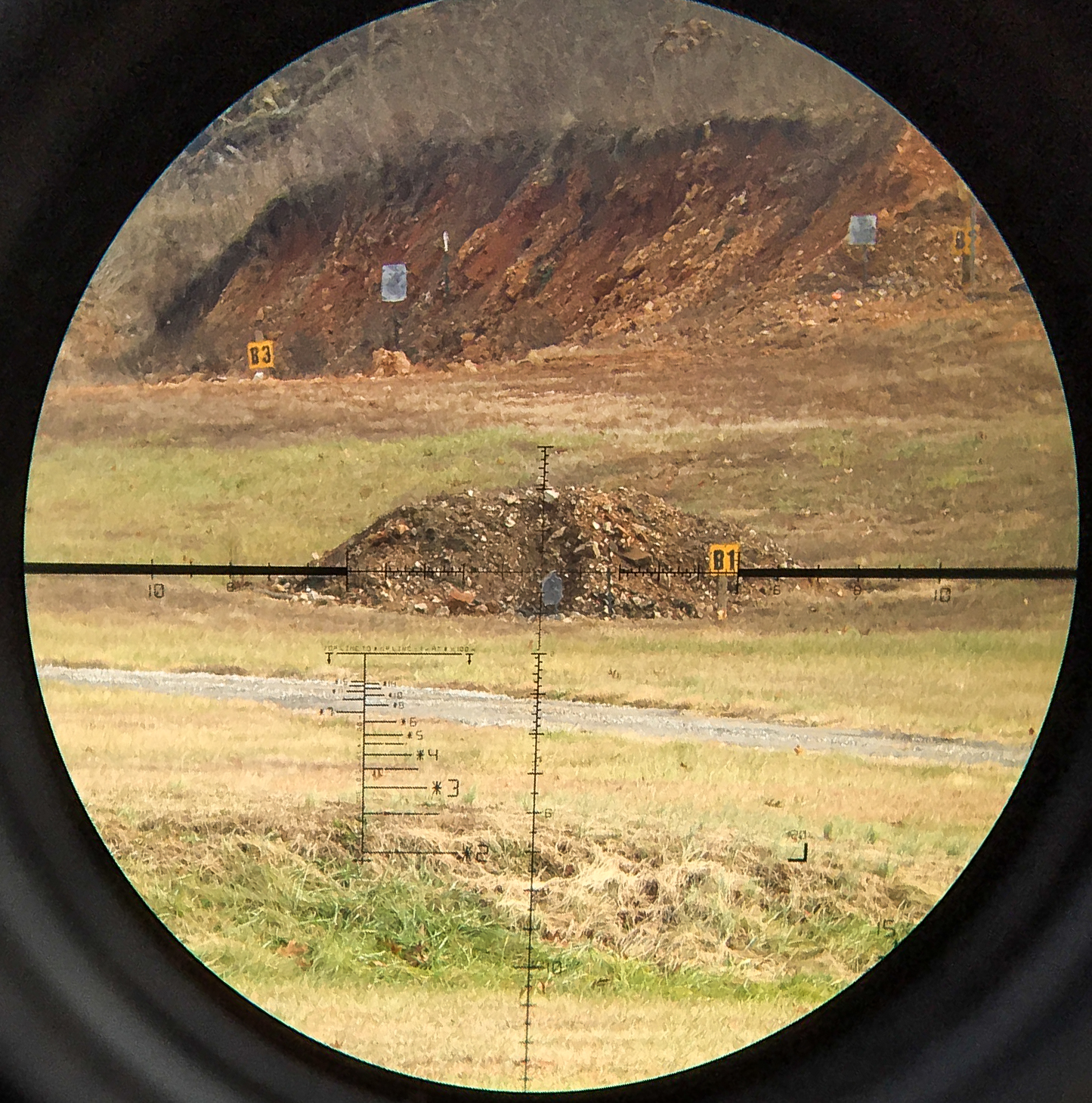

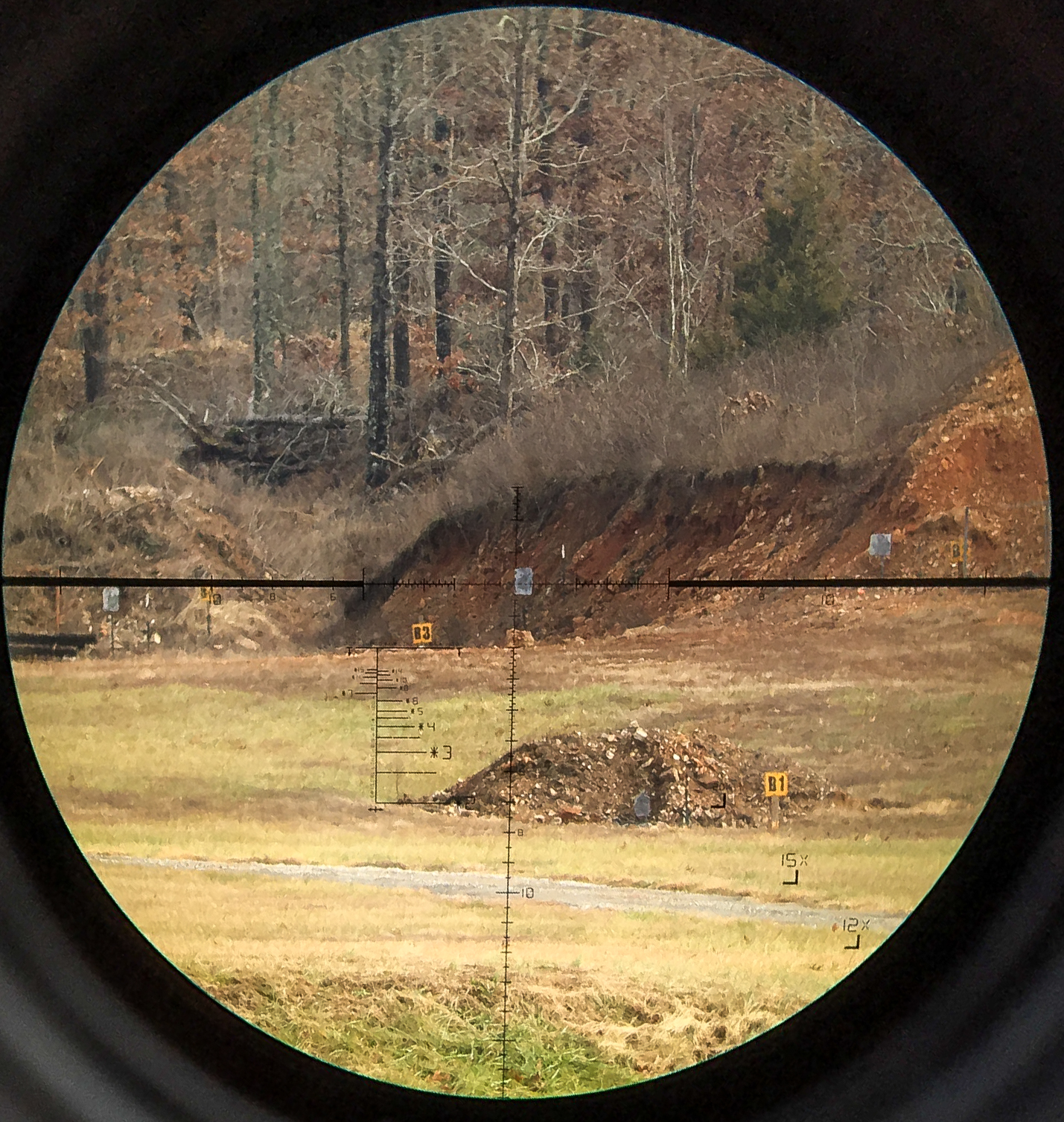

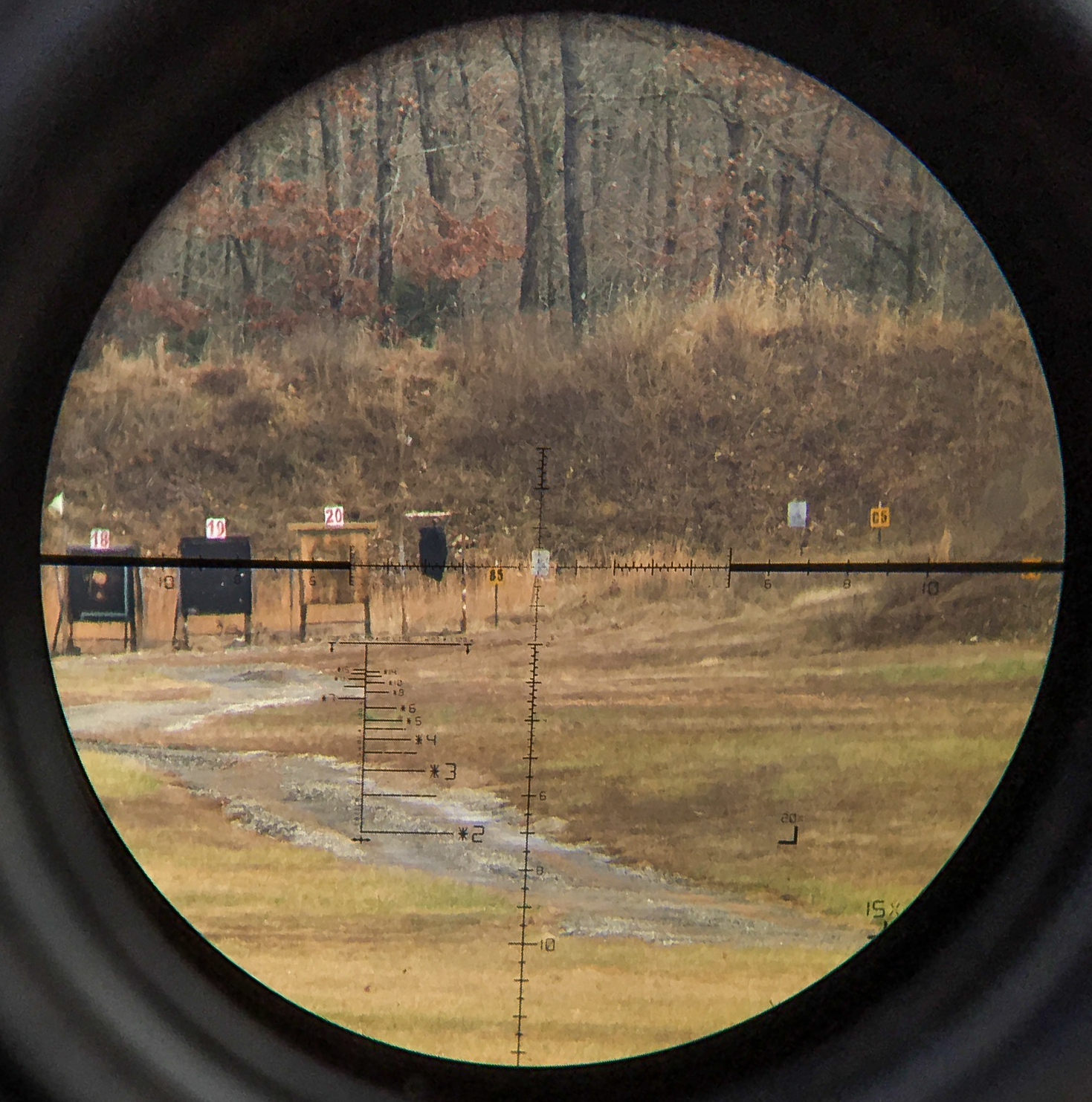

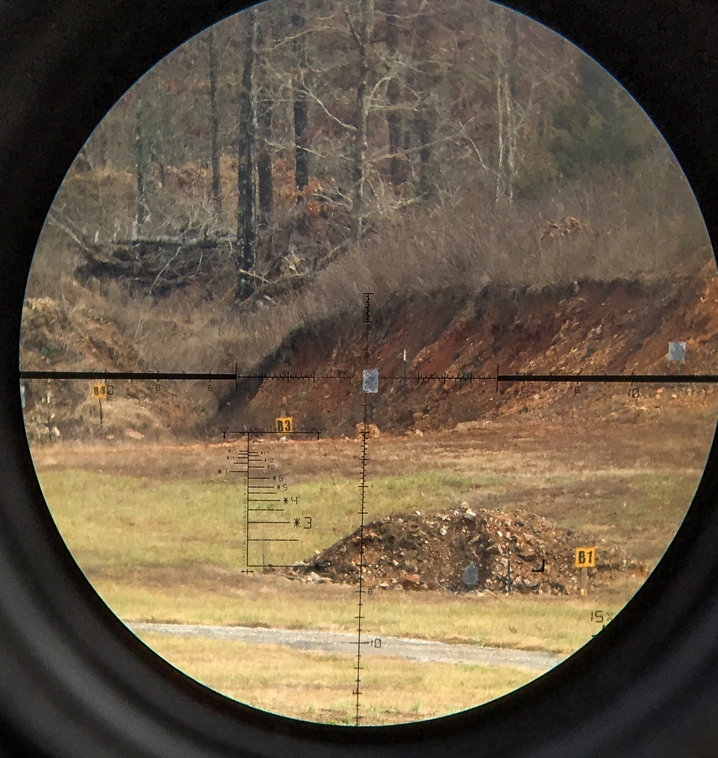

Anyway, I'll shut up and here's the pictures. I didn't adjust parallax for these so they may not be perfect, and they were on my phone and cropped WAY in. I did the best I could but the tiny image is already cut way down in size/quality. I tried to rotate/crop them as similar as possible. I debated cropping in more so that it seemed closer to the reticle size/detail that I recall but I didn't want a bunch of different sizes and perspectives.
15x at 442 yards
12x at 545 yards
15x at 545 yards
15x at 705 yards
15x at 735 yards
