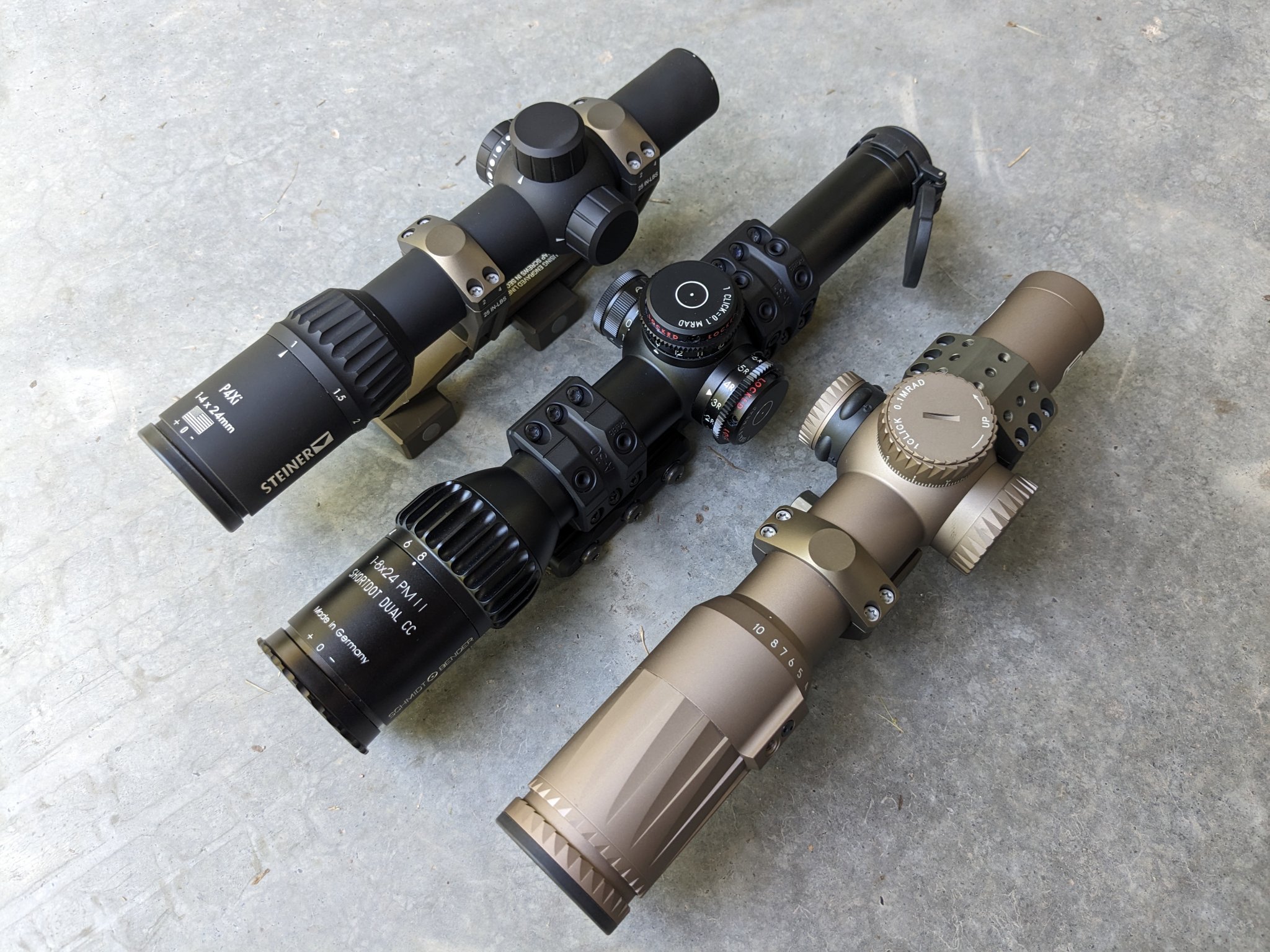

    Where did you get that tannodized Vudu?
    How do you like the dual short dot?
