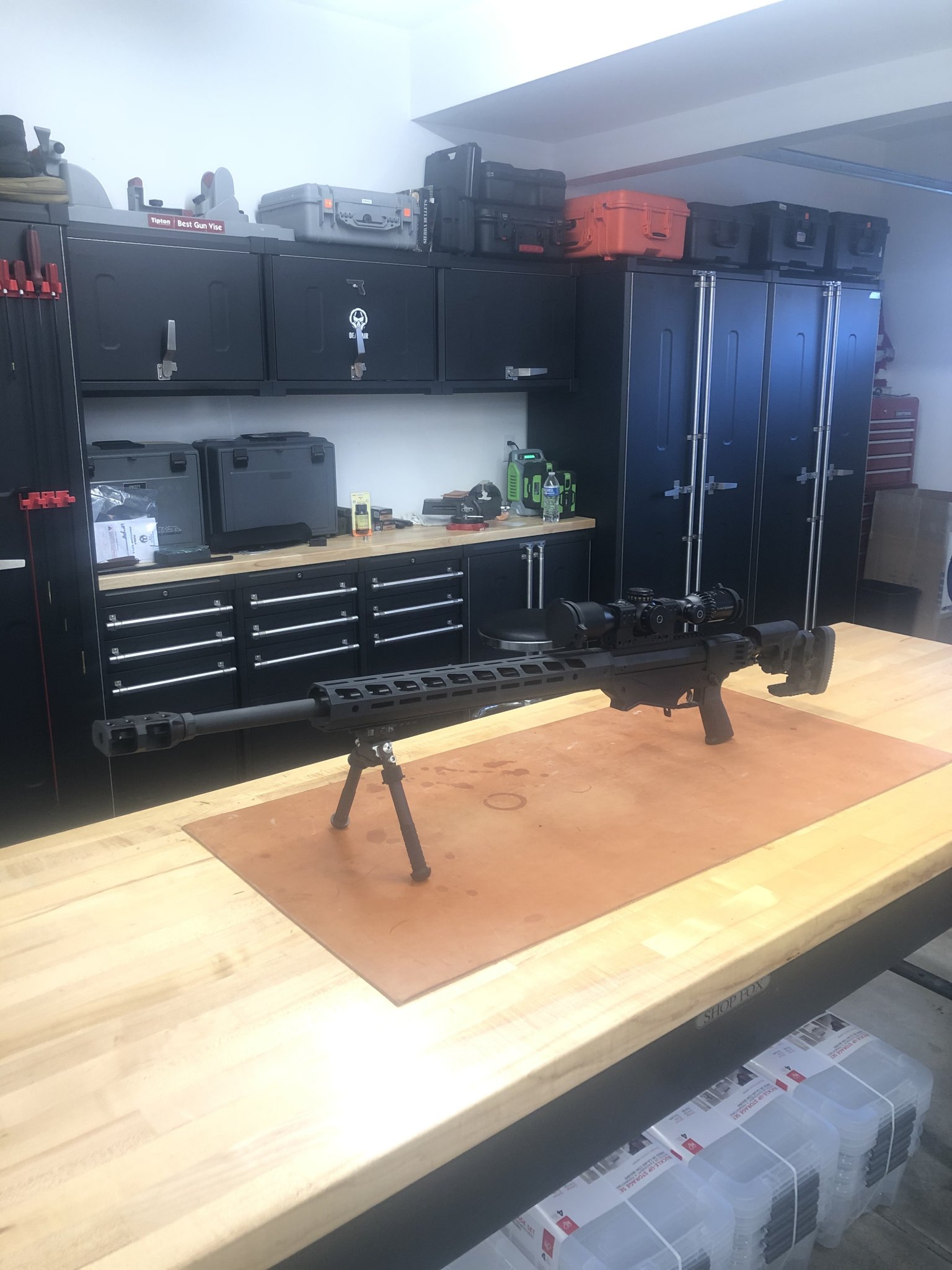

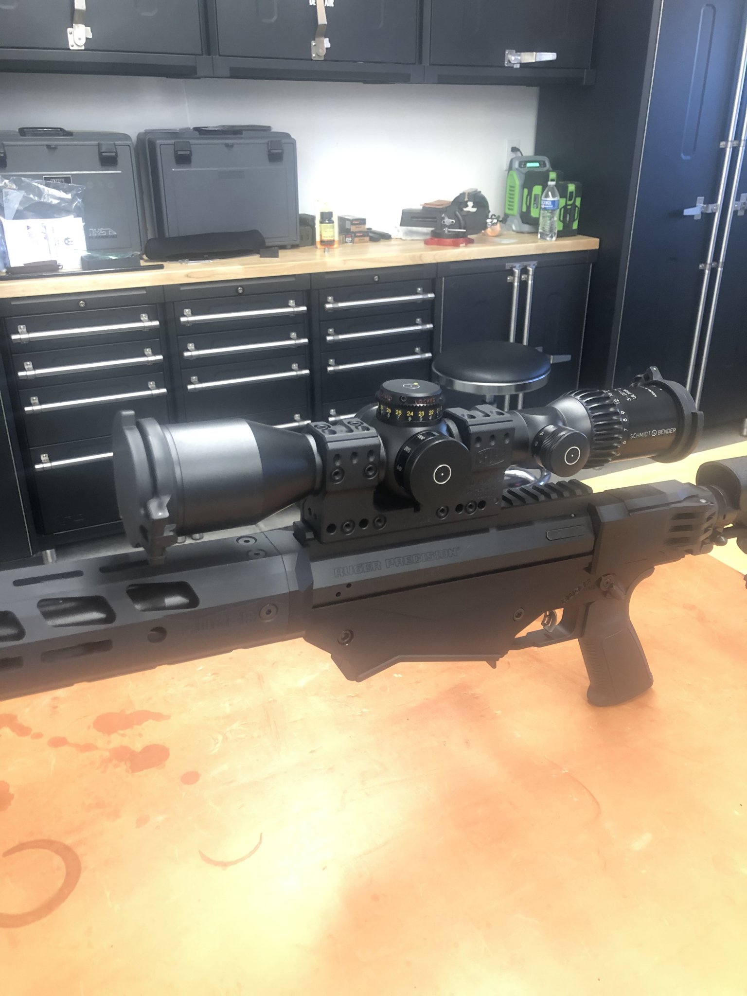

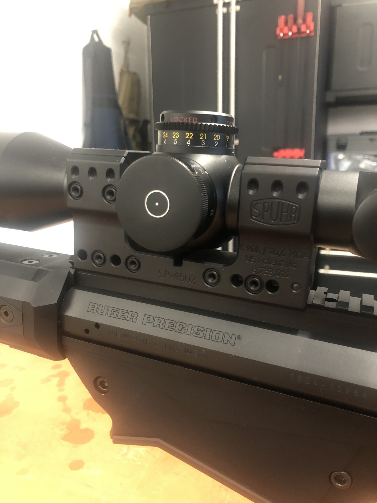

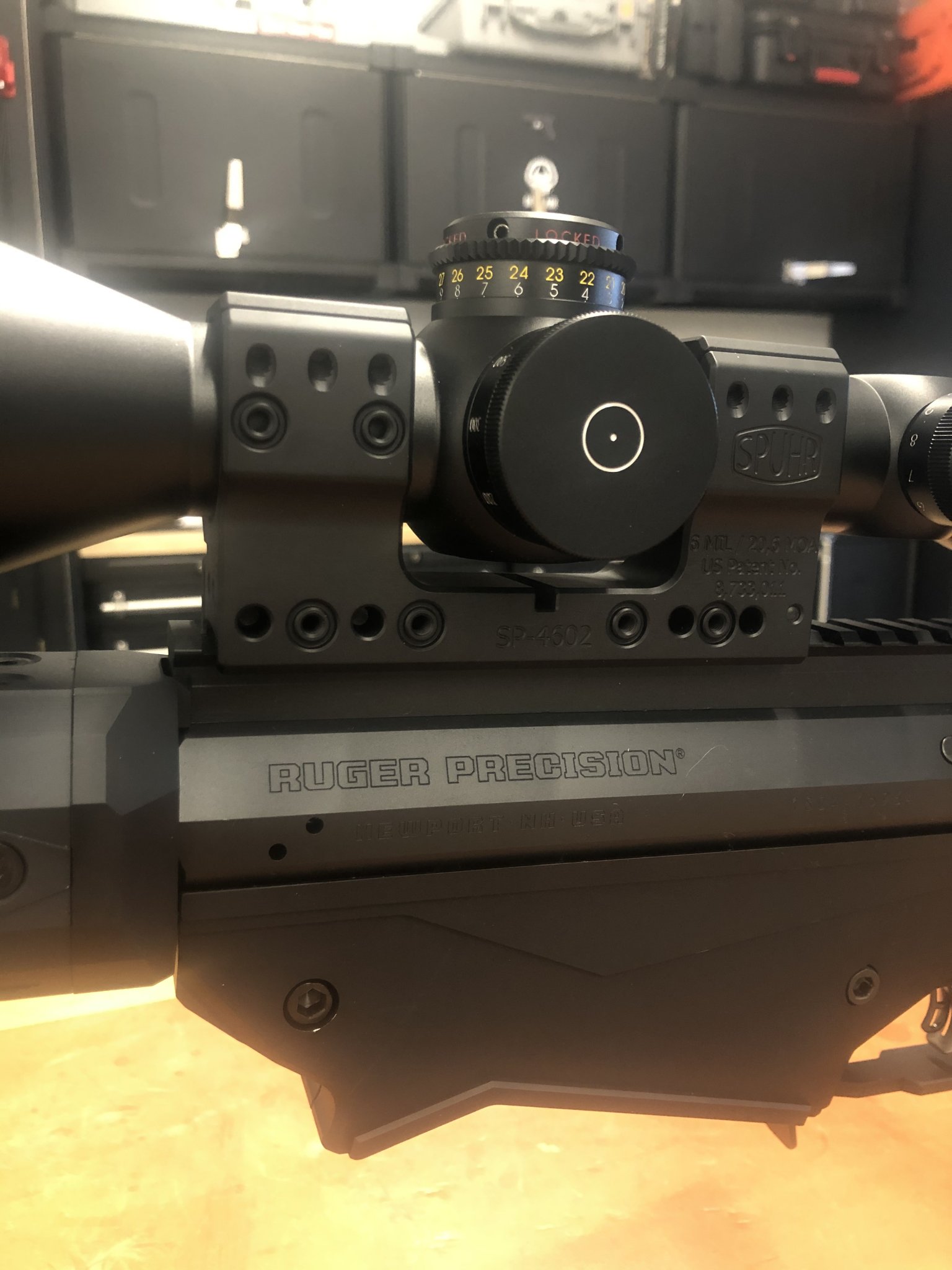

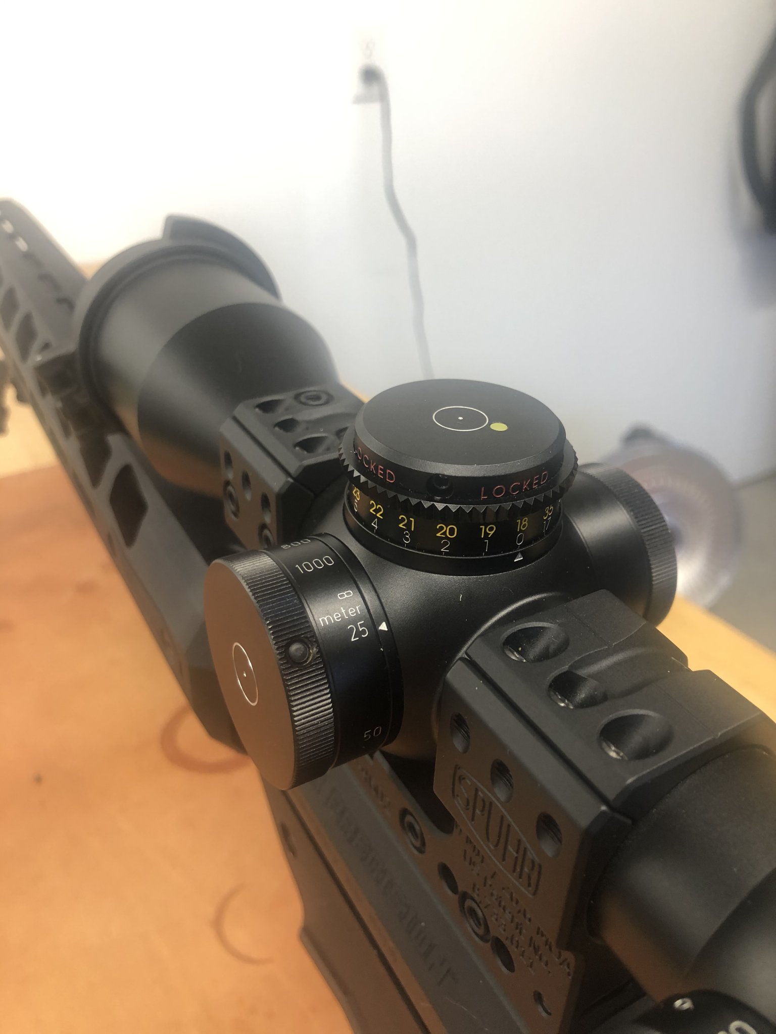

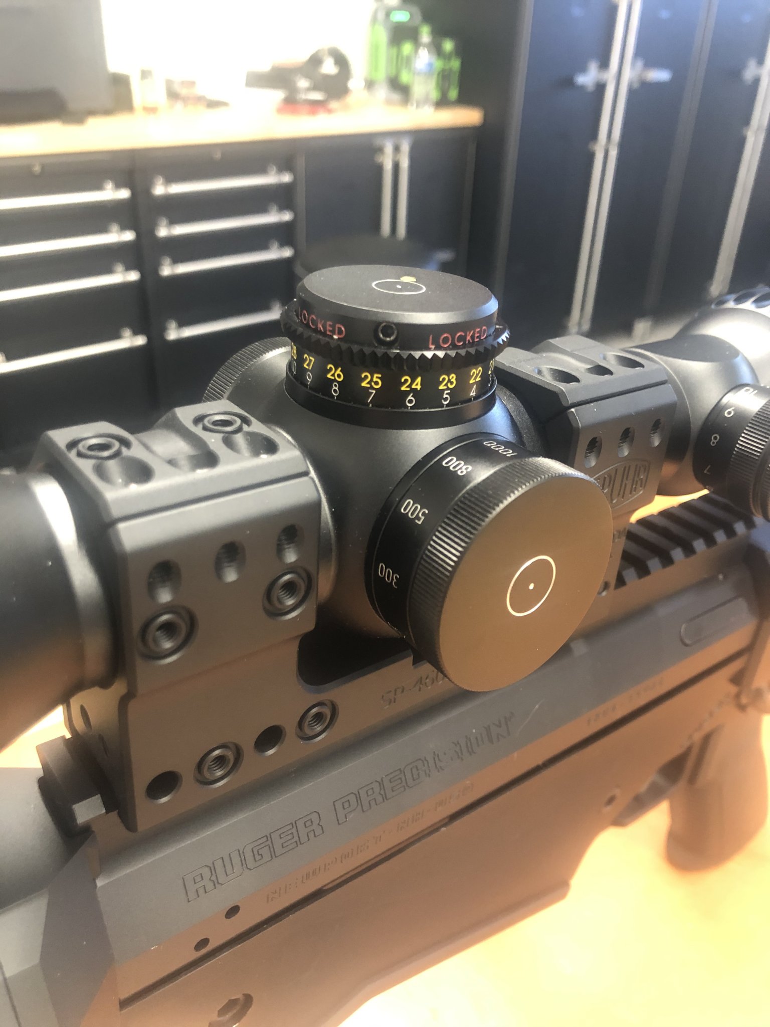

I have searched this forum and googled this and can’t find the answer. I am hoping that some of the hide members might have the answer.
My son just purchased a Ruger Precision Rifle (caliber 300 PRC) he didn’t have a scope yet so I mounted my Schmidt & Bender 3-20 Ultra Short on it to just to get some shots down range. While sighting it I was 16 inches high at 25 yards. The elevation turret was at ”0” so there is not where else to go. The Rifle has a 30 MOA rail and the Spuhr mount is 20 MOA.
1) Can the Scope elevation be set to less than factory zero?
2) If the scope elevation can be set to less than factory zero, how do I accomplish this?
3) I am assuming that I lose elevation range if I go less than zero?
4) Is there any other way to correct this issue?
Pictures of rifle and scope attached for reference. Thank you in advance for any help

Push the lock collar down and loosen the 2 screws on the turret some.
Unlock turret and turn to 5 or however many clicks you need, then lock turret and snug 2 allen screws up.
Unlock turret and sight rifle in.
Once sighted in do the same thing except after you loosen move turret to 0 and retighten.
