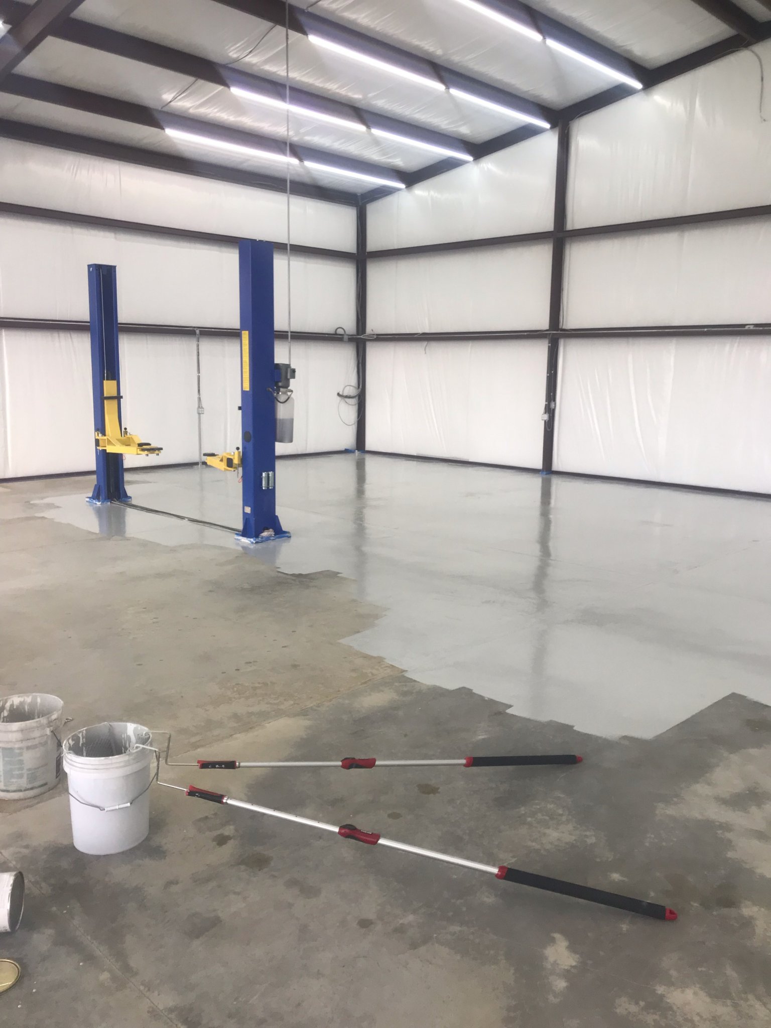

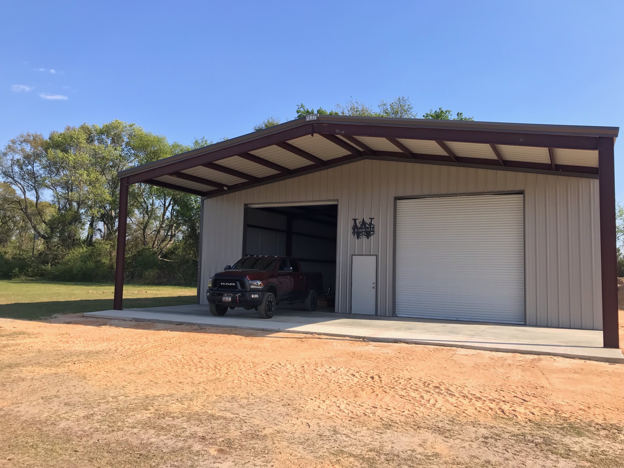

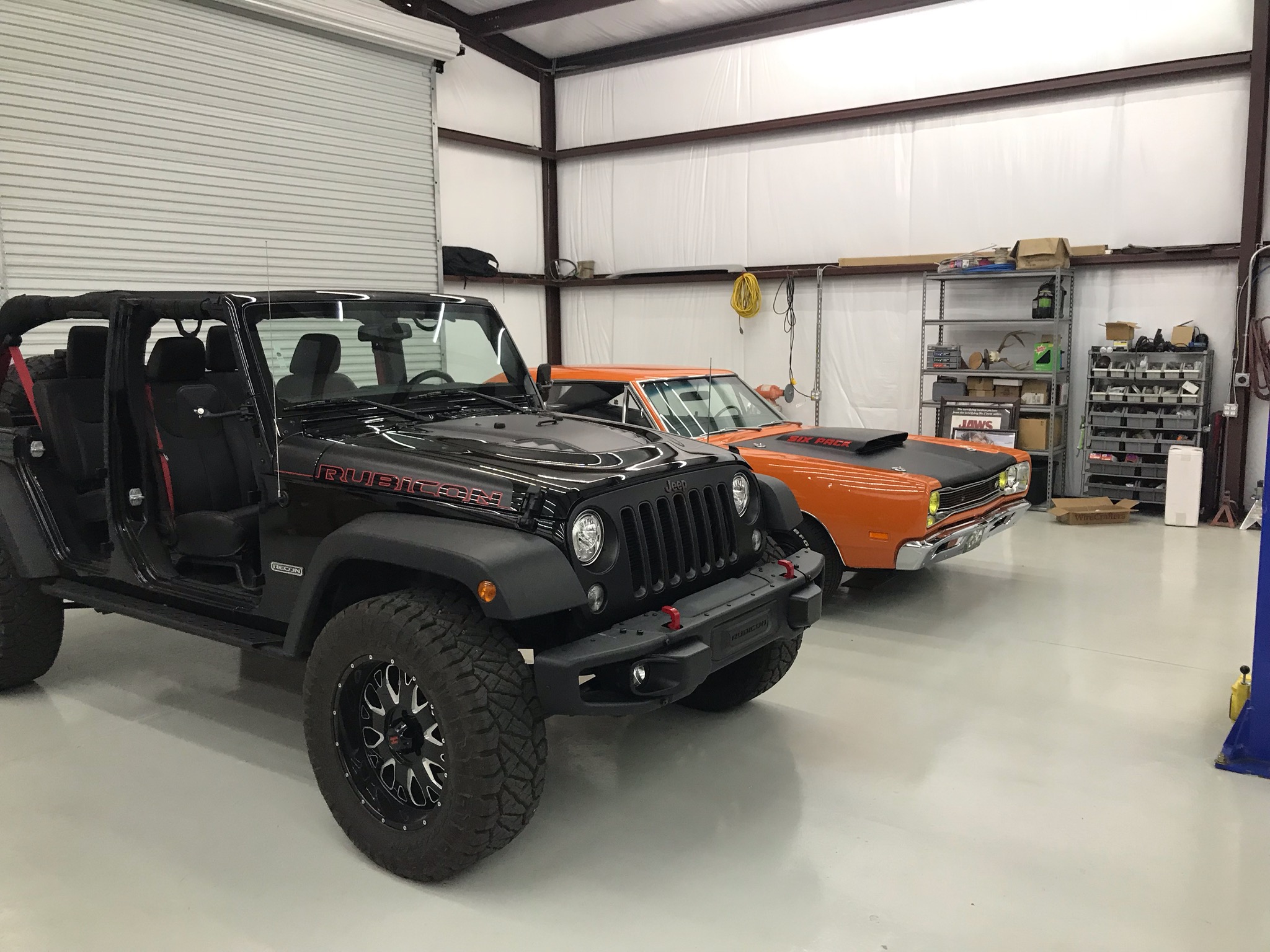

    I built a 40x40x16. One roll up door, one walk through.
    Now I have added 30' of porch off the side for parking equipment, toy hauler, other random crap. Still not really big enough.
    There has been some interior build out which is all climate controlled with the exeption of 16x 40 area that has the roll up door. ( Welding, grinding, woodwork....) I wanted to be able to control temp and keep clean in the other section.
    Reactions: hseII

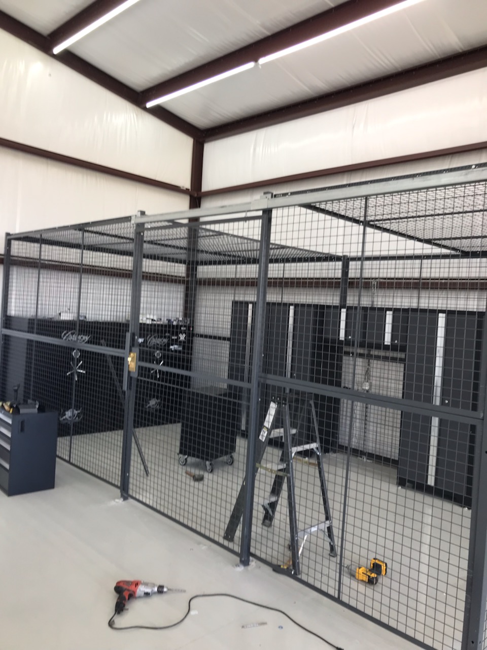

  • Insulation and electric outlets are the cheapest friend you can buy. Don't skimp on either.
    in my 60x100 (14' sidewalls), which is split in 1/2 for machine shop on one side and retail shop on other. I spray insulated, as well as regular insulation and blew in 12" in the attic. 110v outlets are every 4' (alternating bench height/knee height every other) and each wall is on its own breaker. 230v outlets on each wall in machine shop (on individual breakers), along with disconnects for each big machine (individual breakers). LED lights with the highest kelvin rating for the brightest light to reflect off the white walls and ceiling. Ceiling is white metal. Walls in machine shop are: bottom 4' metal with pegboard on top. HVAC is controlled with 2 mini splits.
