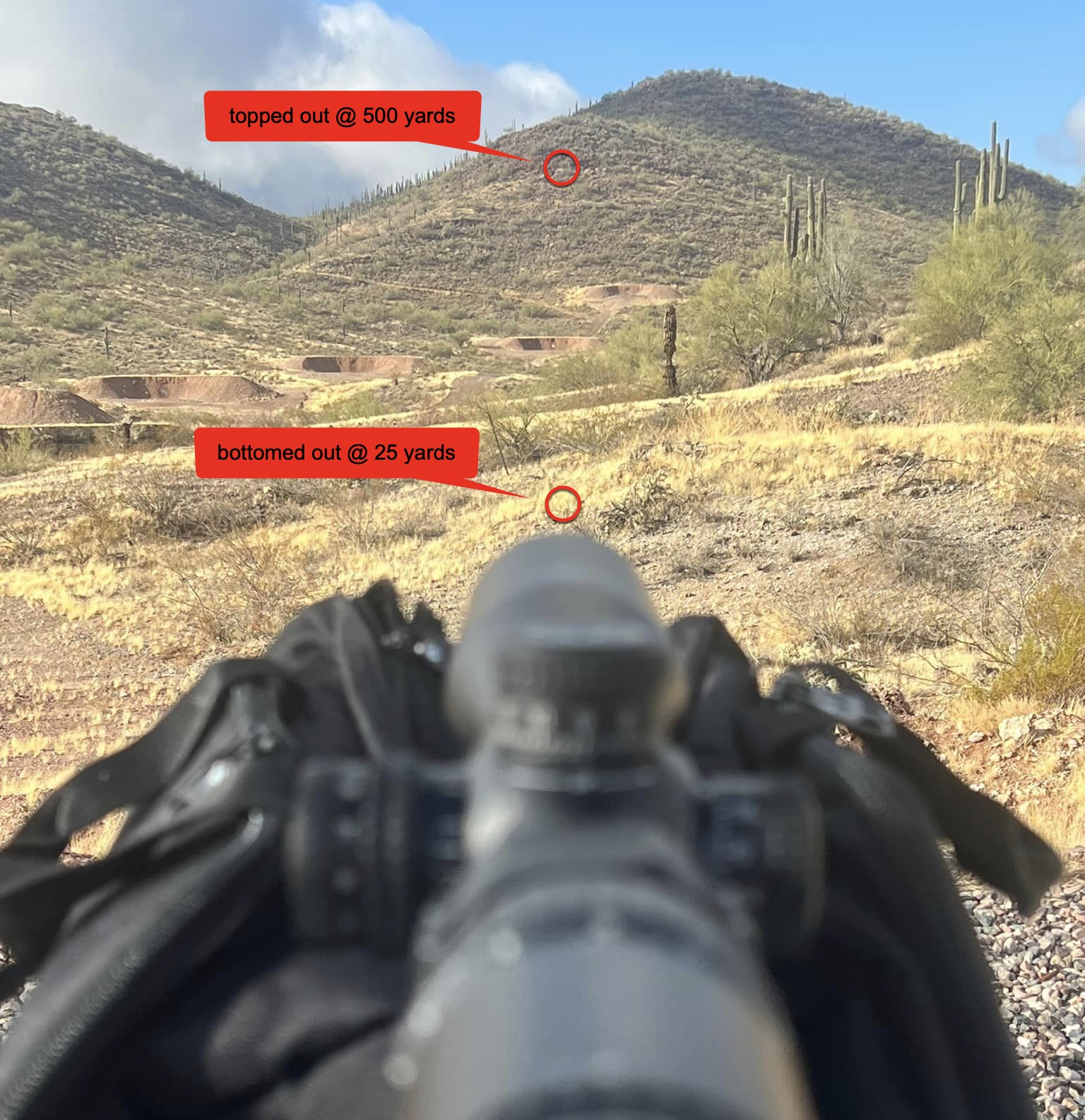

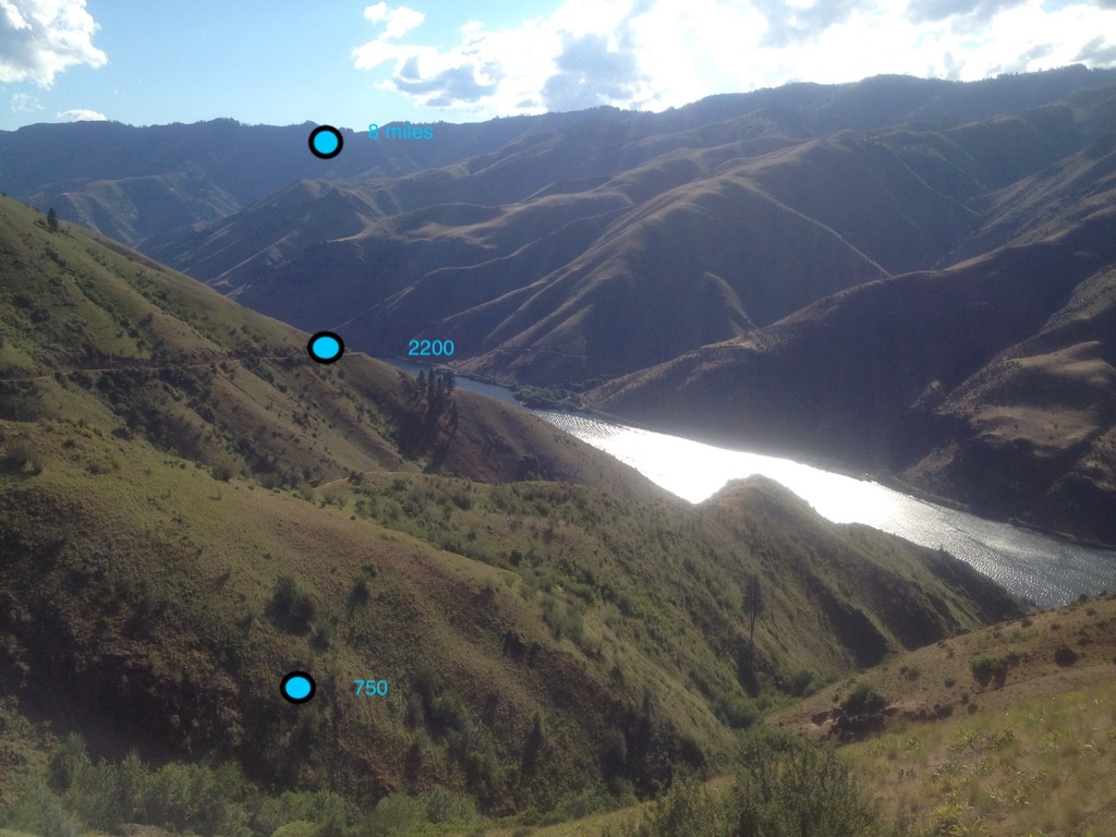

As you may guess, if you hunt in the mountains much at all, there will be times that your "backdrop" is even more than 10 miles away. So...what information is that? How will you use that information?
Reactions: Taylorbok
Not looking to beat a dead horse here. It seems no one understood what I was initially thinking would be a handy formula which I finally realized would never work for flat ground. Some of you keep making up scenarios (10 miles away? How will I use that?) that have nothing to do with what my original question was searching out. I appreciate those of you that may have been trying to help but I just feel like you are trolling at this point. This mark up is what I had in my mind. Again, I realize the fault with that thought process. Pic borrowed from someone online.
This is my own pic. Yardages are an educated guess from my knowledge of that spot. Obviously not flat ground.
I am truly curious what that information should be telling me as I see it through the scope.
I am truly curious what that information should be telling me as I see it through the scope.View attachment 8305109
It's not going to. Not sure how many times I need to say I see the fault in what I was originally thinking. The image was just an attempt to provide a visual example of what I had been thinking earlier in the thread. Again, I see the fault in that line of thought.
Good for you to admit you had fault in reasoning but Even still in that picture you posted he’s run it into a firing solution, looks to be for a 22lr.
Yes, you can apply a firing solution to it but as I have explained, I was looking to utilize the optics without applying a firing solution. Hence my example of mounting an optic to a tripod without a rifle. And again, I borrowed that image from somewhere online and simply marked up the fake reticle dots as a fake example for the purpose of explanation. It was not intended to be viewed as a real example of what I was solving for.
