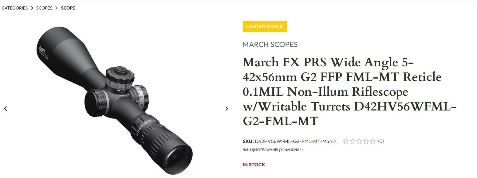

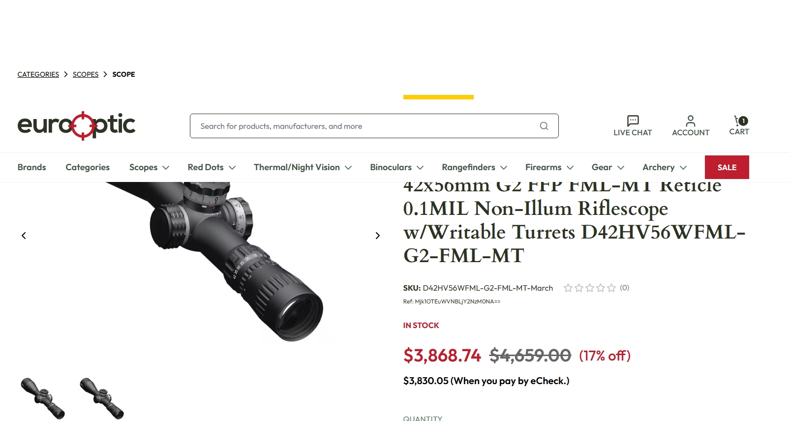

March 5x42 High Master. I generally shoot about 20-25x at a mile but some days you can shoot all the power you want to shoot.....occasionally. The power I shoot at a mile is right in the sweet spot of the 5x42 March. Great glass in my experience with lots of erector travel and solid all the way around though every scope you list is very good.

This is going to be my next scope for my ELR Light rifle.
