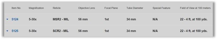

Steiner:
T6Xi 5-30x56
Item No.MagnificationReticleObjective LensFocal PlaneTube DiameterSpecial FeatureField of View at 100 meters
51245-30xMSR2 - MIL56 mm1st34 mmN/A22 - 4 ft, at 100 yds.
51255-30xSCR2 - MIL56 mm1st34 mmN/A22 - 4 ft, at 100 yds.
Please give us a call, 516-217-1000, to discuss what would be best for you
