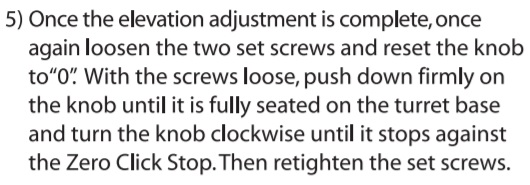

If I follow the Burris manual, there is no dialing under zero. The attached step fixes zero the "lowest" position that can be dialed. If I lift the cap slightly when setting zero, it disengages the ZS. I can dial under zero, but travel is stopped as the cap wedges itself into the turret housing; this then also stops rotation somewheres around 4ish MRAD under zero.

Doing that puts your zero at the 1 MRAD cap position.
Using a pinned cap to set the zero stop is a fairly crude design. And not exclusive to Burris... the JOL zero stop is the same way.
Edit: the Cronus 1-6 also uses a pinned cap for the ZS.
Reactions: Birddog6424
The XTRII and XTRIII both use a mechanical zero stop. If you set it by getting your zero, pressing the cap all the way down and tightening the screws, you won't be able to go below zero.
I have had people tell me that they could line up the zero and not press the cap down into place, tighten the set screws and be able to dial below zero, but I've never tried it.
Reactions: Neurotic
Yeah, this will put the actual stopping position somewhere around 4 MRAD under zero. The stop is then when the cap jams against the turret housing. This is an unsealed area, so any dirt/dust/debris will help grind/crunch the turret cap to a stop. This feels like mechanical abuse.
How do you figure? Rotate it to whatever position you want, push it down and snug the screws.
I don't think you understand. When that is done, that sets the zero stop at that position. There is no dialing under that position. So, it's not possible to dial under zero. The best this scope offers is to set zero at some position under the actual zero.
Edit: to add clarity, either you set the zero stop at zero, or you don't use the zero stop. Those are the options.
That is true. Which is exactly what you're doing when you set the cronus below your actual zero.
It is called a zero stop for a reason. When you set it, you can't dial below it.
Whether it is your actual zero or 1 mil below your zero.
I own both. Personally, I don't see the utility of setting below your zero, but I zero at 100 yards, but I did explore setting it below the actual zero.
Then you don't understand how the Cronus/Bushy zero stop works... It's a stop, that doesn't need be only a "zero stop".
It's a disk that can be positioned independently of the cap. It can be set to any position. So, one can find zero, dial down 1MRAD, set the zero stop disk position, then install the cap at 9 MRAD. Now, zero is at the cap's zero and th zero stop is 1 MRAD under.
This independent setup is useful if you don't shoot the same round/load all the time.
I understand exactly how it works. You can do the same thing with the XTR it just isn't as easy.
I'm not going to convince you, so I'm checking out.
You literally can't. The XTR cap and stop positions are fixed relative to each other; since the stop is built into the cap. These are independent settings on the Cronus/Bushy versions... Jeebus.
Once you have the stop set on the cronus/Bushy scopes, you can't dial beneath it.
Once you set the Burris, you can't dial beneath it.
You can set any of them wherever the fuck you want to.
Do you want it 1 mil below the actual zero? Fine. Of course, then it is just a stop, not a zero stop.
Do you want it to read zero? Fine.
Do you want it to read 9? Fine.
You can do it on either.
We may be talking past each other here.
Yeah, you missed my point... it's not to dial under the stop (not possible), it's to set the stop under zero to aloe dialing down.
But you cannot set the XTR stop position anywhere, it only works at the cap's indicated zero position.
The xtr is a simple cap, with a post that drives the mechanism.
It is a simple matter to loosen the grubscrews, raise the cap slightly, if required, tighten the crews, dial down to 1 mil below your zero, loosen the grubscrews and set the zero stop, on whatever number your heart desires.
Your stop is now set 1 mil below your zero.
You're missing the point.... Doing what you describe just jams the cap into the turret housing. That doesn't actually use the zero stop pin. And, if I recall correctly, it cannot be set very close to 1 MRAD under since the turret pitch isn't coarse enough to raise the cap elevation that quickly.
I know how it works and I know that you can set it below your zero.
However, after thinking about it, I don't know if you can go a full mil.
There is room though to set it below.
No offense, but you should pull the elevation cap to see the design's simplicity. It's better than the Veracity design that limits to just less than one revolution. But it's less sophisticated than the Bushy/Athlon design.
The JOL version offsets the pi location to allowing dialing down a few tenths of a MRAD. I personally would've preferred if Burris would've done that. It doesn't stop at zero, but it's a good compromise.
I've pulled, and I've set it.
I own a Bushy 4.5-18 lrtsi, a cronus 4.5-29 gen 2, an xtr ii 4-20 and several others that don't have zero stops.
It is a simple design. Not perfect, but way better than the shims on the pst 1 and better than the goat fuck on the venom and strike eagle.
