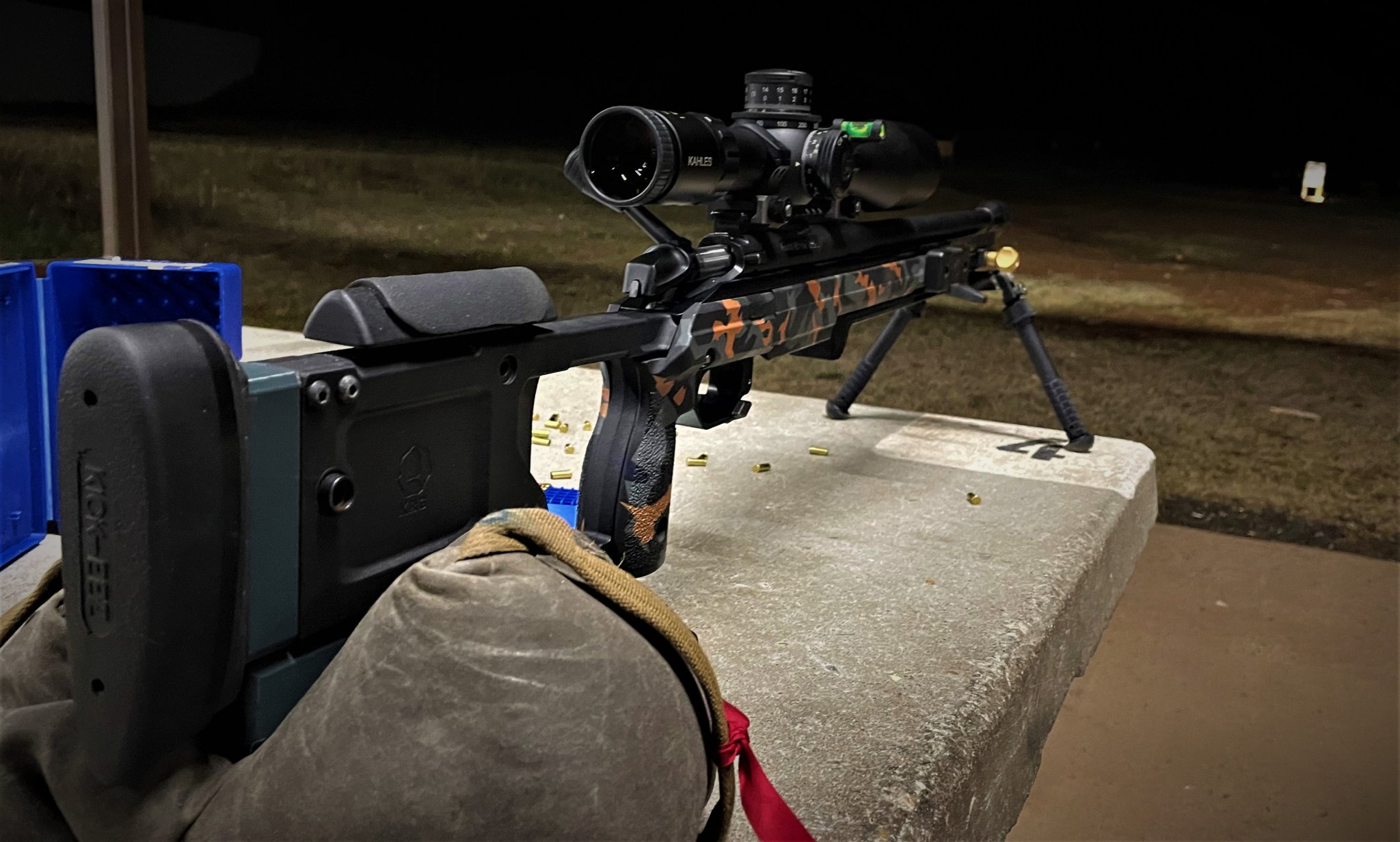

You need an accurate rifle and a scope that will let you see your hits. I'm pretty happy with my setup now, a Bergara with a K624i. It's won quite a few matches this year. The 50m parallax is a bit of a hassle on close targets but I just dial down the mag and it's plenty good enough. I ran a DMRii before this and it was pretty good, I just like the floating dot on the Kahles and the top parallax adjustment is much easier being a lefty.
