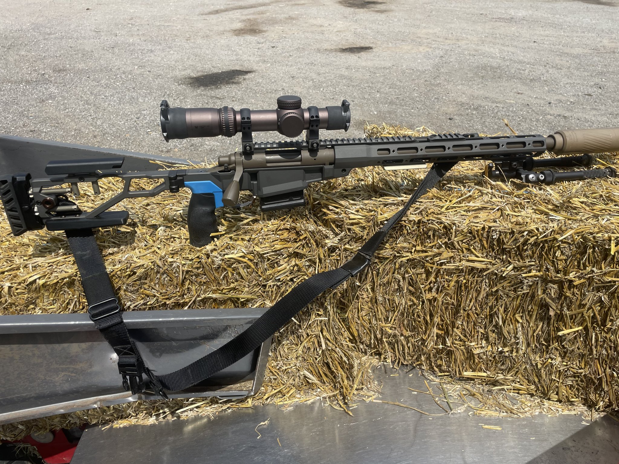

Got you covered... I was so impressed with the one I bought, I bought a 2nd one... Plus, right now they're running a 12% off site-wide sale using the code: SAVE12
One thing I really like about this one, is the reticle is a true MIL reticle that use MIL marks, and not a BDC that is limited by a specific caliber and bullet. That way you can use this on whatever rifle you want.
I run one on my Ruger American Ranch 16" .300 BLK...
And, for a while I was using it on my 16" MPR .308 Win until my new Kahles K624i came in. It was really cool on that rifle, and would have been a really awesome hunting rig.

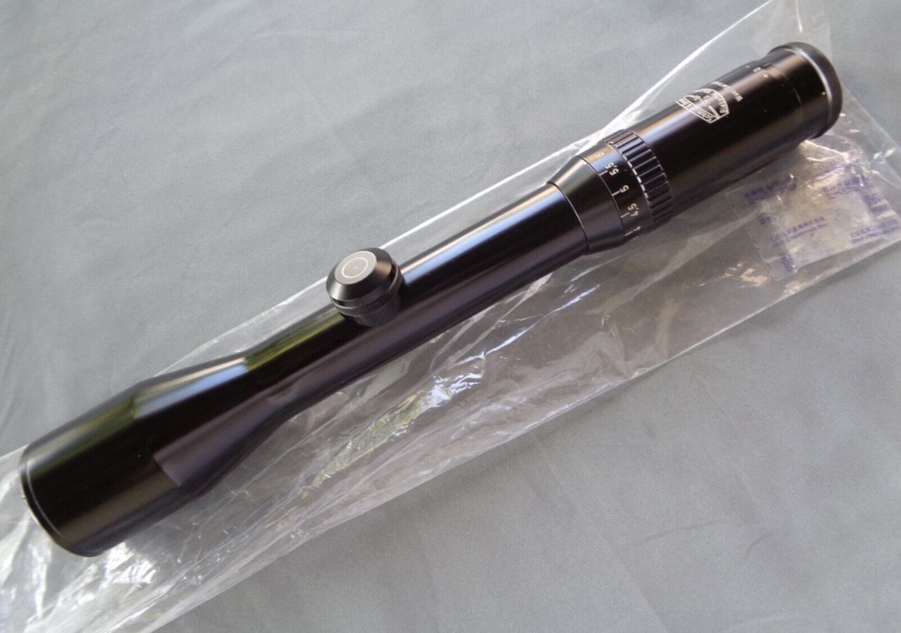

Here is a nice looking S&B. Not sure if it’s any good. 1.5-6x??
link

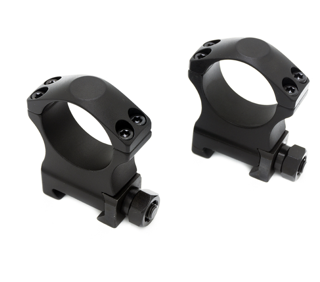

Are these your rings?
Woof!
Are you talking height or quality.
Cause they’re Nightforce and there’s none better
