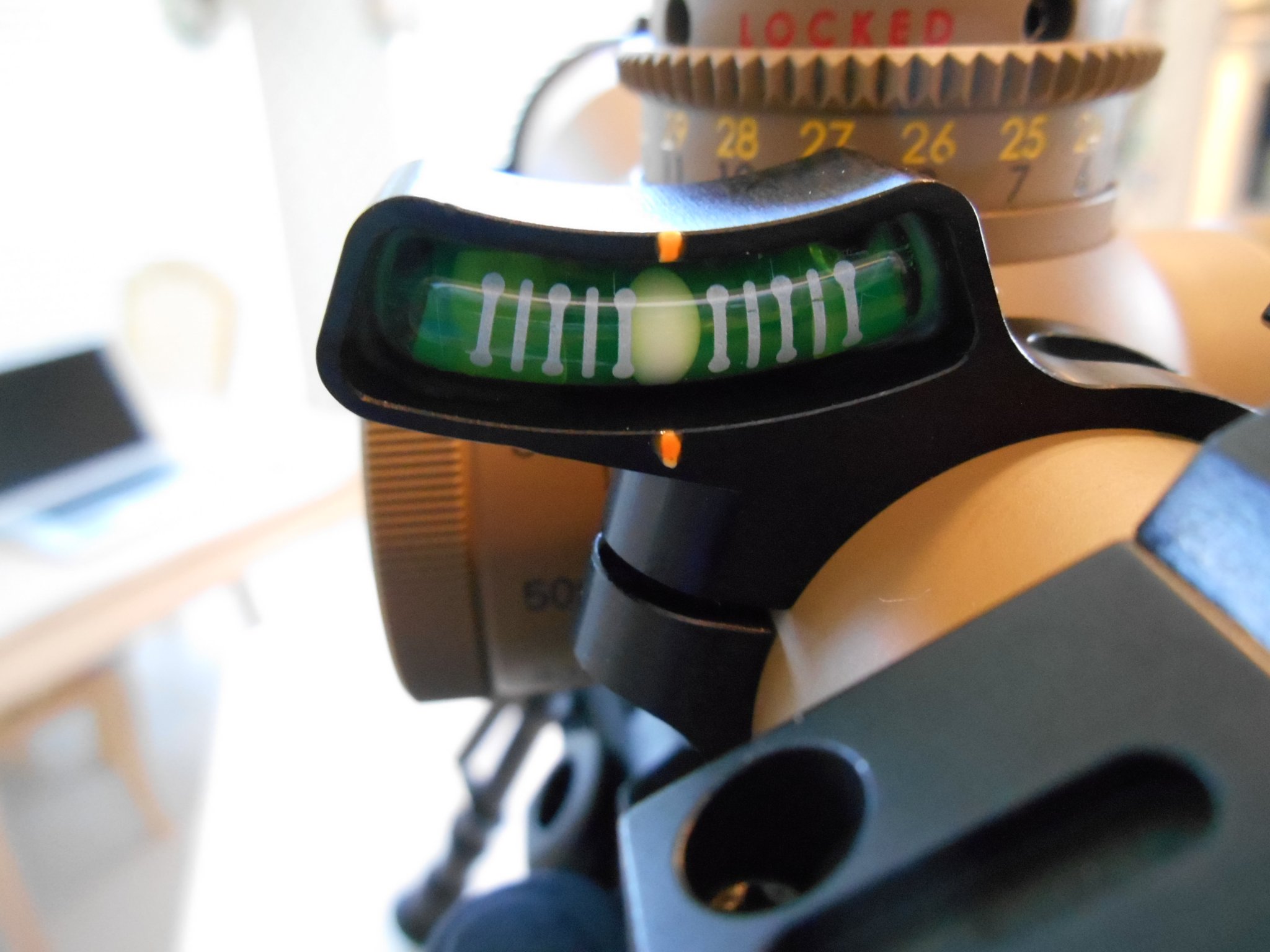

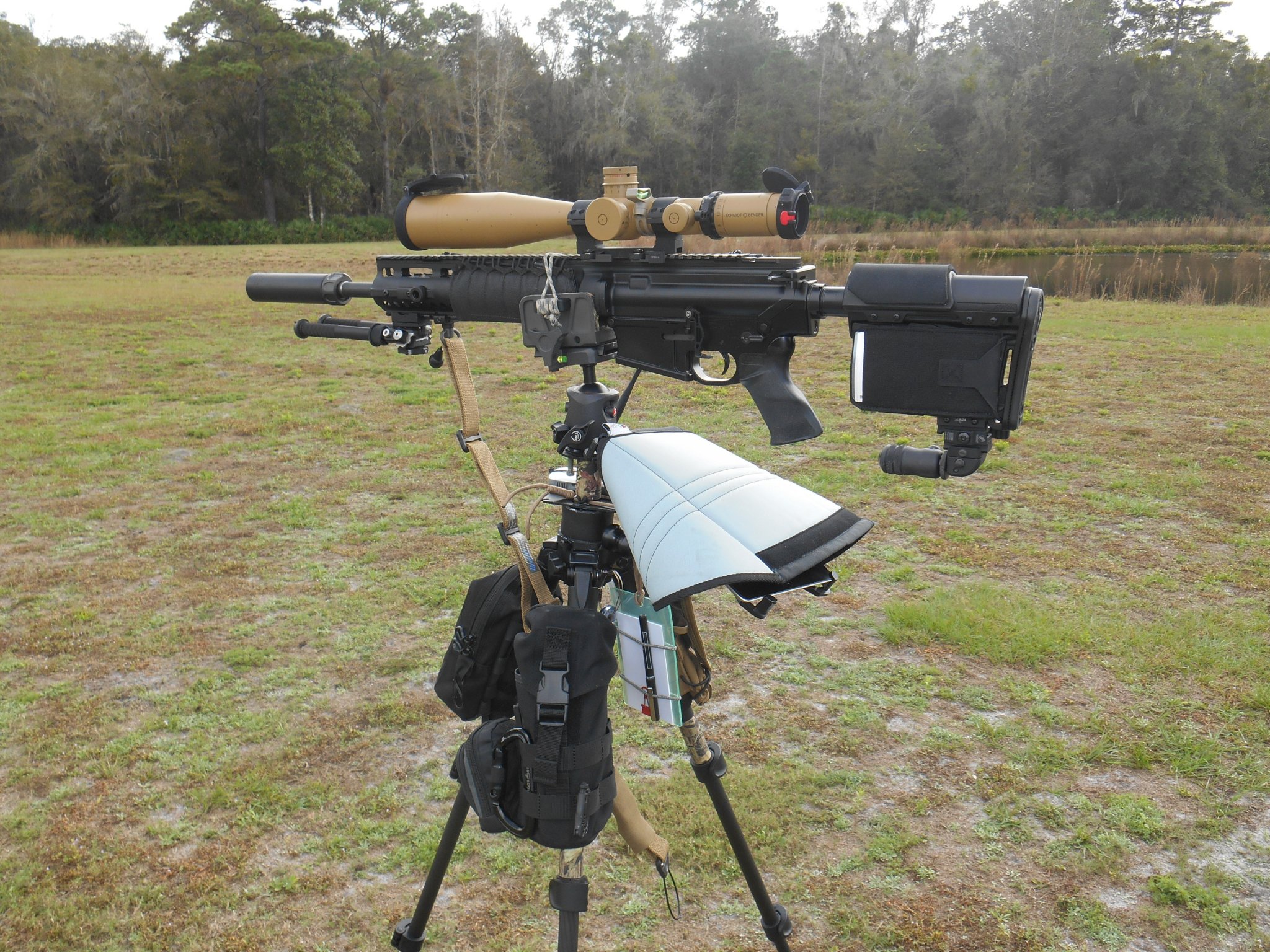

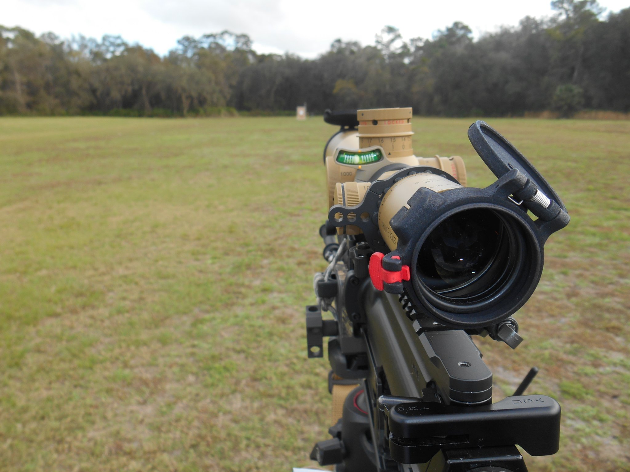

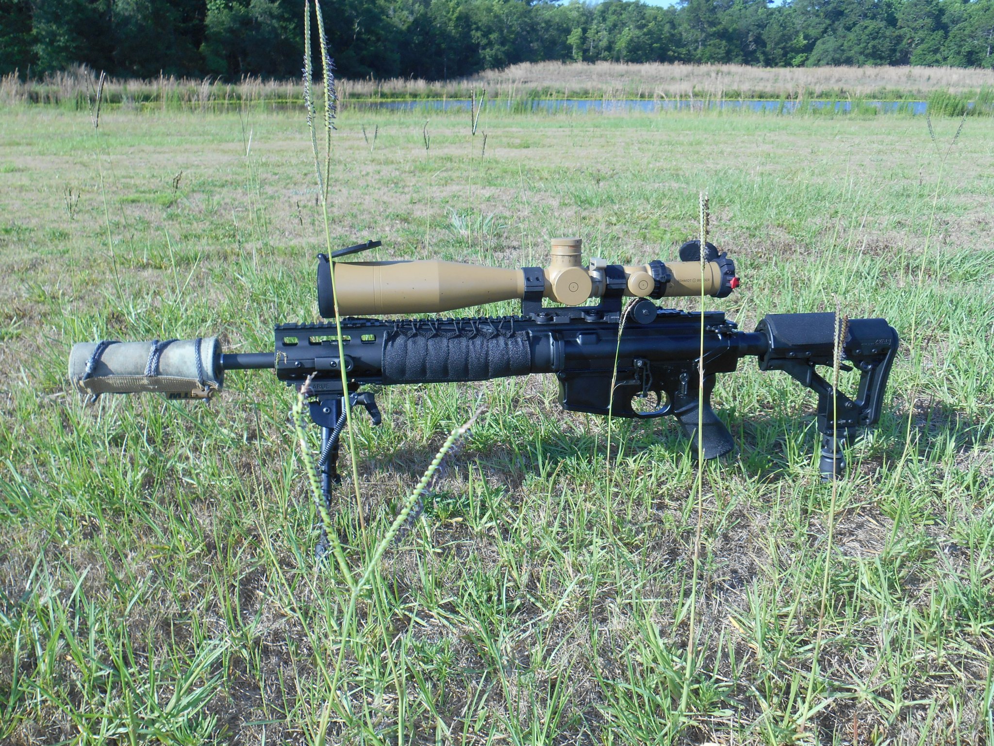

I use the Accuracy 1st on several platforms. I prefer to highlight the level indices as they are not at all easy to read without enhancement.
As an aside, one can also use the horizontal reticle on target references to assist in whether or not the rifle is canted.

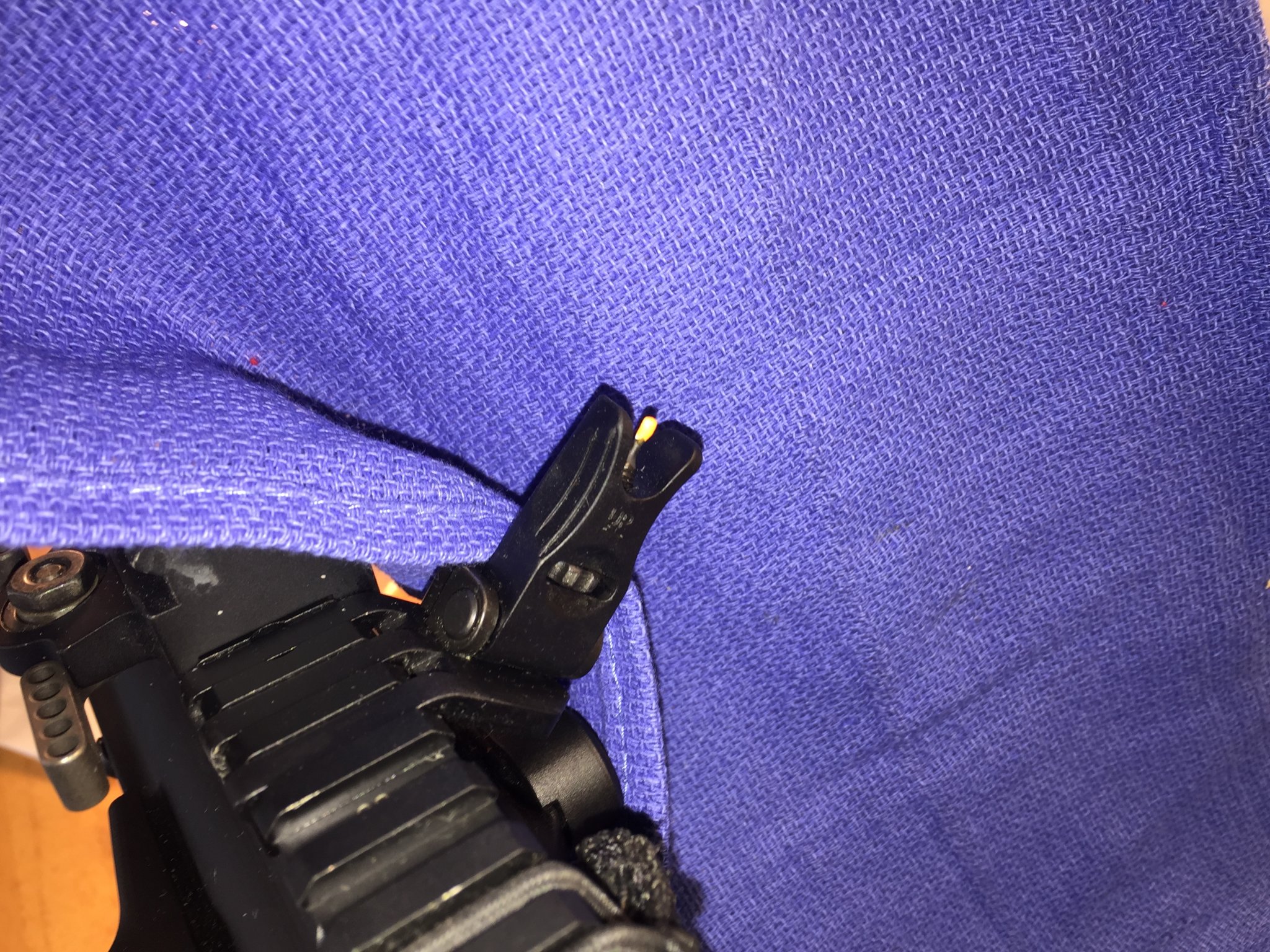

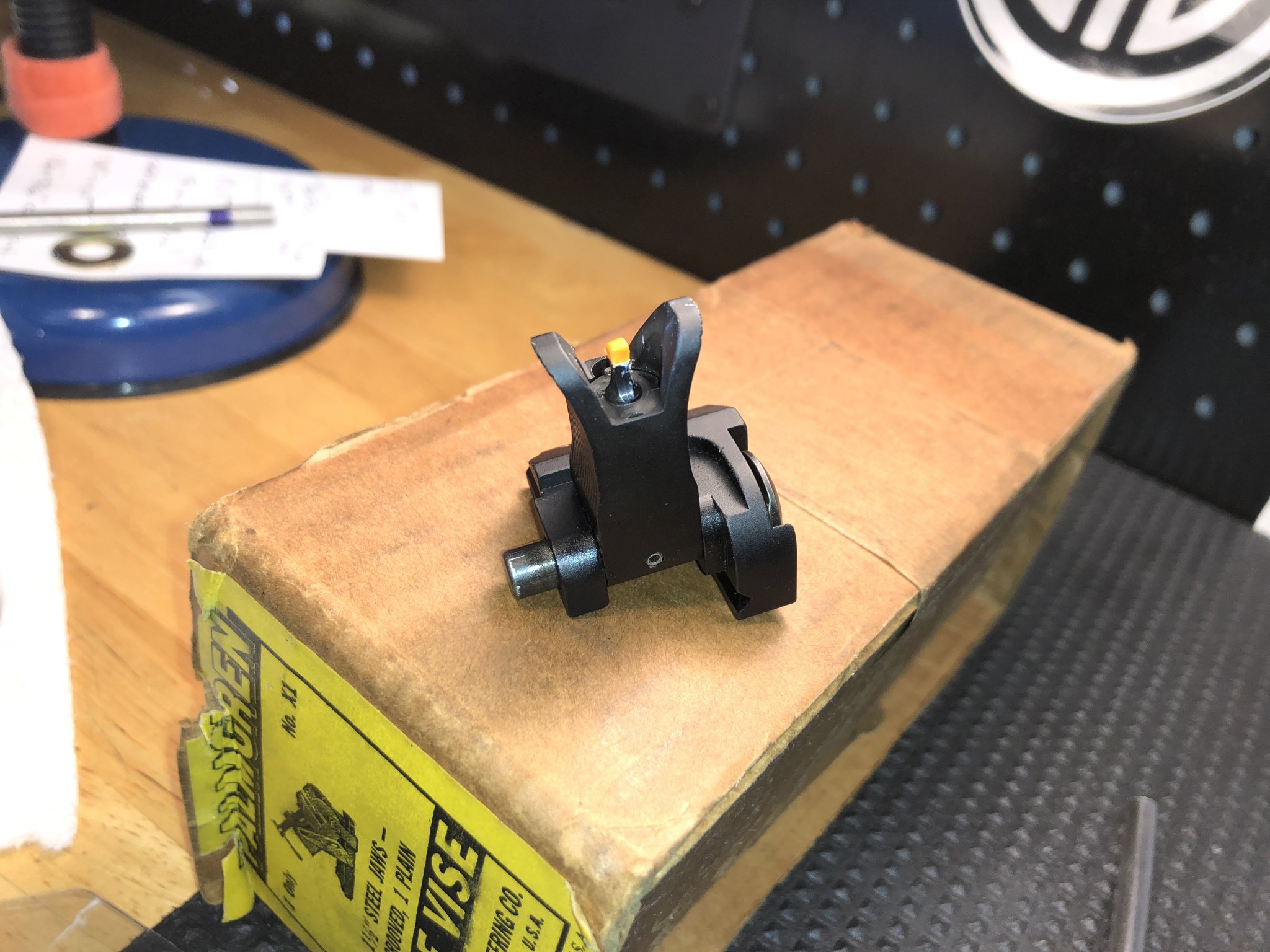

^^No. Just like painting sights. Use a white base coat, THEN apply the second coat of desired color. IF you try to paint a green / yellow / red etc on a black / FDE base it never appears bright, which is the point of painting it, usually.
I use this system of paints; one kit will last a decade unless you are doing friends and extended family. Lots of folks use Testors model paint and it apparently works for them. I build highly detailed car models but my models don't leave the house.
View attachment 7857535View attachment 7857536
Well it seems incredibly obvious when you say it like that lol. Never even crossed my mind.
I've been using the same bright day glo orange nail polish bottle for years now for the tip of the AR sight. Wonder if it would be brighter (it's already pretty bright) if it had a base coat of white...
