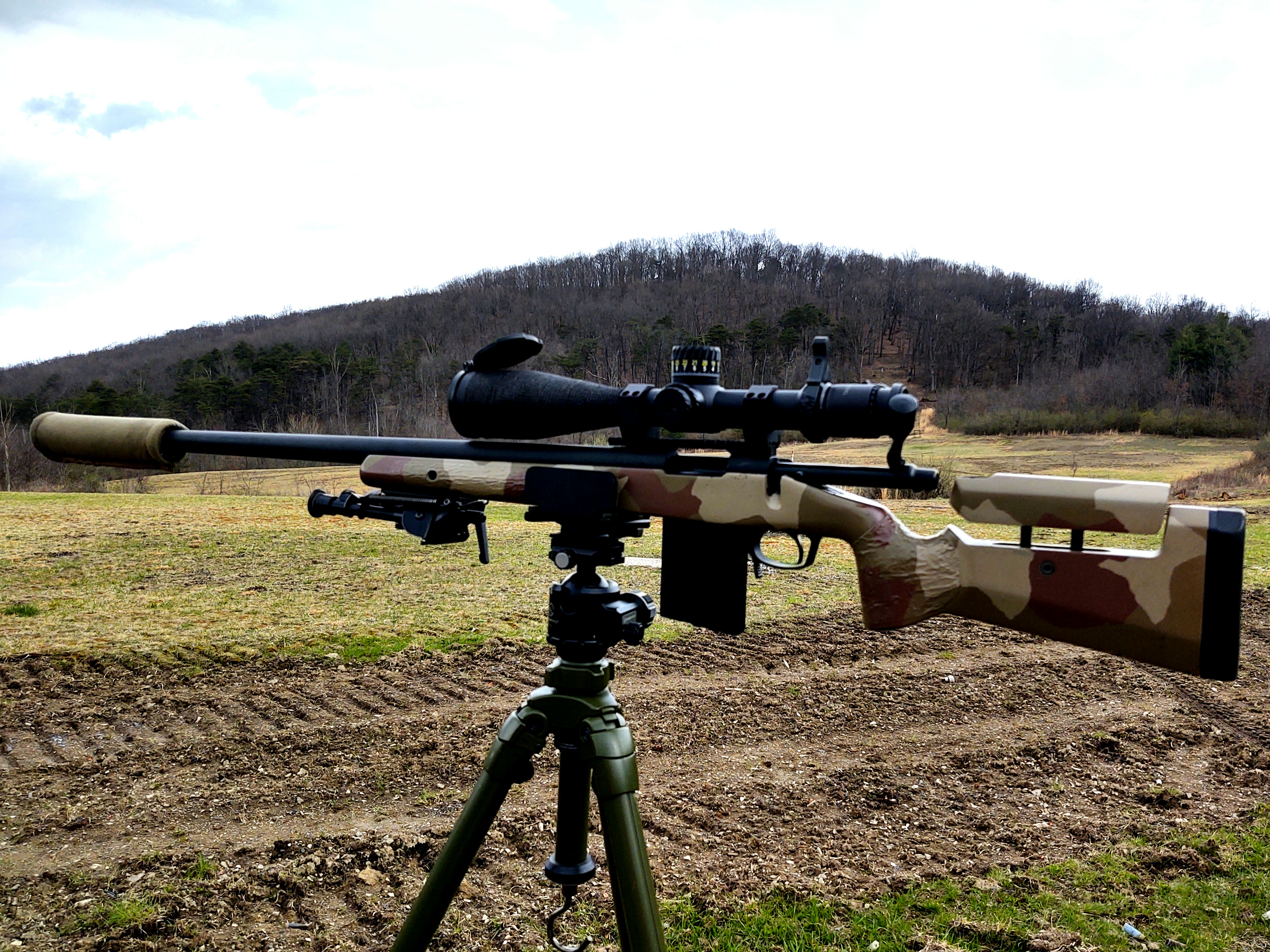

You’ll probably own the mount longer than the scope. Buy a good one. I’ve settled on ARC Mbrace mounts and own their previous gen M10 rings. Love the whole one-bolt setup. I do, however, own a Spuhr for a particular rifle because, well, it just looks “right” on that gun.

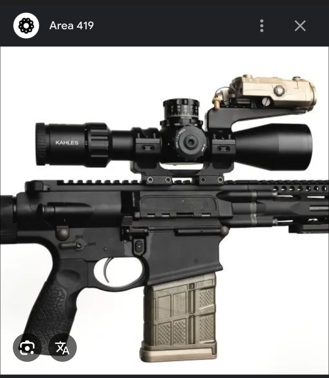

Lots of buzz around Area419’s one-piece mount.
If you’re going to add a WMLRF later, think about how good the bridge design is. I know the above two (ARC/A419) bridge designs are solid (talked to Scott at Vortex). In particular, the ARC bridge design is bombproof.

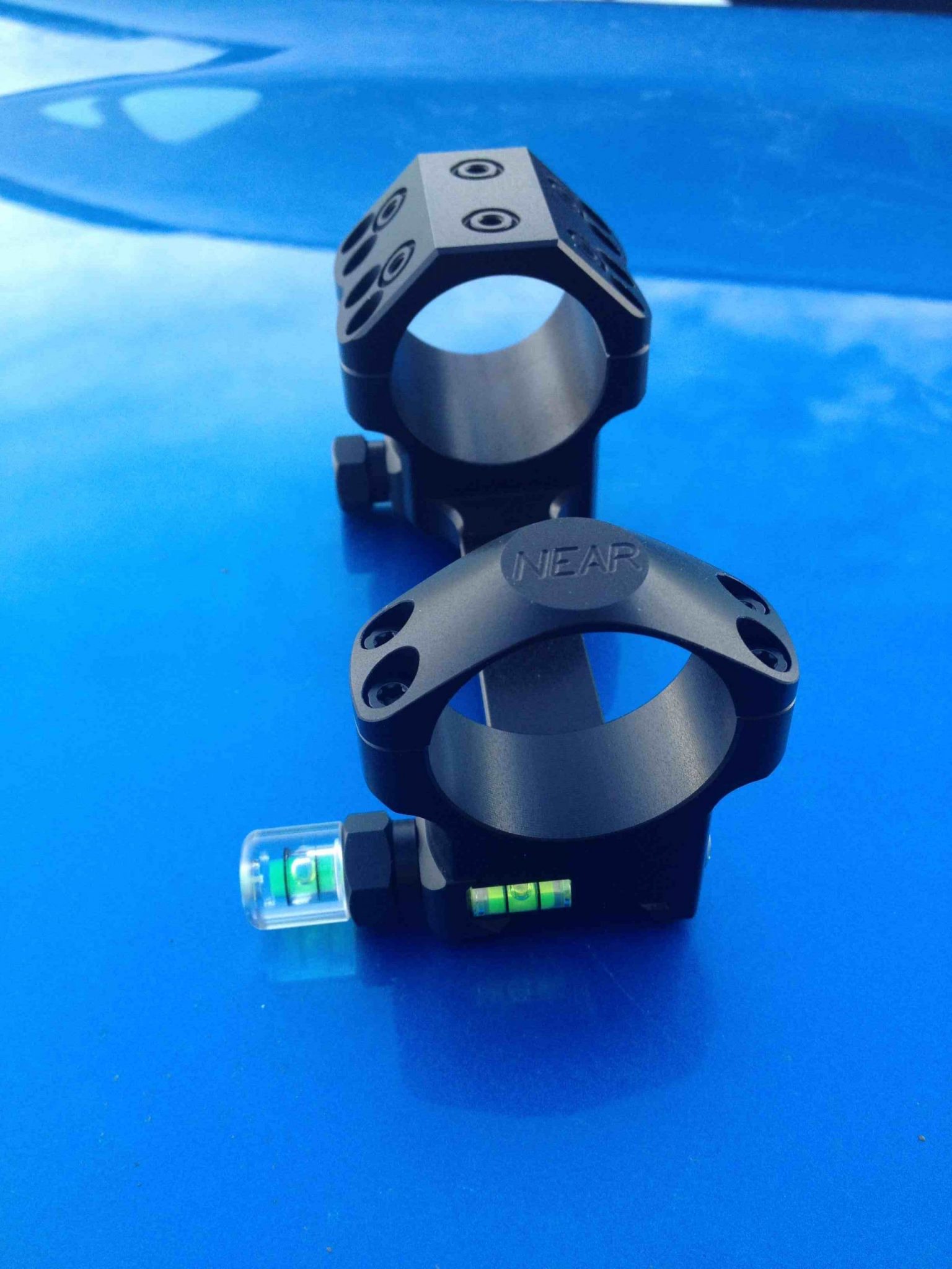

Thinking of going this route next, if only because I’m curious. I own some of Near’s rails. Richard (the owner) makes phenomenal mounts and rails. I believe the below version of his Alphamount takes Spuhr accessories.
Erik Cortina and some KO1M/KO2M winners or competitors seem to like them: http://trg42.com/alphamounts/
Below is the stock Alphamount

IMO 419 makes the best current mounts. And they are a bit cheaper than spuhr/grey ops. Great design, good mount system and bored exactly to dimensions. The cantilever is perfect on an AR.
