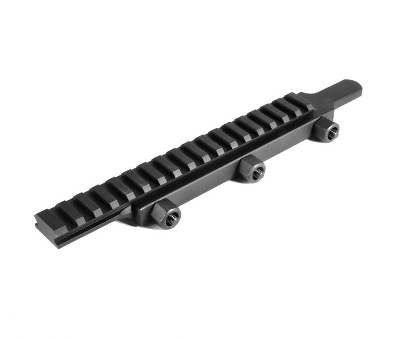

I buck the trend towards one piece mounts on my precision AR's , especially if the scope is a heavy one.
I use the EGW Extendariser ( 20MOA ) and conventional scope rings of your choice.
I want to support the larger scopes as much as possible. JMHO, but it sure seems to work.
https://www.egwguns.com/ar-rifle-parts/ar-picatinny-mounts/
!!!!!!!!!!!!!!!!!!!!!!!!!!!!!!!!!!!!!!!!!!!!!!!!!!!!!!!!!!!!!!!!!!!!!!!!!!!!!!!!!!!!!!!!!!!!!!...jpg
This photo shows a similar extended rail ( no longer made )
On a 18" 308....

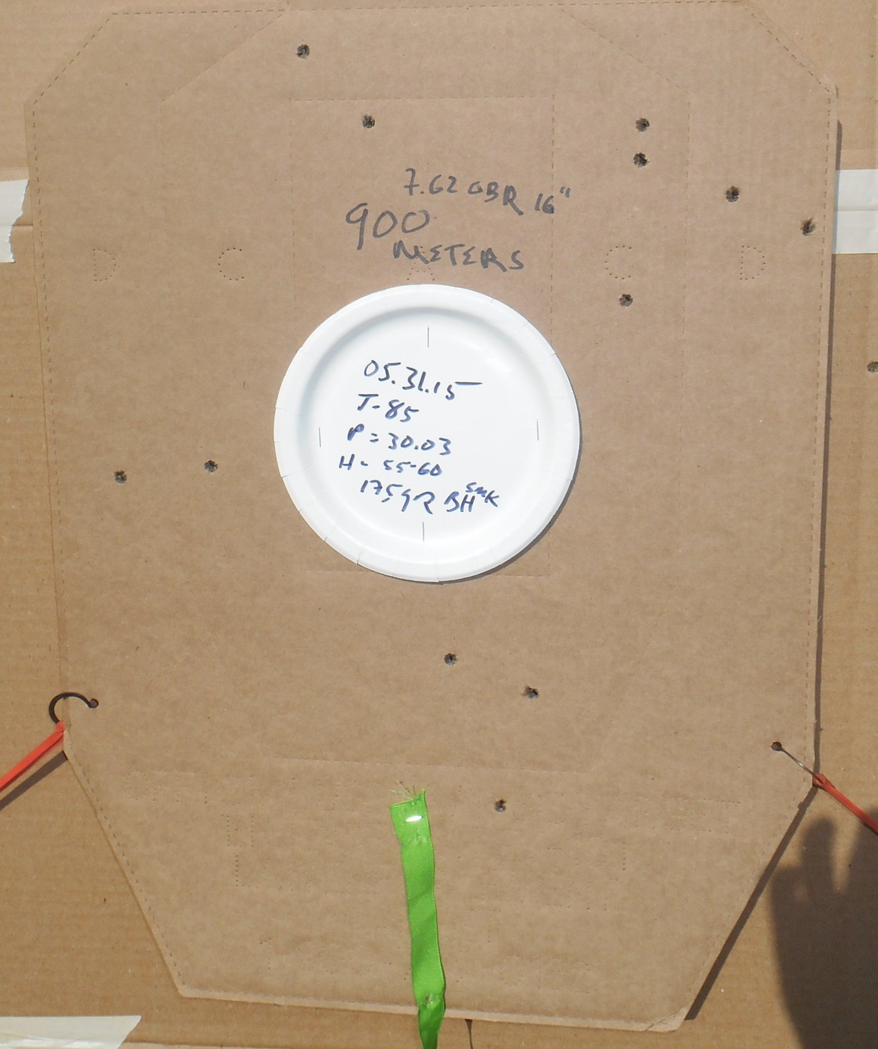

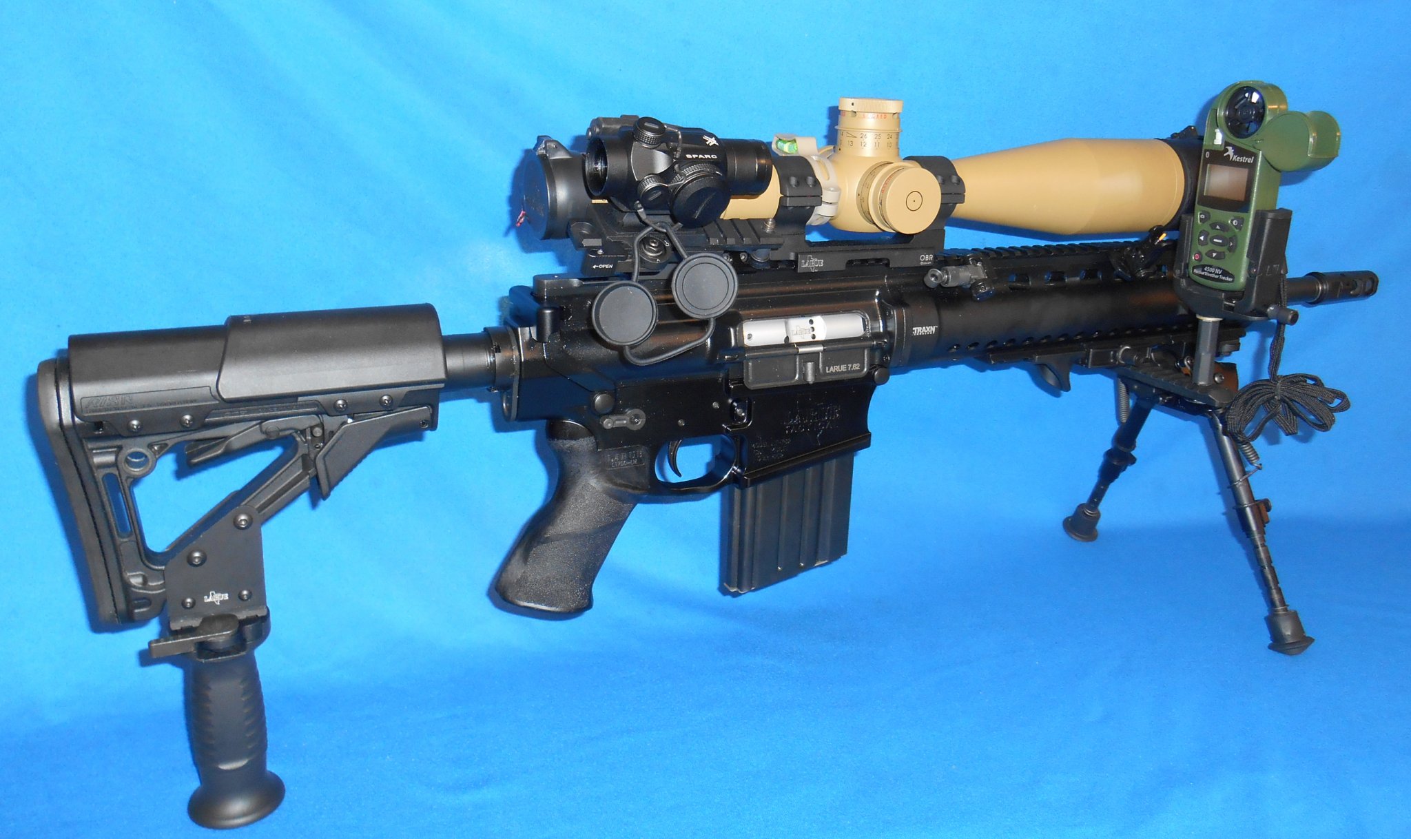

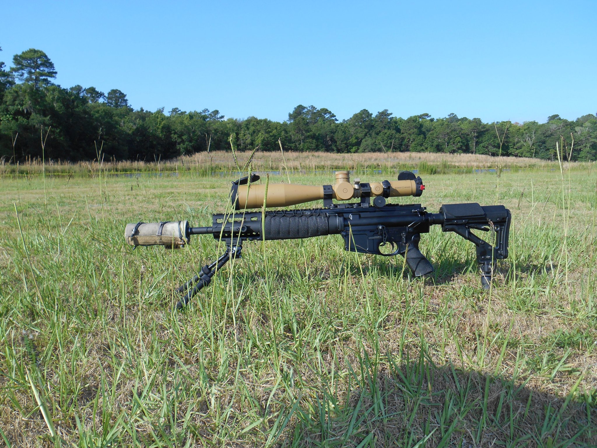

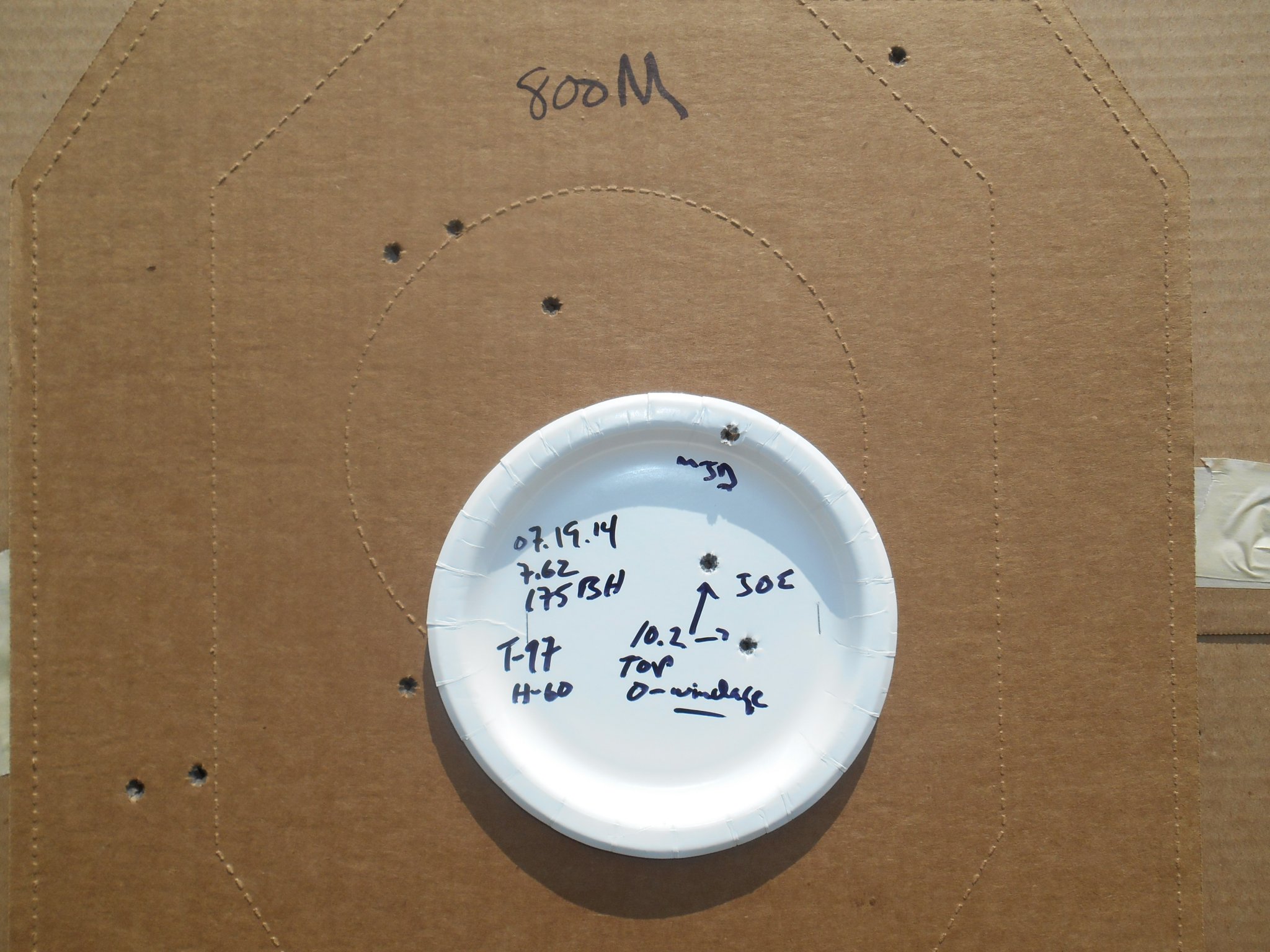

OP - Striking on target with an AR10 @ 1K yards employing a brand name QD mount (read get-off-your-wallet and buy a a respected mount as a few boxes of ammo will exceed cost of said mount) will be the least of your concerns as the bullet will most likely be transonic velocity at that range. I have 20+ LaRue mounts and a lot of DGI mounts holding mostly S&B up-to-date scopes with 24-56 mm objectives, separated in price by ~ $500; properly zeroed with good DOPE, the mount itself still the smallest variable in making my POI at that range with 16" 7.62's. The GDI's have nice accommodations for red dot optics. First round 800 - 900 M targets w/ 16" LaRue, reproducible velocity ammo and adequate scope. It has been my observation on forum posts is that the biggest bitch about LaRue's is "gouging" the picatinny rails with use, not return-to-zero issues; I haven't seen any evidence of it occurring in my use. The targets show results with Black Hills Match ammo, however Applied Ballistics 7.62 has demonstrated single digit muzzle velocity shot-to-shot variations ( using latest MagnetoSpeed chronometer data ) in this 7.62 platform.

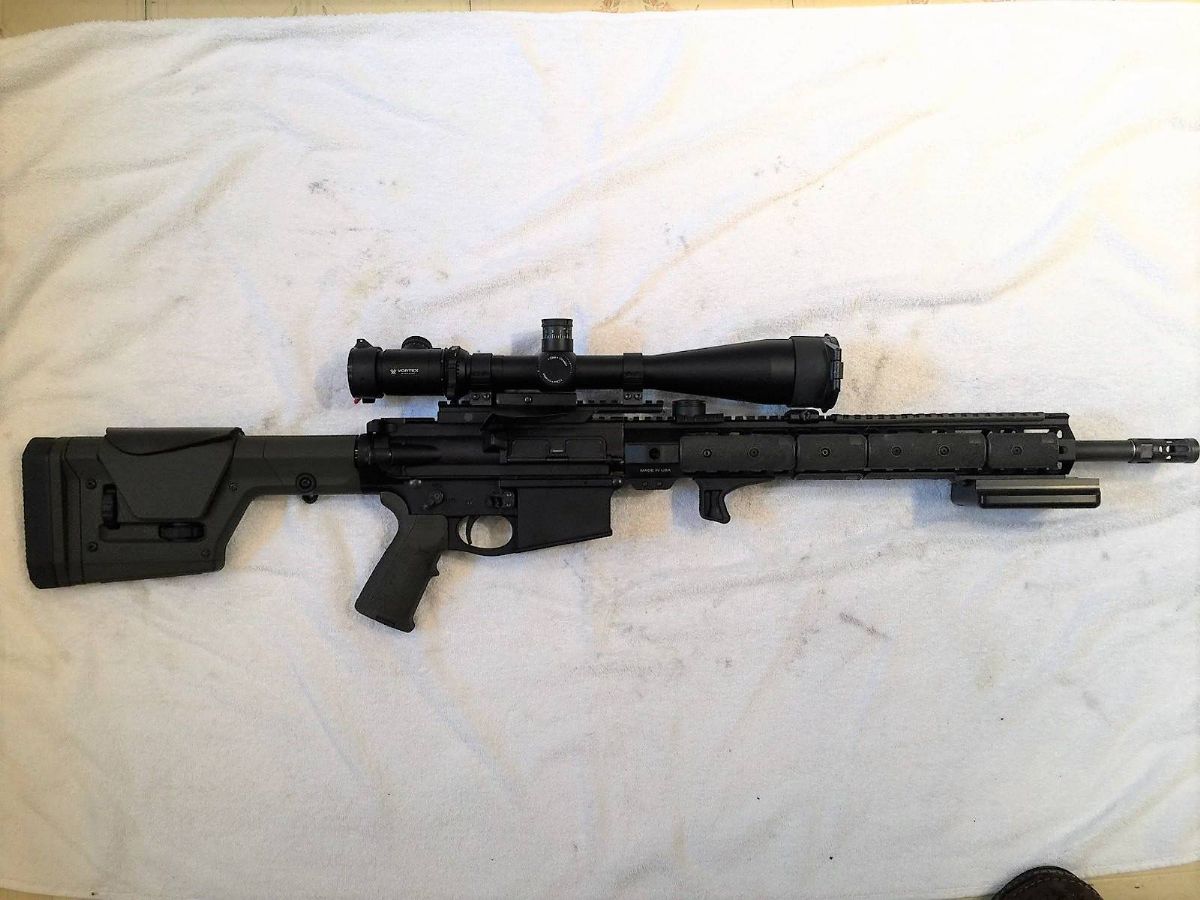

Thank you all for your input. I ended up with the Scalarworks LEAP standard height scope mount and an Atlas BT46-LW17 PSR bipod. I have yet to buy a 45 degree picatinny side mount and decide on a red dot, but I'll probably post pics of my completed build in the "308 AR10 Build Info/Picture Thread" on the Semi-Auto Rifles" board.
Update: The build is posted.
