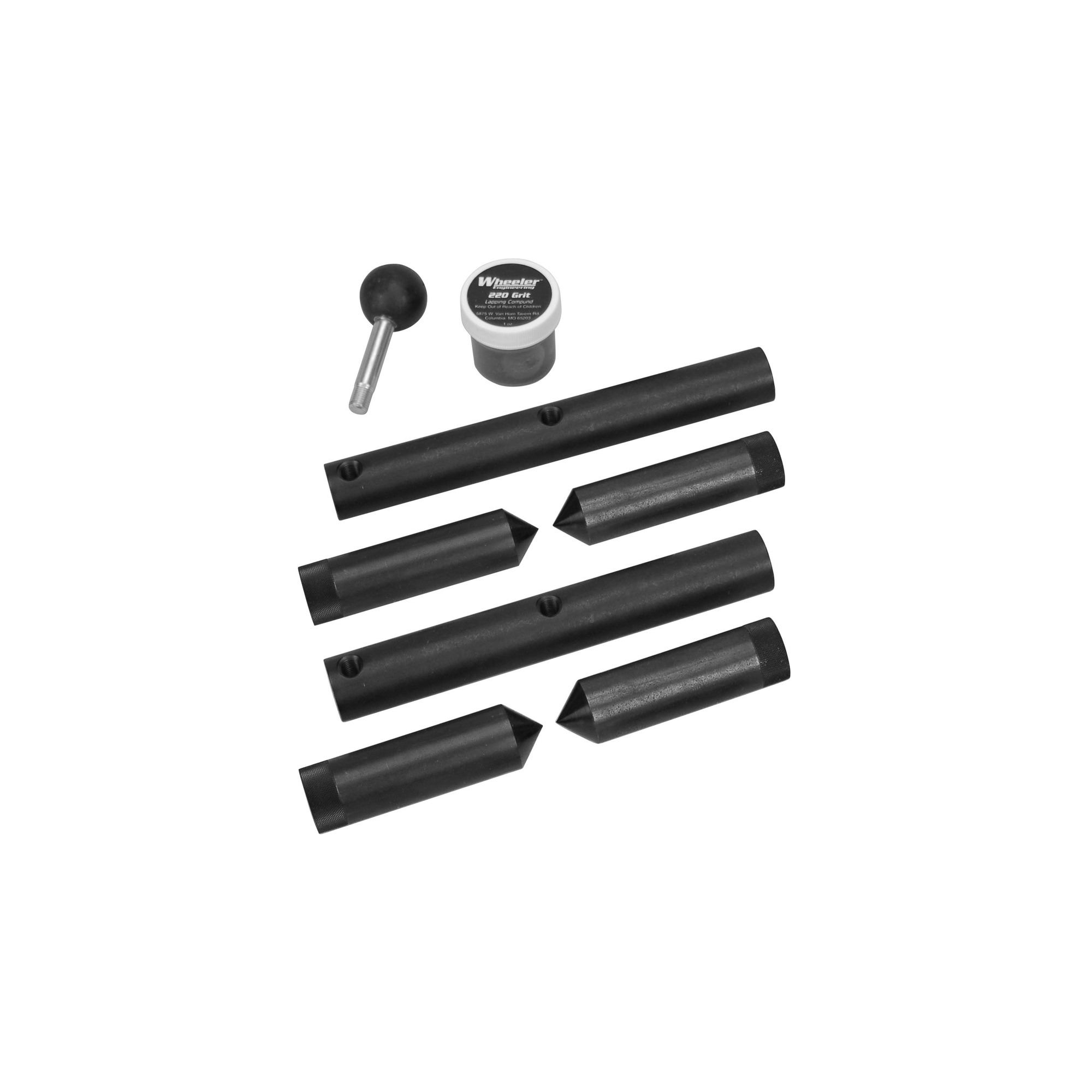

I use this device. There could be some surprises as to how far off the rings are once mounted to the weapon. A lot of things can change from the CNC machine to the 1,000 yard range.
_____________________
The Wheeler Engineering® Scope Ring and Lapping Kit Combo allows you to properly install a scope on a firearm. The alignment bars in this kit provide for perfect alignment of both rings and will also diagnose any misalignment problem, vertical or horizontal, giving you the opportunity to fix the problem before damaging the scope or experiencing frustration at the range.

I've never found a need to lap modern CNC cut rings/mounts from Seekins, NF, Badger, Spuhr, ARC which have all worked perfectly and I've owned multiples of each. I'd definitely try them out on your setup before you purchase any products for lapping.
