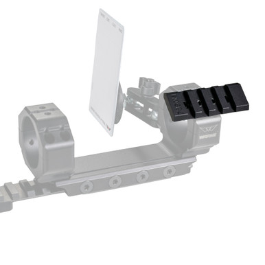

Rail mounts at 12:00 or 1:30.

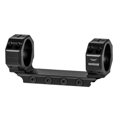

I like my Warne mounts as much as my MPA mounts.

The Badger C1 and some other similar mounts should have the option to add a picatinny rail section that replaces one of the top caps. Or the C1 has the accessory system that pins into the slots in the mount body that could mount a red dot off the left side, but I’m assuming you checked that out and it didn’t work?
Could you link to that? The only thing like that I've found is their "CLIF" and "ARC" combo, however together those would add about 3oz which gets me back up to the weight of the PEPR. Furthermore I think the rail height on the "CLIF" is a bit too high.
