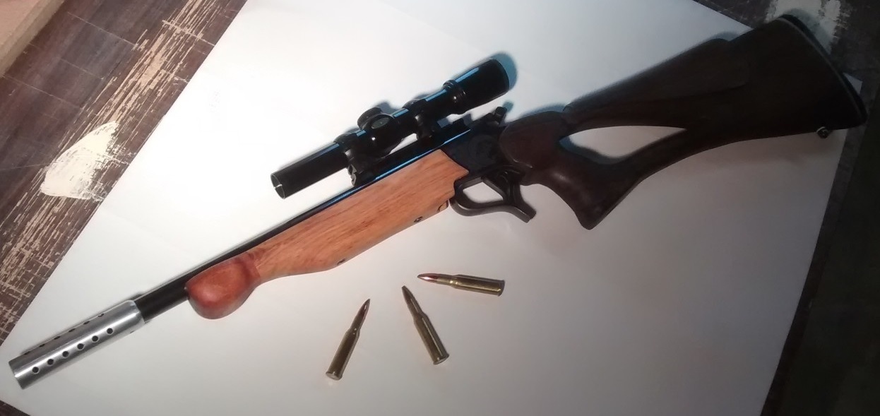

    Got a 'maximizer' by White on my 7mm Bellm Bbl and she shoots more accurately than I can hold!
