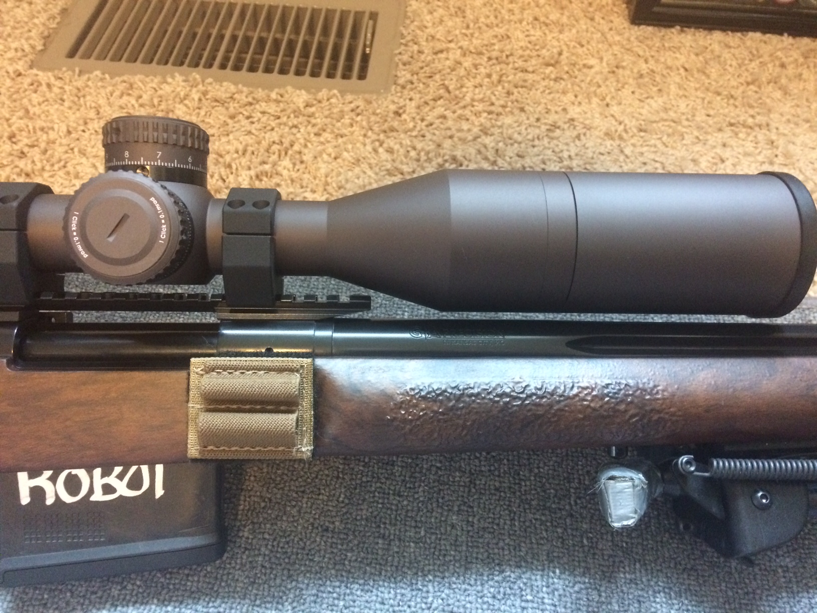

Looking for some advice on scope ring height. I have a Riton X5 with 34mm tube.
It will be mounted on a 20moa rail on a Tikka T3X Lite 6.5prc. I know it's probably sacrilegious but the scope will placed on a model 70 30-06 temporarily until my son's hunt is over. I already bought some Vortex PMS 1.26 rings but the scope is sitting high.
I want to get it as low as possible and prefer to keep with 1 set that I could use for both rifles.

Simply measure the distance from center of rings, where they split, to top of base (or bottom flat of rings). Should measure 1.26”. Then decide how much closer you can go before you are too close. Subtract the difference and you know how high you need to get.
For reference, the PMR rings go as low as 0.92”. That is 0.34” (11/32”) less than the ones you have now. There are three other heights that are in between those two.
The Riton a 50mm objective? Get 1" high rings. The .92" height will most likely work but depending on the mount height of the Tikka the 1" is a safe bet. Below is a pic of a 56mm objective scope in 1" high rings on a 20 MOA base with a barrel that is a heavier contour than yours.

Exactly thr type of response I was hoping for. Yes it's 50mm. Thanks for the advice.
