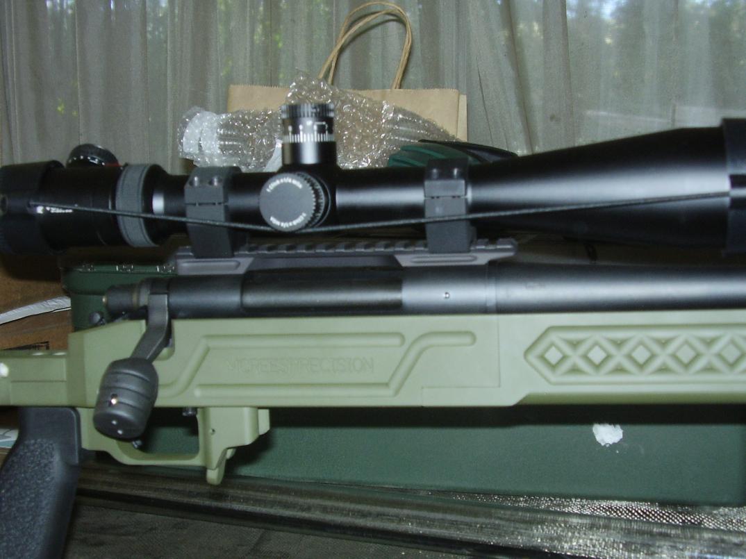

I have the same scope on my 700 using a Precision Armament 20moa rail and Vortex precision low rings. These are .87, so you should be GTG with low rings.

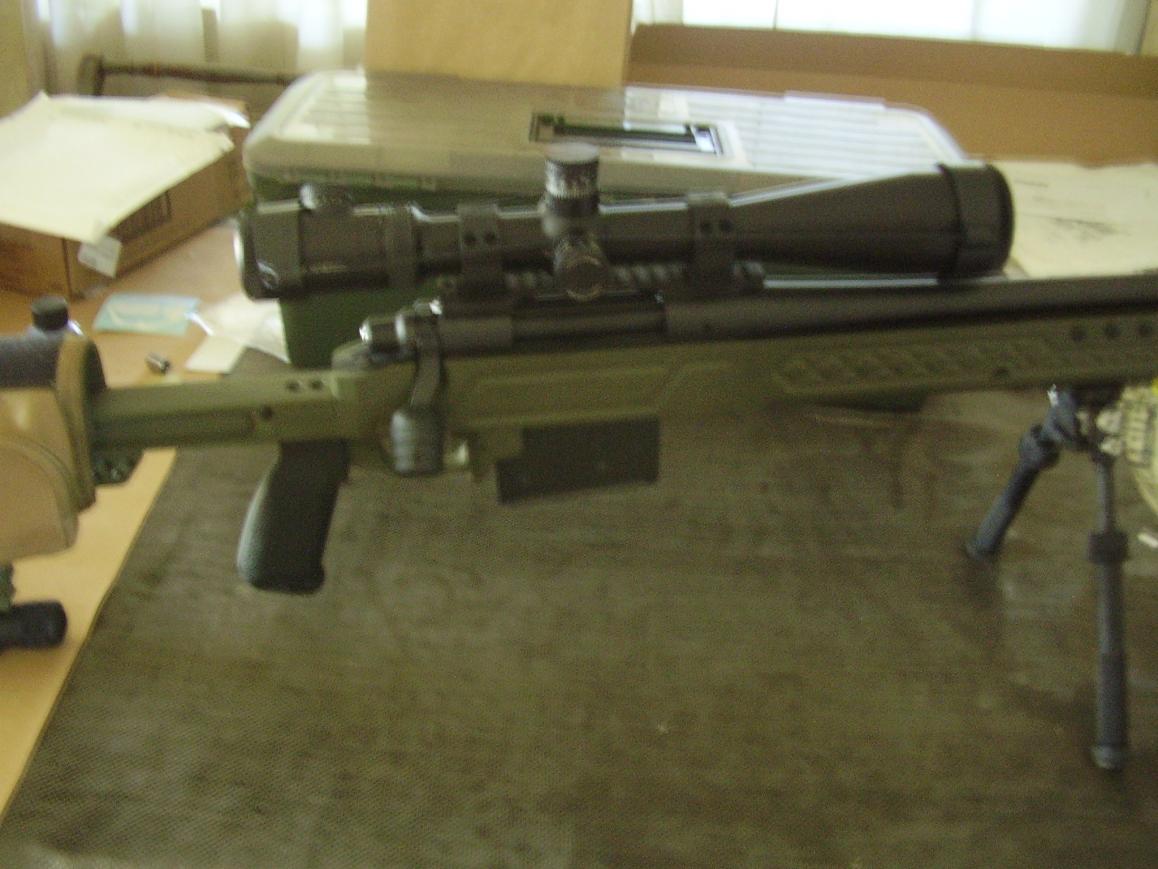

I have this exact scope and Griffin rings on a KRG chassis in this picture. I used the medium rings they offer on their website. I have an adjustable cheek piece so there is no issue with height, I also have a 20 moa base so it should give you an idea of how yours should sit.
http://www.snipershide.com/shooting/attachments/snipers-hide-bolt-action-rifles/1933d1363012318-krg-whiskey-3-chassis-lets-see-them-image.jpg
Oh perfect! That's the exact chassis I eventually want to get. Thanks to both of you for the pictures.
I recently put the same scope on my aac-sd with a 20moa EGW base and Burris low rings. Looks pretty much like the clearance Papa posted in his pic. Should still have room for lens caps.
