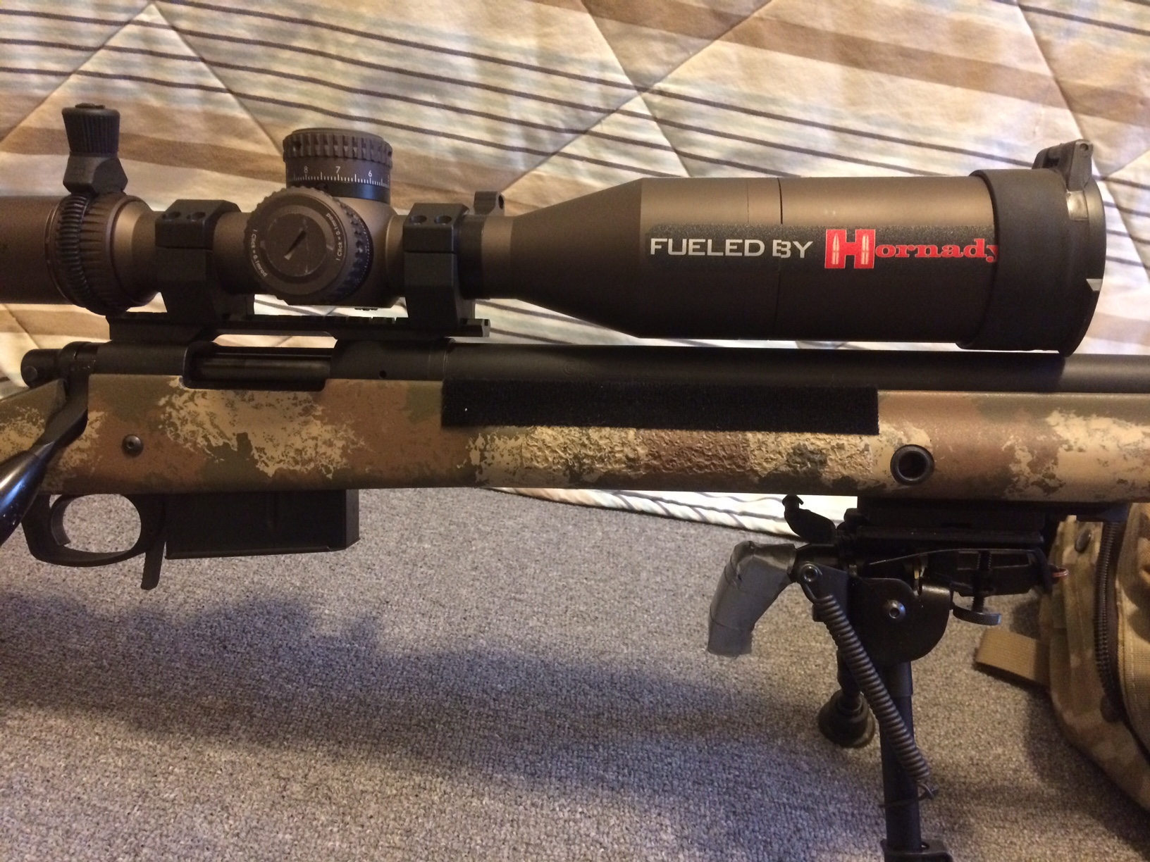

For that set up 1-1.2" height rings will work. I use 1" height with my 34mm tubed 56mm objective scopes. Here is a Rem700 with Seekins base and M24/40 contour barrel. Plenty of room between cap and barrel.
