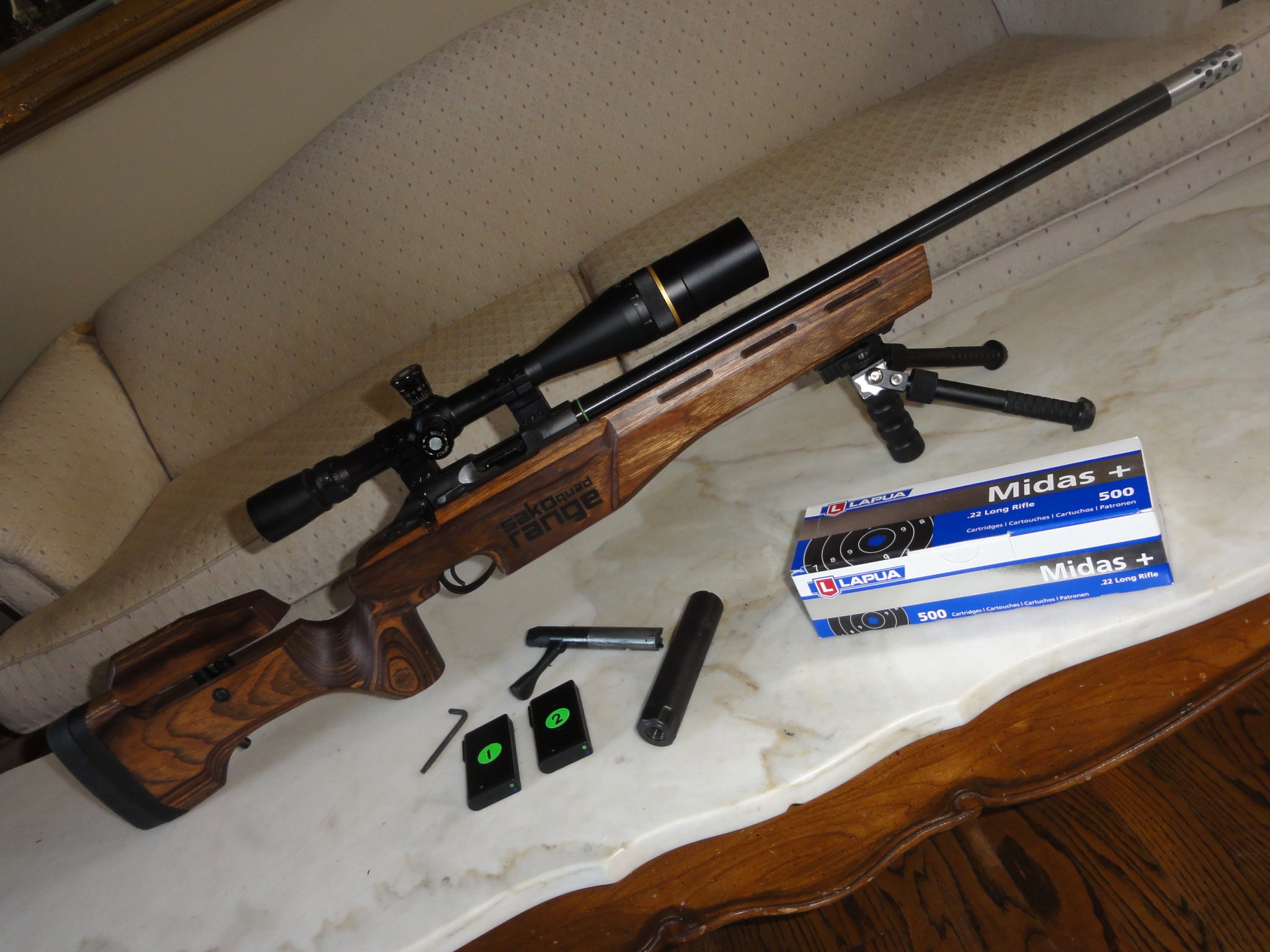

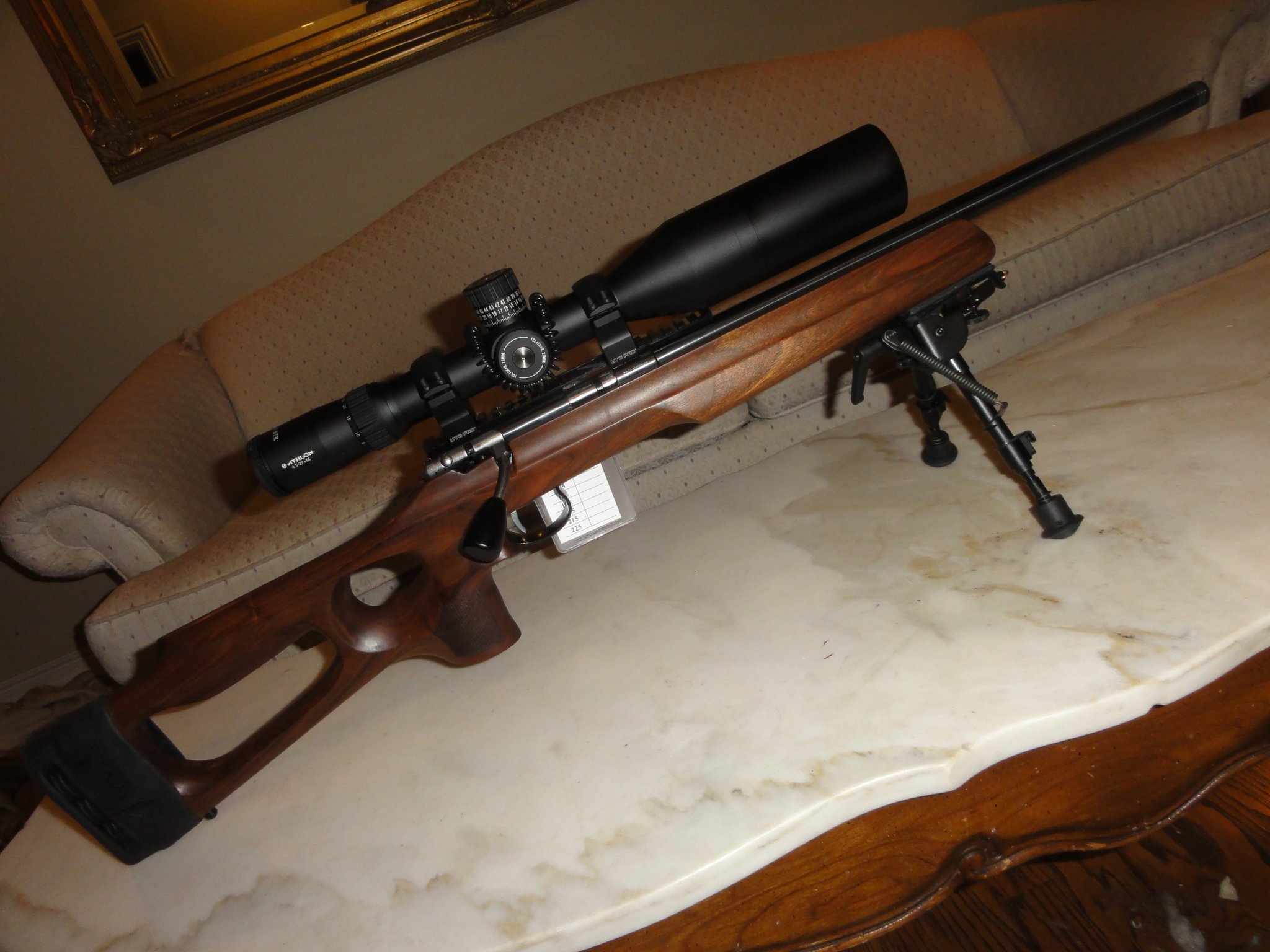

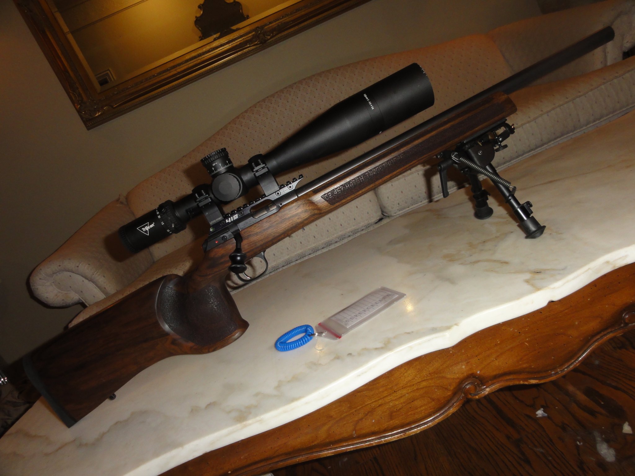

    Just a few of the toy's that I picked up in 2019. I have a Kimber on lay away for this year.
    The only one that has the wrong scope is the Sako Quad. She is sporting a temporary 6.5 x 20 EFR Leupold
    I just got her rail from AREA 419 yesterday. I buy those rails because they clamp onto the dove tails.
    I cant risk putting divots into the top of my receiver with the set screw type that DIP and Bscar have.
    Bob at DIP said to put number eight soft lead shot under the set screws to keep that from happening.
    I mention the lead shot to help others save their toy's. It's a good idea.
    Just my observations....

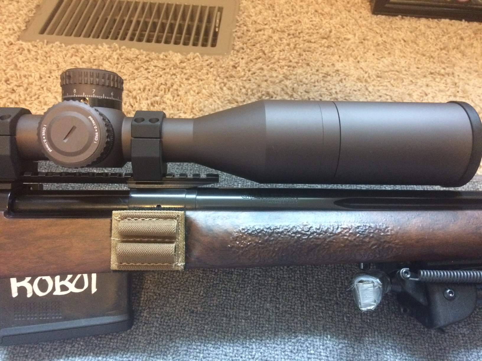

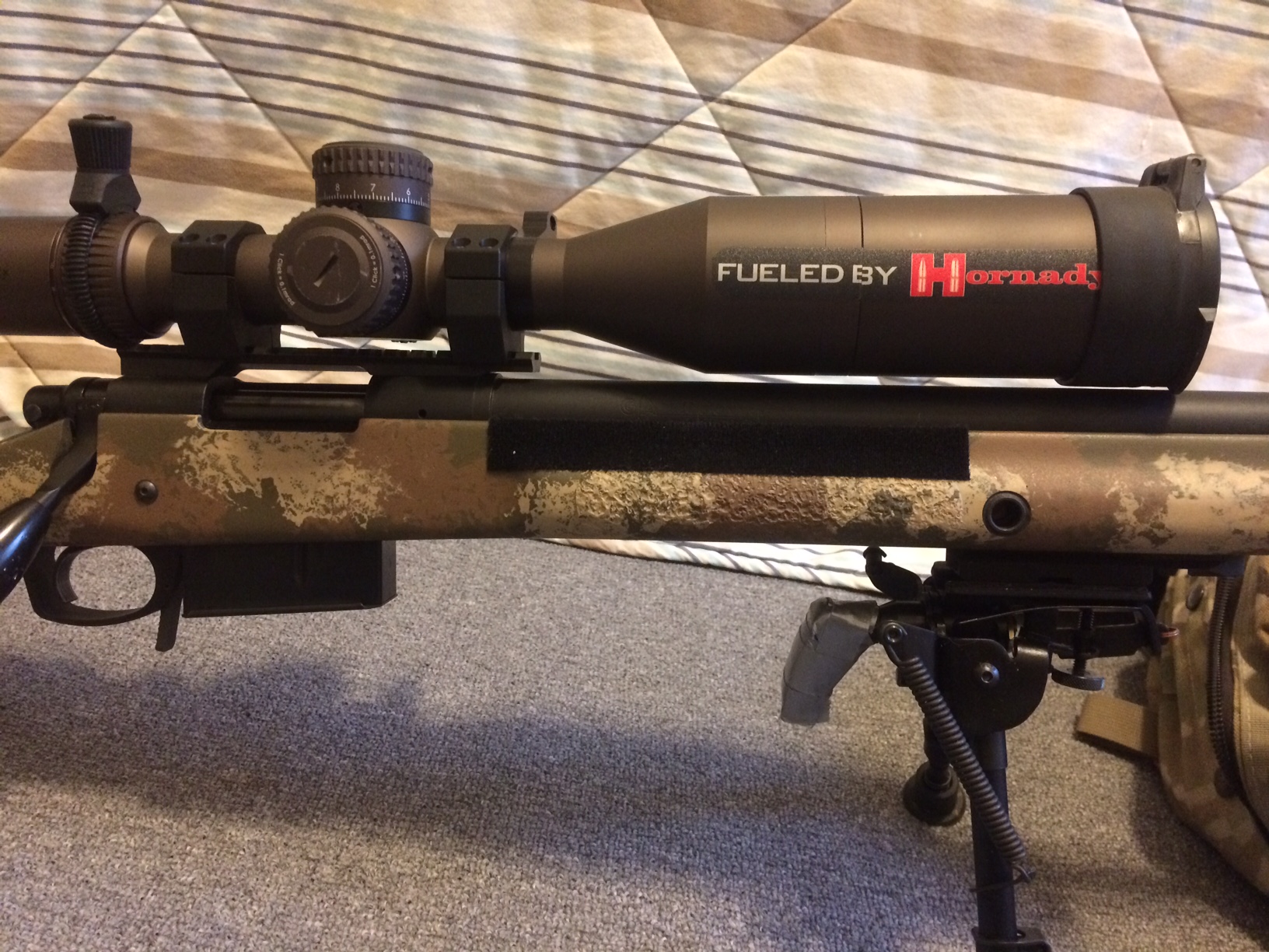

    I use 1" height with M24/40 contour and the Razor II on a Rem 700 with 20 MOA base. Here's a couple pics. 1.1" wouldn't hurt anything and give a little more room.

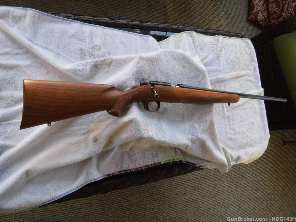

    Shawn
    View attachment 7245403View attachment 7245404
    Bighorn TL3 with the 20moa base.
    You should be fine with 1" but if you plan to MTU in the future 1.1" won't hurt. Vortex offers their Precision Matched rings made by Seekins in the 1.1" height.

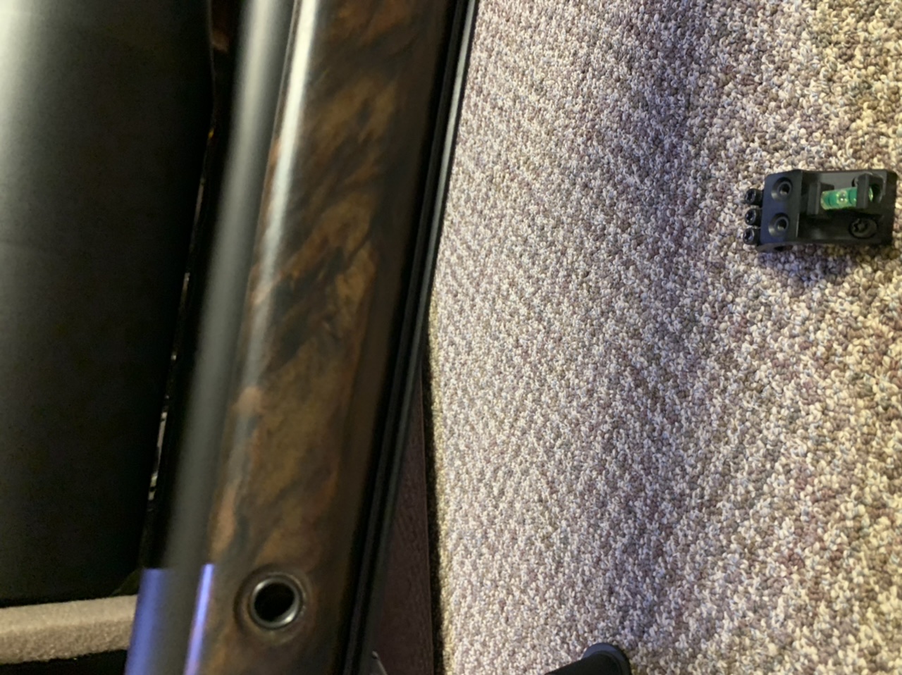

    I am about 5/8" above barrel with my scope. I bought what was suggested by by mount maker. I have no problems mounting my rifle. What I do have problems with is cant. I noticed while looking at 700 yard target my cant makes a huge difference. I am thinking scope height makes a difference, Started paying attention to the level bubble on the mount. It was difficult to transition after leveling. Also the bubble changed size often. Focus and old age. Got an improved level with a ceramic ball which was a bit better. Shooting buddy sold me on the electronic level which I can see while perfectly ready to shoot. All the levels have too much travel when "level". Just something more to consider.
