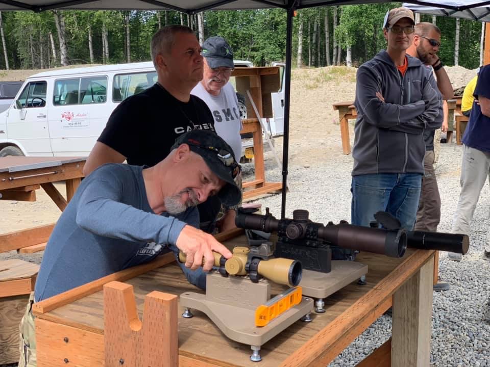

SHLowlight and I developed a tool just for this purpose. It is a heavy base that holds the scope, in its mount, during the scope tracking tests. At our advanced Course, PR2, we remove each student's scope and run it through a tracking test to 10 mils / 34.3 moa. The results are sometimes very surprising, and the student takes away a precise elevation adjustment, instead of an assumption.

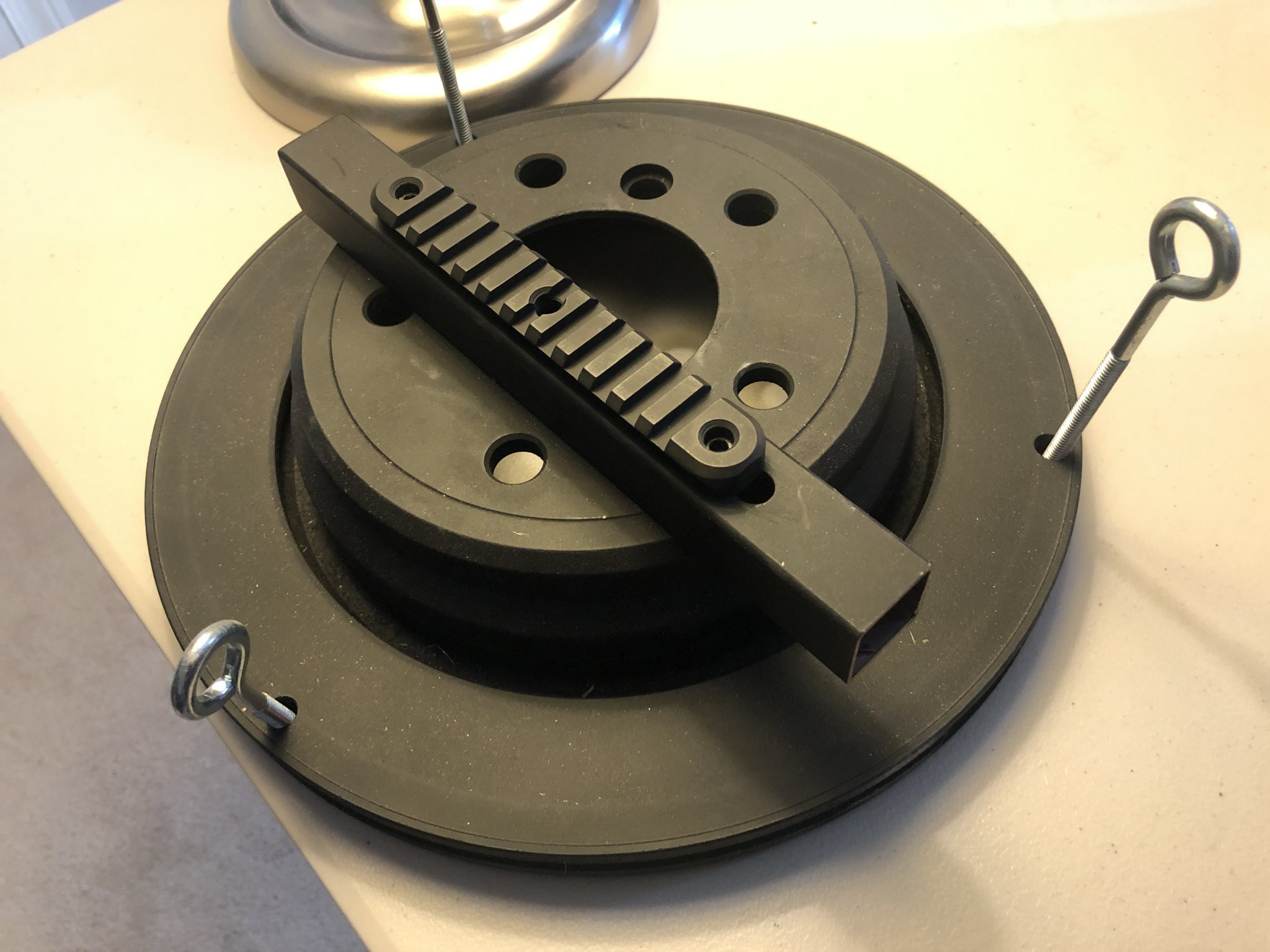

Here is a poor man's version I made with some scraps around the garage. Works great.
All custom I assume?
Yes. I just bolted some square tubing to an old brake rotor (because it is heavy), and drilled some holes and slots in the tubing that match up with an extra key slot pic rail from my AI. Then I threaded the eye bolts through the rotor for leveling. It took about 30-45 minutes and put some old junk to good use.
Some great ideas there. Thanks
