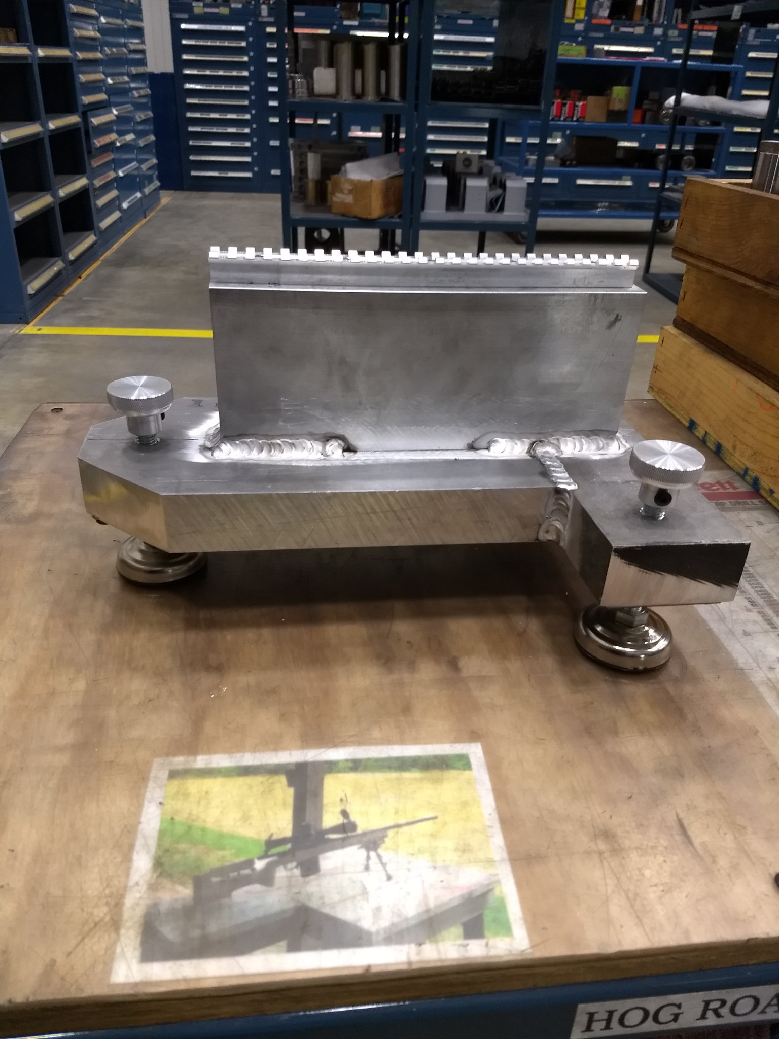

    Just wanted to show the scope tracking fixture I made. I have about 30 bucks into it and it works fine.
    Anyone else make one they want to show?

    Didn't make to sell, just wanted to show what I made and see if anyone had a better idea or and criticism of the fixture.

    Just milled the cross slots, got the blank from Brownells

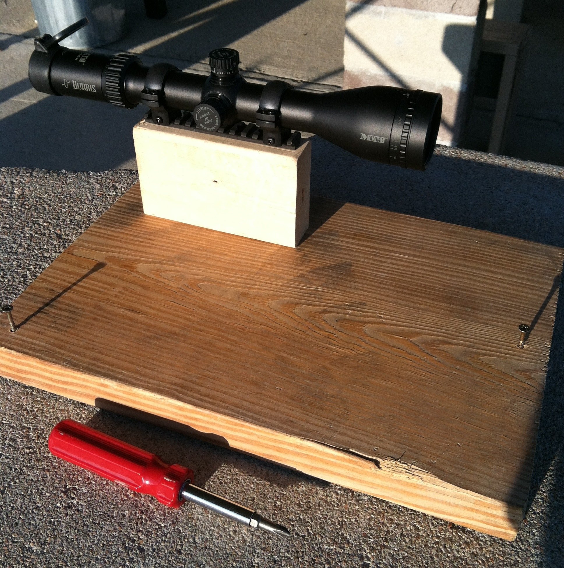

    That looks like a nice fixture. I made something like that out of wood several years ago that basically does the job, but yours looks more solid. Thanks for sharing. -- Todd

    I've been looking into making these for sale. Milled components, will be a lot more than $30, but nice. We sell scope bundles with levers/levels installed and it would be good for that and testing!
    Most of the material was from the scrap bin at work, feet I got on line for 10 bucks, rail I got from Brownells and milled the cross slots in it. I'm just lucky I work in a nice shop that allows us to do little government projects like this. I could have done a nicer job but figured why. It's a tool not art work.
    What’s it weigh? It’s got to be heavy enough not to move when operating turrets. Or at least clamped down somehow once you dial it in.
    It go 24.2 pounds, the rubber feet keep it in place and heavy enough that it doesn't move around.
    Right on. As long as it doesn’t move. Looks like a great design.
    I tried a few different methods and in the end I came back from circle to using killswitch’s design with the I beam for weight. Probably didn’t need 80 lbs but it’s what was available at the time and that sucker does not move at all...
