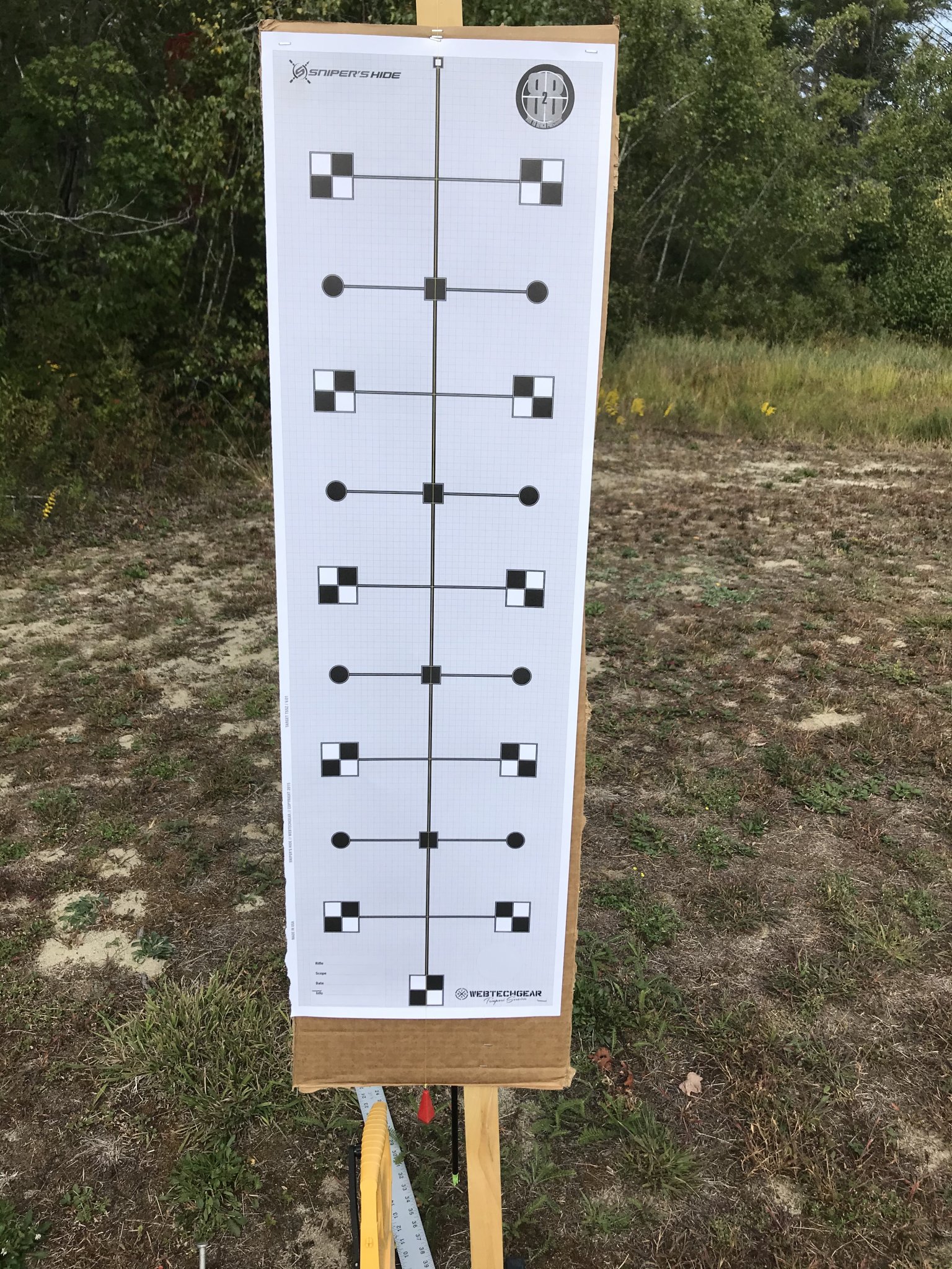

So I used a Hide Tall Target and the Hide weighted Picatinny “Scope Tracker”. @ 100 yards I’ve got a scope that’s tracking right on the money until about 8 Mils. At 8 Mils It’s about .3 off. I don’t want to get into brands and models... lets just say its not a budget scope. Is this a normal “tracking error”? Return to zero and left / right are more limited given both the target and available windage.
UPDATE 9/14/2020
I measured out 300 feet (100 yards) with a tape measure.
My Gunwerks BR2500 ranged it at 103 yards.
I used my Gen 2 Plumb Bob which can be seen in the first picture. Leftover arrow shaft, nocks and yellow braided fishing line with a 1/2 oz weight on the bottom. Previous version was inner line from 550 cord and a knife.
Set the target up and leveled it with the plumb bob.
Took a while to get the scope tracking tool to line the reticle up with the target as I was using a big rock. If someone say this rock doesn’t provide enough stability I’m going to loose it.
Results:
- The scope checked out lining up on the correct elevation for the 10 Mils tracked on the target.
- The “graduations” on the scope don’t line up “in line” so that may have added to the confusion yesterday (Will try to get a picture of this... the ‘0’ lines up with the ‘I” on the scope but when dialing numbers the actual amount dialed is to the ’left’ of the scope indicator. This is a replacement elevation cap as Nightforce said in the manual to do 10 inch pounds on the OUTSIDE turret screws... this stripped the original when using a torque wrench. When I talked to them they acknowledged this had happened a few times and to only do it “snuggish”.
I checked it several times up and down, dialing the full elevation and back and forth and it lined up and returned to zero every time. I guess yesterday was user error... Thanks for all the help folks and words of encouragement.

A very expensive one. I’ll try running the test again. I know the yardage was on, the target was plumb and all other ”Mils” tracked on the target... I just got setup to check the tracking and “take the shooter“ out of it.
Anything more than 1/10 off at 8 mils is unacceptable to me. I'd send it back if you confirm that it truly is 3/10 off at only 8 mils.
Agree with the above; .3 off seems a bit too high for just 8 mils of adjustment. I’d call the manufacturer tomorrow and get a return service order started.
If it’s a top tier scope, I’m sure the maker will get things right for you (just a guess given you aren’t disclosing the scope manufacturer). Hopefully it’s someone with a State-side service center.

Without.... using this: http://www.targetsusa.com/scope-tools.html and the Hide’s tall target.
Interesting tool. I had not seen those before. Did you measure the actual tall target hash marks to make sure that the target itself is spot on and there was not a printing error that slightly changed the proportions of the target graphic? This is probably unlikely, but it wouldn't take much time to just confirm.
I’ll double check it, guess anything is possible.

To answer the question about it being an out of scale target... target is spot on when measured. The .1 of a mil white ”aiming box” at the top of the target to the dead center is 36” exactly (10 Mils)
Yeah, I thought it was unlikely but the thought popped into my head. When you send it in after your course I'm sure the manufacturer will get you squared away.
Reactions: USMC22
What is the measured value at 1, 2, 3, 4, 5, 6, 7, 8, 9, 10 MILs?

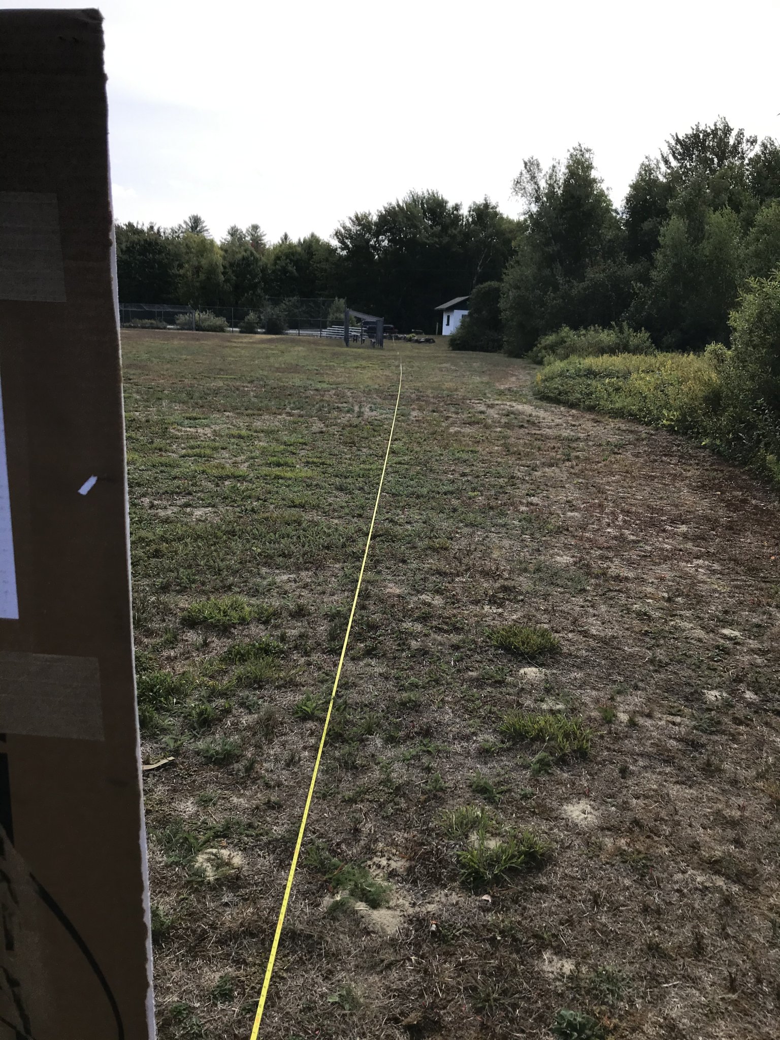

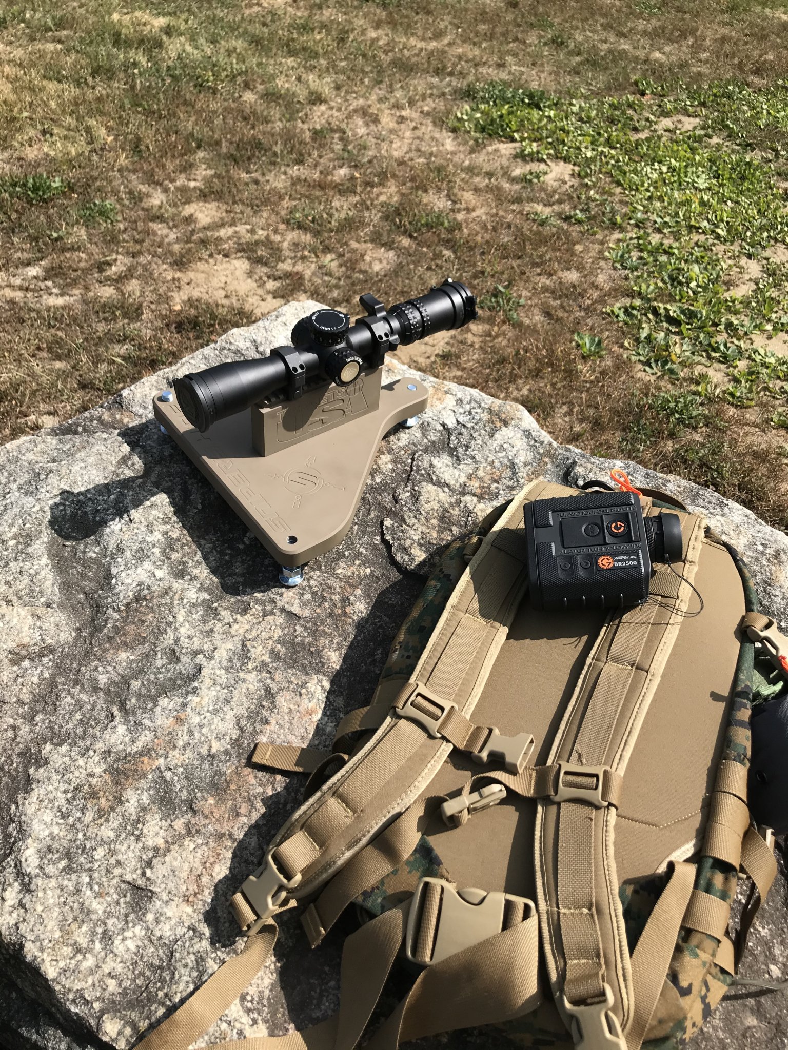

UPDATE 9/14/2020

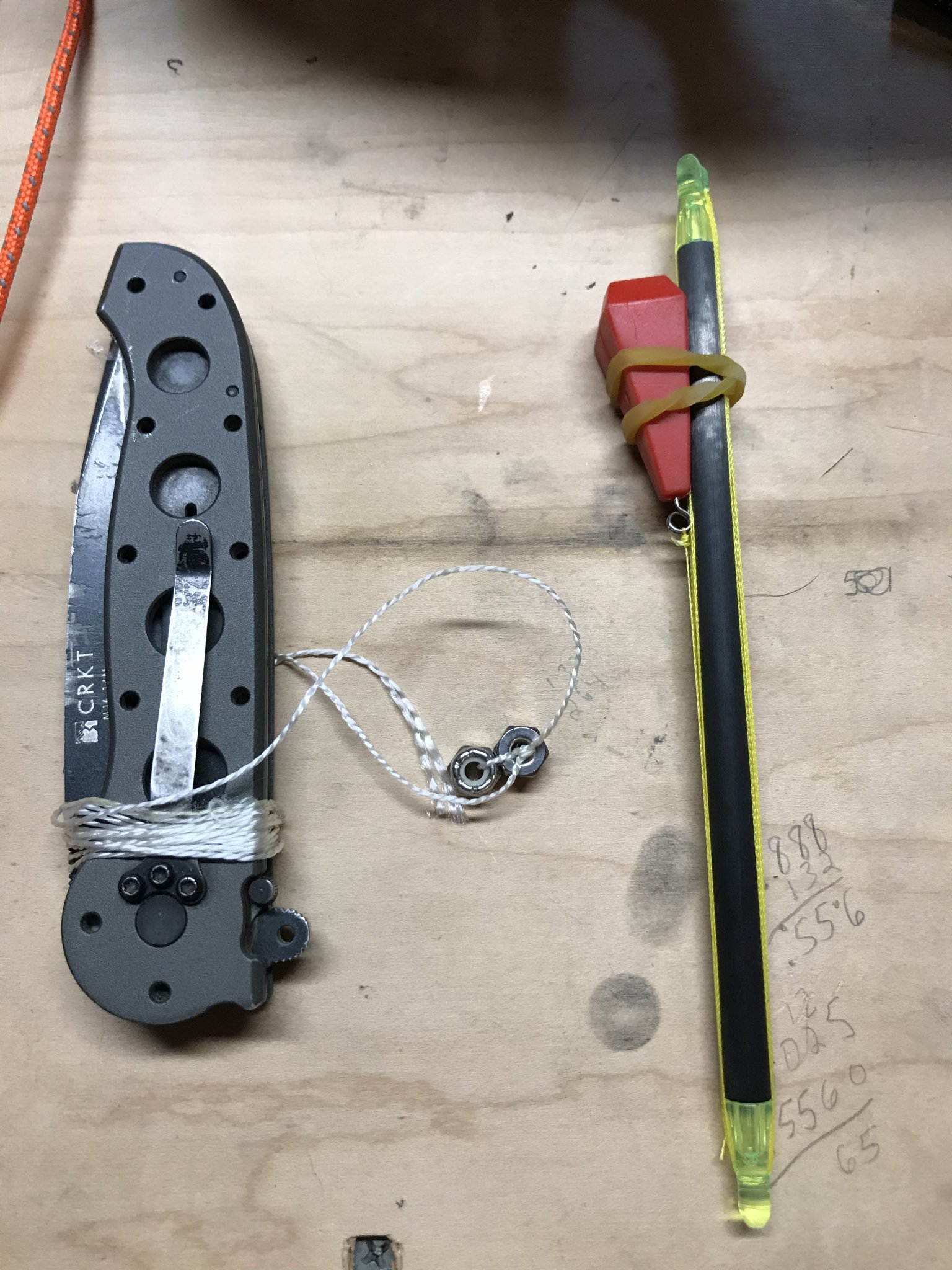

Results:

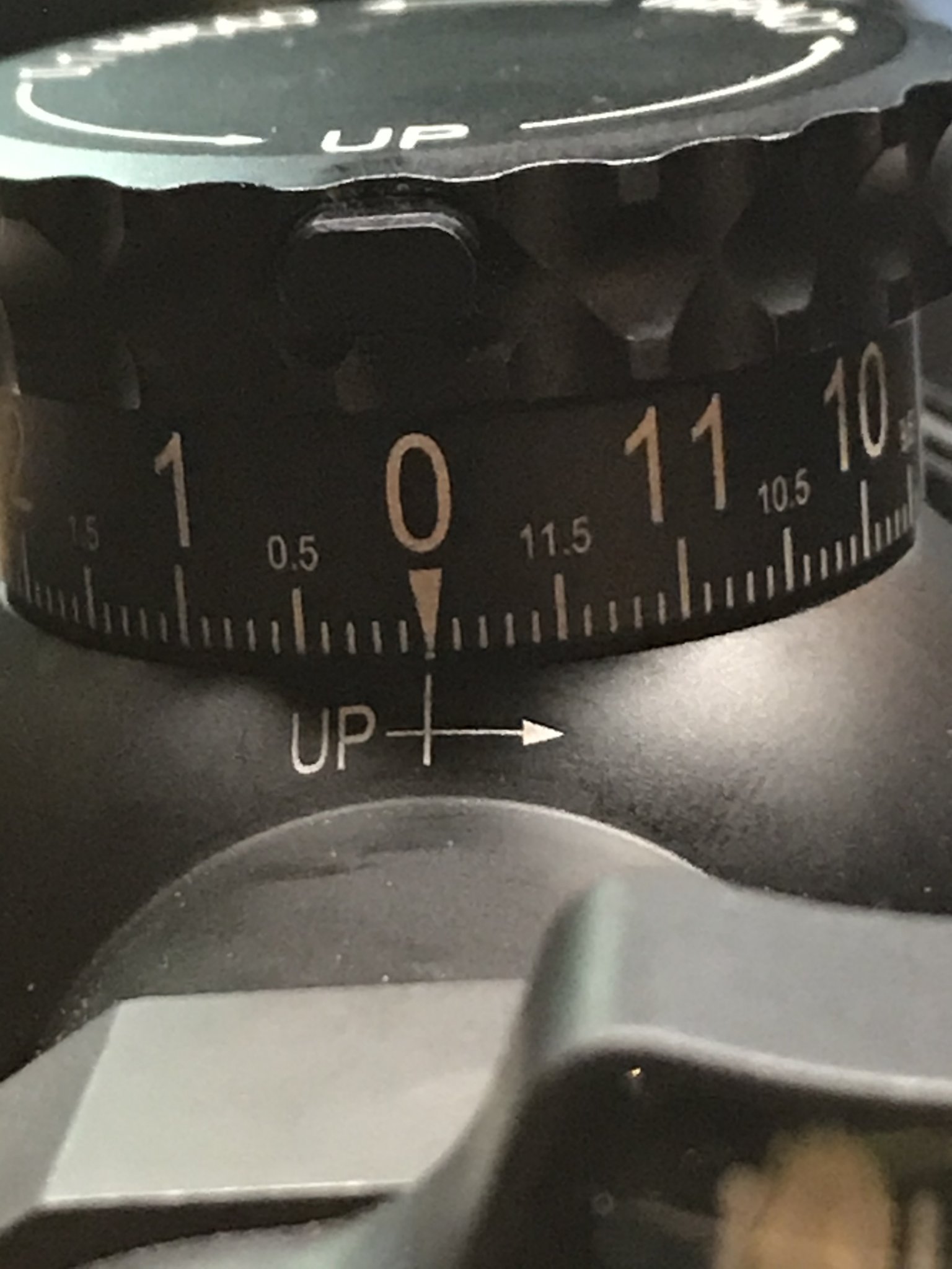

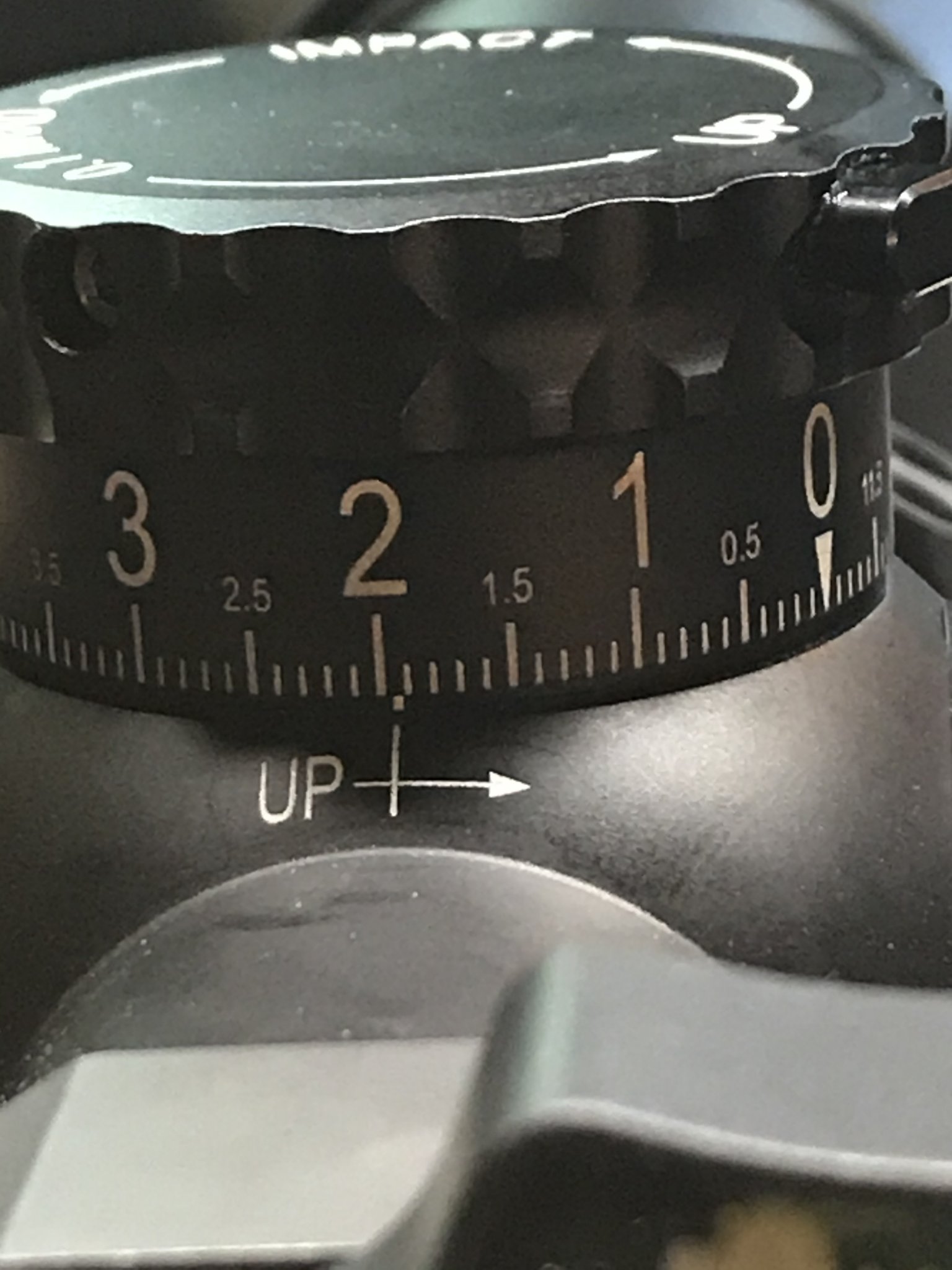

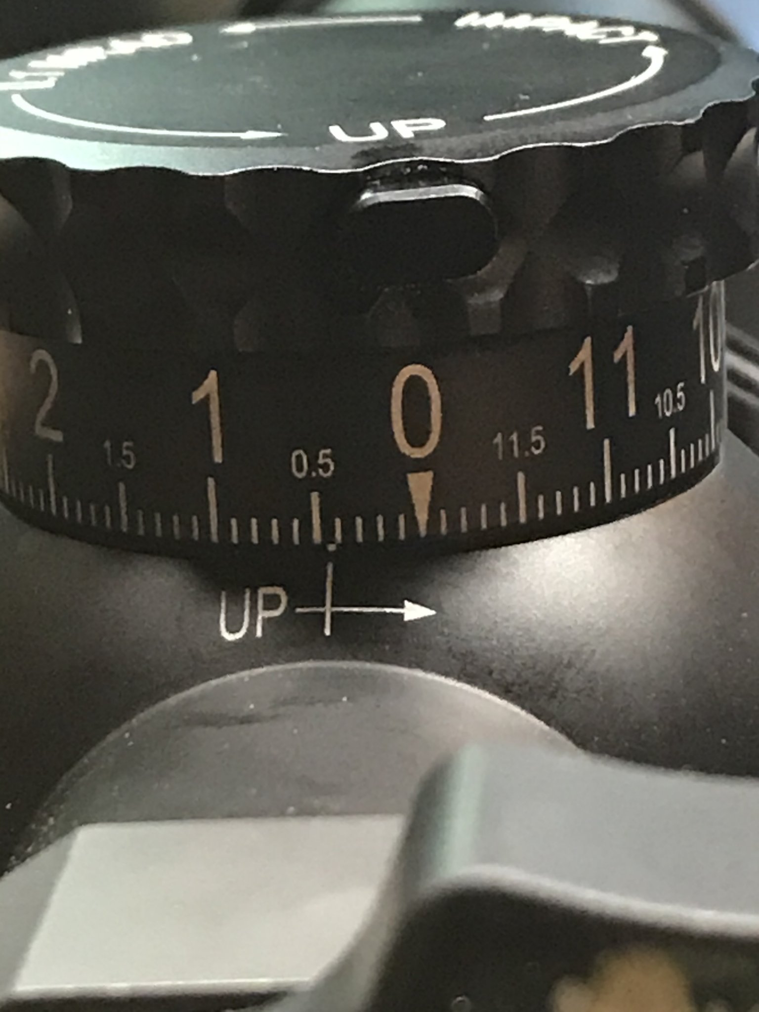

Scope graduation marks I did a horrible job explaining.

I think you did yourself a big favor by rechecking your results rather than jumping off the cliff. A little needed scope correction factor would be fairly normal but .3 seems like a lot. Nightforce seems to be among the best at tracking. Really glad you got it sorted out prior to your training class you don't need to be focused on this type of error when you are trying to learn something new.
Maybe you could try to zero the turret with the arrow a bit more left leaning on the line to make this error a bit smaller? But as long as the deviation is consistent it's nothing tragic, only annoying.
It is consistent. Just something I’m going to have to pay attention / keep track of. It’s got a “button” that locks into “zero” and allows you to dial below zero so there isn’t really any room for the Kentucky windage so to speak as went tightening it up it kind centers in that “locking point”

i had this problem with a high end scope, sent the scope back several times. Tried everything, when you get past a certain distance if a scope has a flaw you will find it. Try another scope
It is easy to make mistakes doing scope tracking tests. The test target distance has to be very close to perfect or you will get erroneous results. Frank spoke about this a month or so ago in one of his podcasts. The fellow who set up the test target at their class used a rangefinder that turned out to be off by a few yards and they were getting 3% errors on adjustment size scope after scope because being off 3yds in 100 yards is a 3% error. For my part, each year when I first set up the test target for scope reviews I measure the distance twice with the measuring tape and then verify it on a previously tested scope. I then mark the placement in the grass with paint which I refresh every few weeks all year so I don't have to measure it again that year.
As for the dials not lining up. Some scope makers seem to have issues with this. Users seem split on whether to be enraged by this or to not care at all. For my part I probably wouldn't care much at $1k if the scope was otherwise a good performer and would be quite unimpressed at $3k. 10inch/lbs does seem like a lot for the little set screws most scope makers use. You really do have to be gentle with those things while understanding that if your too gentle, the turret will slip and loose zero. It is a feel thing and is really more touchy than it should be.
@BigJimFish check out the leica disto laser tape
1/62" accuracy at over 300' should get you there easier than pulling 300' tape out frequently
Some models also have camera with cross hair so you don't even need to be able to see the laser to get distance
