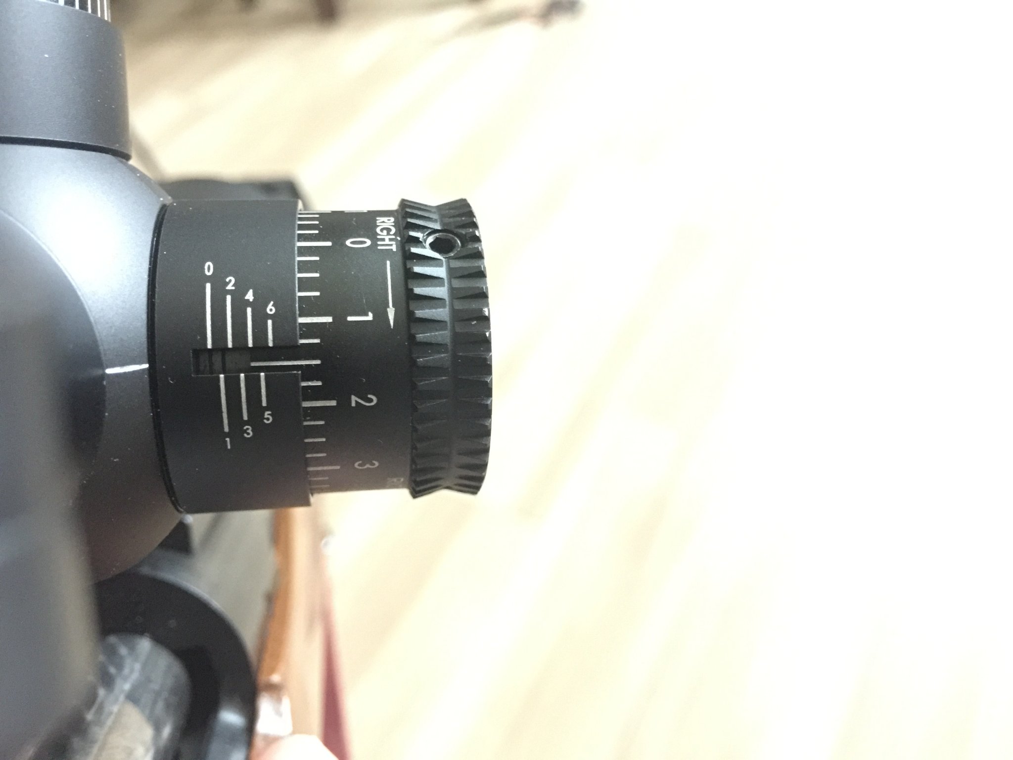

*- I go to reposition the windage turret to the “zero” mark & realize that sadly, something is catiwompus...
*- First, remember that new Vortex scopes are (presumed) to arrive tuned to “optical center”; I did not take note of where the turrets rested when I began my zeroing process.
- The number of windage adjustments that I made on the turret before reaching windage “zero” was roughly 10-12 - 1/4-MOA / clicks - or roughly 2 - 2 1/2 inches at 100-yds.
- When I loosened the turret screws on the windage turret to reposition the turret knob to the “zero” position, I realized that the markings on the windage turret FINAL position had the “zero” line on the turret lined up to position 5 on the shroud; in effect, I have maybe ONE full rotation of right windage, & maybe 4-5 full rotations of left windage... it’s not even close to being positioned to allow for relatively even right / left windage adjustment?!
*- I called Vortex & was told that the finite imperfections that are inherent in assembling any rifle - particularly in a rifle with the performance expectations of an LRPS rifle - can cause such “discrepancies” that a (new Vortex) scope might require excessive adjustment in order to achieve ZERO... Really, is that normal or true?
*- The thing is, I ONLY made 10-12 clicks of windage adjustment to the turret before I was at zero?! Now way 10-12 clicks at 1/4 MOA takes a windage turret from “Optically centered” (between 2-3 on the turret shroud) clear out to 5 on the shroud where there’s maybe one full rotation to the right, but 3x that to the left?!
?? - Is any of this making sense at all?
Dude at Vortex suggested I order some “windage adjustable rings”...
Another dude I met felt like if there was enough wind to require a full right rotation, then the wind is going to be too strong to make a precision shot (at 700-yds plus? 500-yds?)
Someone PLEASE tell me if I need to throw some cash at this problem (for windage adjustable rings), if I can justify the knowledge that for now, I’ll only have one full rotation of right windage, or quit being a pussy & learn to use hold-over marks?

"I ONLY made 10-12 clicks of windage adjustment to the turret before I was at zero"

I have about 70 1/4-MOA adjustments for RIGHT windage, & about 207 1/4-MOA adjustments for LEFT windage...
Something is clearly Catiwompus with my windage turret & / or “optical center”...
F. ¥. €. |<. ! ! !

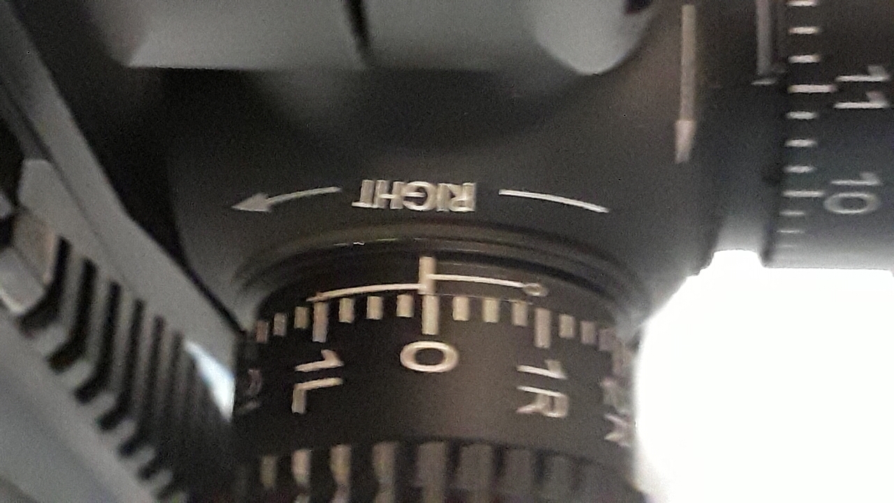

I had this issue with a factory Remington rifle. Bought a set of leupold windage adjustable rings. No more issue. I hold for wind, but the reticle was so far out of center that I couldn’t get a circular image- there was always some shadowing.
Sounds exactly like what I’m dealing with... did you dial both windage & elevation back to optical / mechanical “zero” before you re-mounted your optic & began tweaking the windage adjustment via the rings?
Reactions: Snuby642
Yes, and while not perfect, it is substantially better than it was...

Based on how far off my windage adjustments are - Right (70 +/-) adjustments vs left (170) - it’s starting to sound like those Leopold windage adjustable rings might be my only best option... Such a drastic discrepancy in windage adjustments on what is meant to be a long-range PRECISION rifle is unacceptable... at least by my standards.
Reactions: Snuby642
My results were much better with a vortex strike eagle 4x24x50.
Moa scope 3 clicks from center on my 6.5g upper.
Tried for a picture but it is just touching the third (middle) band.
So I got lucky on barrel / reciever mount and scope first try.
Wish they all lined up that easy.
Edit: being an entire rotation out would drive me to drink.
Angles suck for photos. Mine‘s about 1/2 a rev off. Close enough that the image is round and not oblong. From where I started it is a huge improvement. And, I’m holding for wind most of the time so I rarely look at the windage turret- I didn’t even zero out the turret after I zeroed the scope.
1/2 rev is fine picture made it look like 1 plus to me.
Since it only takes one minute to zero why would you not.
Even if you never dial wind that would let you see if it got bumped / turned by accident or in my case a grandson in gunsmith training.
