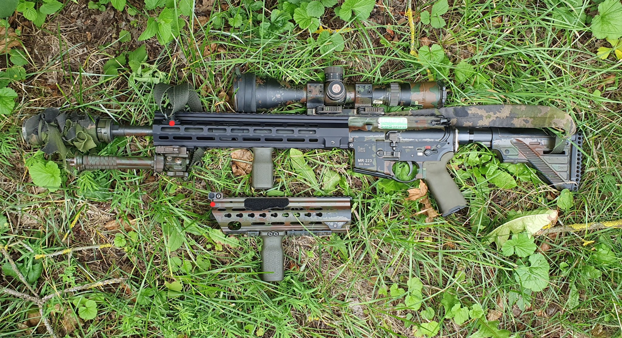

    Here is a photo how the current and old sling setups are, sling mounting position are marked with a red dot below it.

    I use a Viking Tactics Quick Adjust sling attached to the end of the hand guard and receiver plate (MR223 as well). For me that seemed like the best solution. Easy to pull it tight on your body and very easy to give it some slack or some more tension for stabilising.

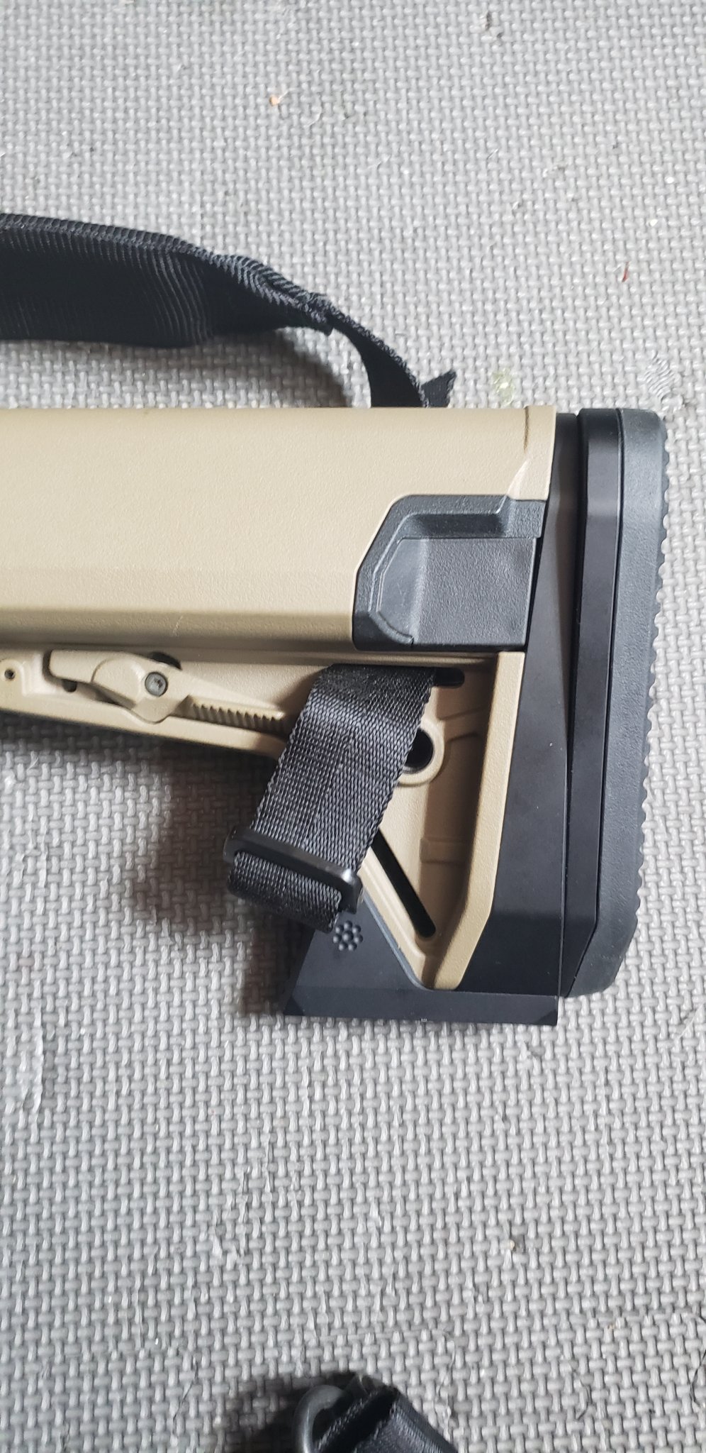

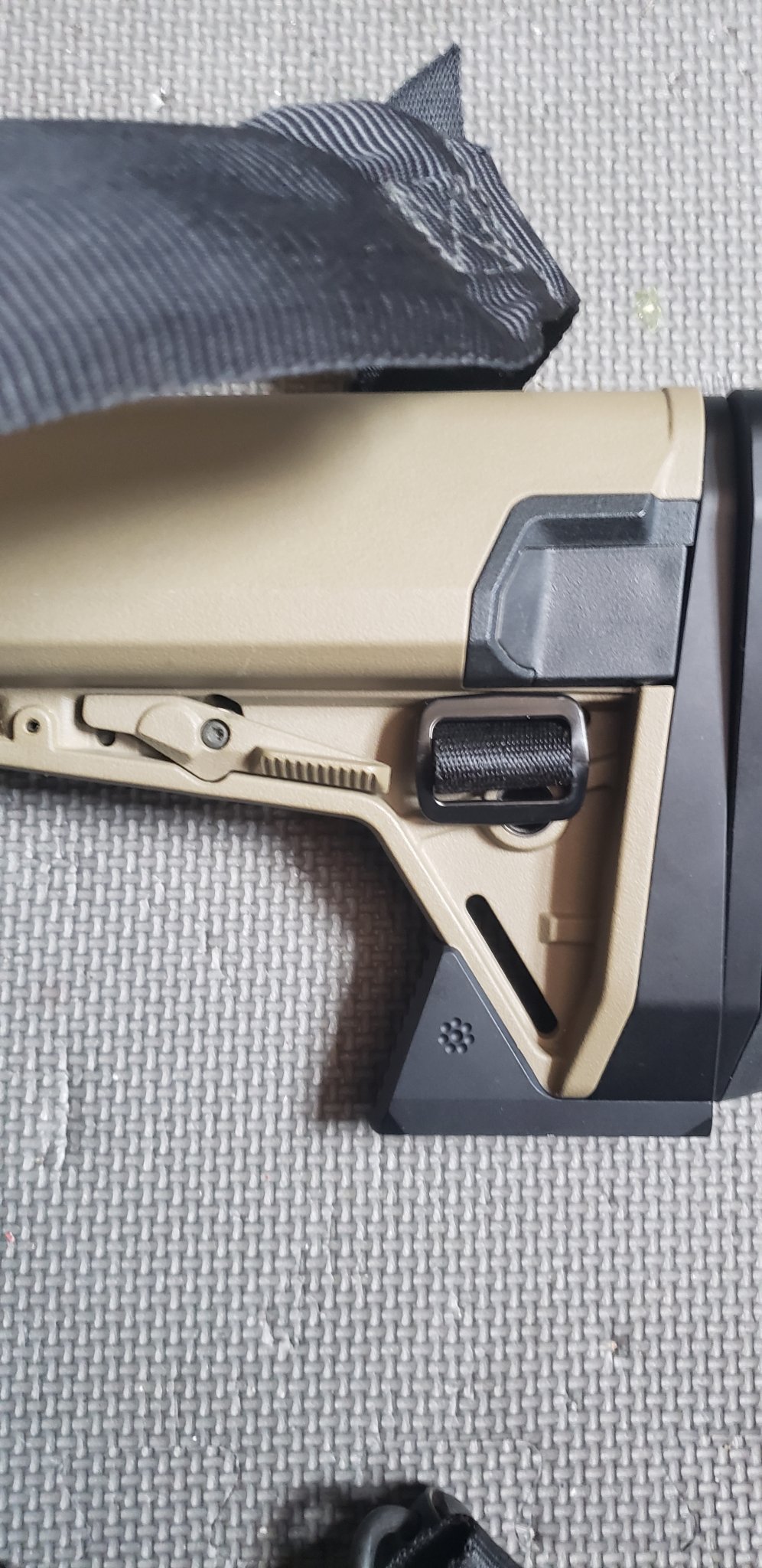

    The previous way of slinging from the HK slim stock was very good, I never even realized until now how good it was. The new B5 stock does have the problem of getting the sling under the cheek.
    I just came back from testing it for roughly 4 hours and overall it did well. Only problem was the b5 stock getting the sling under my cheek, not sure if I keep it or not. It sure balances the rifle better.
    It seems the longer handguard mounting point had no problems. I did have to buy a new sling as the old one was too short.
    Are you looping it around the stock like in your picture above? If you are, instead of that, try routing the sling from the right to the left (for a right handed shooter) through the slot and using one of the tri glides as a stop so it can't pull back through. This will keep the sling routed around your body and won't let it get between the stock and your cheek.
    I noticed that the scope mount on your MR223 is bridging the handguard. If that's the way you run, I wouldn't attach a sling to the handguard at all.
