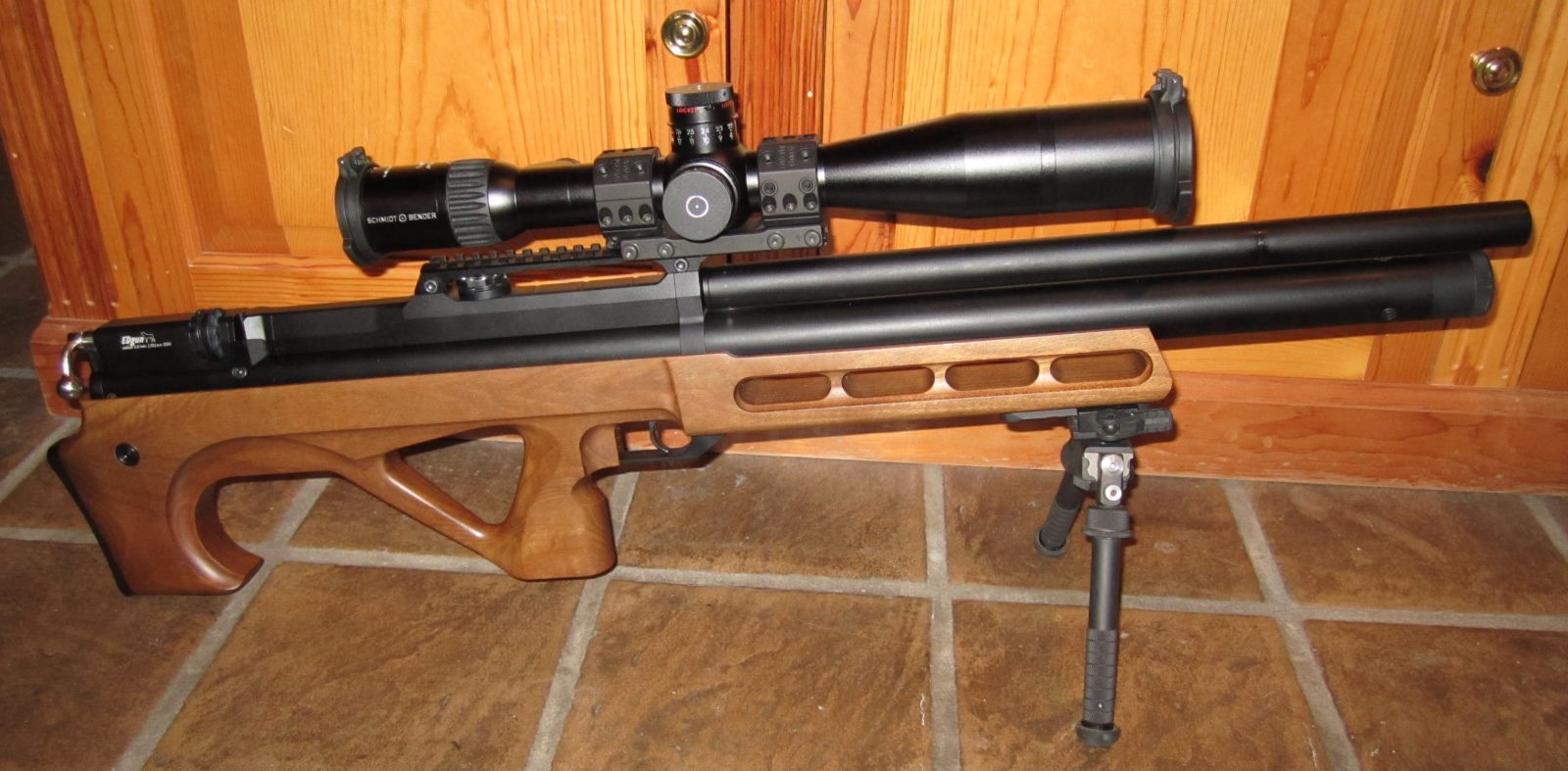

Speaking of optics and air rifles I just picked up a new scope for my air rifle last week, it replaced the Bushnell 3-12 x 44 FFP G2DMR that was previously on the rifle...

KIBA: Nice S&B for the Edgun! I'm jealous! Is that a 5-25 or a 12-50!?! Have you looked at the March Scopes at all? That's the only other high-end glass I've come across that's good for 10yds. They make a few smaller/lighter models that I think might be a great fit for an air rifle…

It's a 3-20 CCW H2CMR.
I have several 5-25 CCW H2CMRs; I tried one on the air rifle a while back. The 5-25 offers 10M parallax which is really nice for an air rifle. It was great for 50Y+ target shooting. Unfortunately it was not only a big heavy SOB on the air rifle but what I really didn't care for was the tunnelling from 5x-7.5x and the limited FOV down on the bottom end of the magnification range. That limited FOV made some of the close range "inside the barn" shots difficult-- even dialed down at 5-7.5x if the rat or whatever ran out of the FOV it was sometimes hard to pick them back up.
The 3-20 only has 25M parallax but the image is still very clear and in focus even down at 8-10Y at 3-4x magnficitation. There's only a slight amount of parallax error inside of 25Y with the magnification down on 3-4x, it hasn't caused me to miss any "close up" shots yet. Also, the FOV is huge at 3-4x. The 3-20 is also noticably smaller & lighter than the 5-25; overall it's a much better fit for the air rifle than the 5-25. If S&B had made the 3-20 with 10M parallax capability it would be even better!
With the 30MOA built into the rail on the rifle plus the 20MOA / 6 mil in the Spuhr there are 7.5 mils down (erector travel limit) and the full 26 mils up (double turn knob limited) elevation available from a 50Y zero. 26mils is good for about 240Y with the .25 caliber 25.4gr JSBs. I occasionally like to put soda cans out at 200Y and plink them. I use the rifle mostly for hunting & pest control between 35-140Y but it also gets a lot of paper target practice from 50Y-100Y.
I'll admit the scope is total overkill; I had a Bushnell LRHS on preorder to put on the rifle. I decided to try a 3-20 and it's going to stay, the LRHS is going to end up on my 10/22. Since I use the Edgun almost every day I figured it might as well have a really nice optic up top.
I have tried March in the past (a friend has a couple); love the size and weight, really like the turrets, they all offer 10Y parallax which is perfect, I could get used to the somewhat tight eyebox and narrow depth of field / parallax... but I really don't care for any of their reticles and that's the deal breaker for me. If March came out with a reticle similar to the G2DMR or H2CMR in the 3-24 x 50 I'd have at least one!

Kiba did that Edgun come with the 30 moa rail or was it aftermarket?
Ed made the 0.5 degree (30MOA) canted scope rail standard starting with the R3, prior to that it was not canted. Several guys on the air rifle message boards have bitched about not being able to get a zero on their R3s but that's because they were using optics with limited elevation travel. Also, it seems many of the guys on the air rifle boards feel their scopes need to be zeroed at the exact "optical center" of the scope and they're not happy with any other way so the 30MOA rail isn't conducive to that either. However, a set of Signature Zee rings with the offset inserts is an easy fix for that situation.

Kiba, that is an incredible setup you have there.
