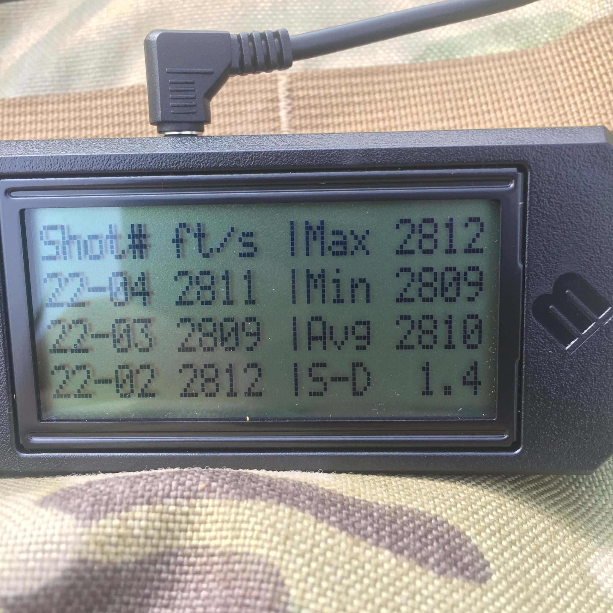

Decided to try out some Berger 140’s and had recently read the Scott Satterlee 10-round load development article from the 6.5 Guys. Ran a ladder, and got a few flat nodes, not they aren’t as ‘long’ as the ones referenced in the article. I’ll post a pic below. I’m guessing take the higher charge and load in the middle now?
Also, I’ve never really found pressure on this rifle and still have a fair amount of case capacity (Lapua 6.5 CM H4350). The last number is phenomenal speed for a 140, would you go up another few .3 increments and see if there’s another flat spot around there?

I’d go for that node at 2805. That is a common accuracy speed for the Creedmoor.

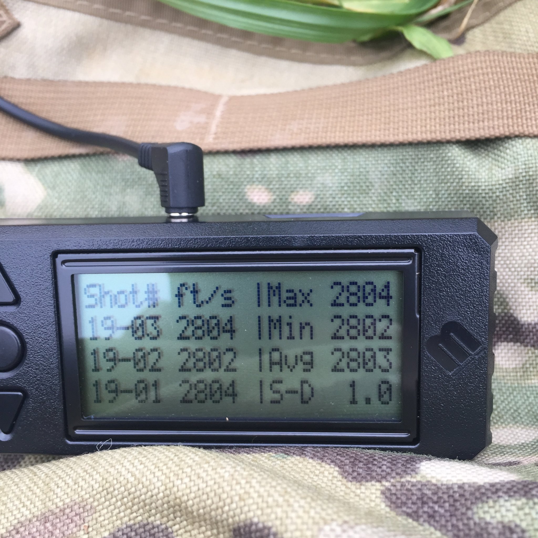

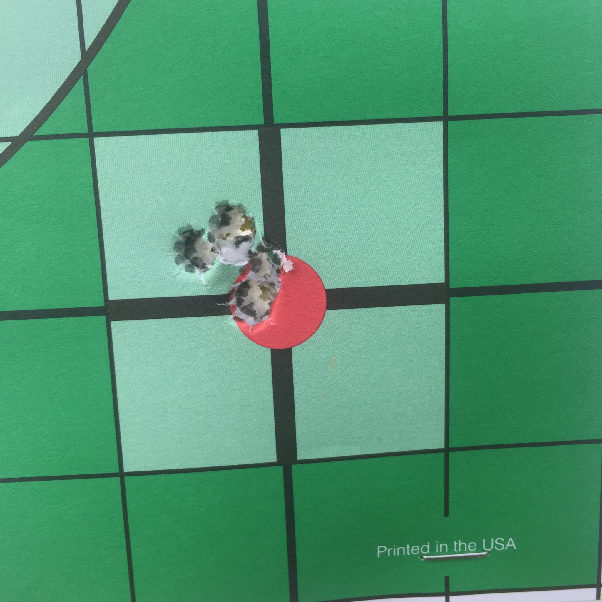

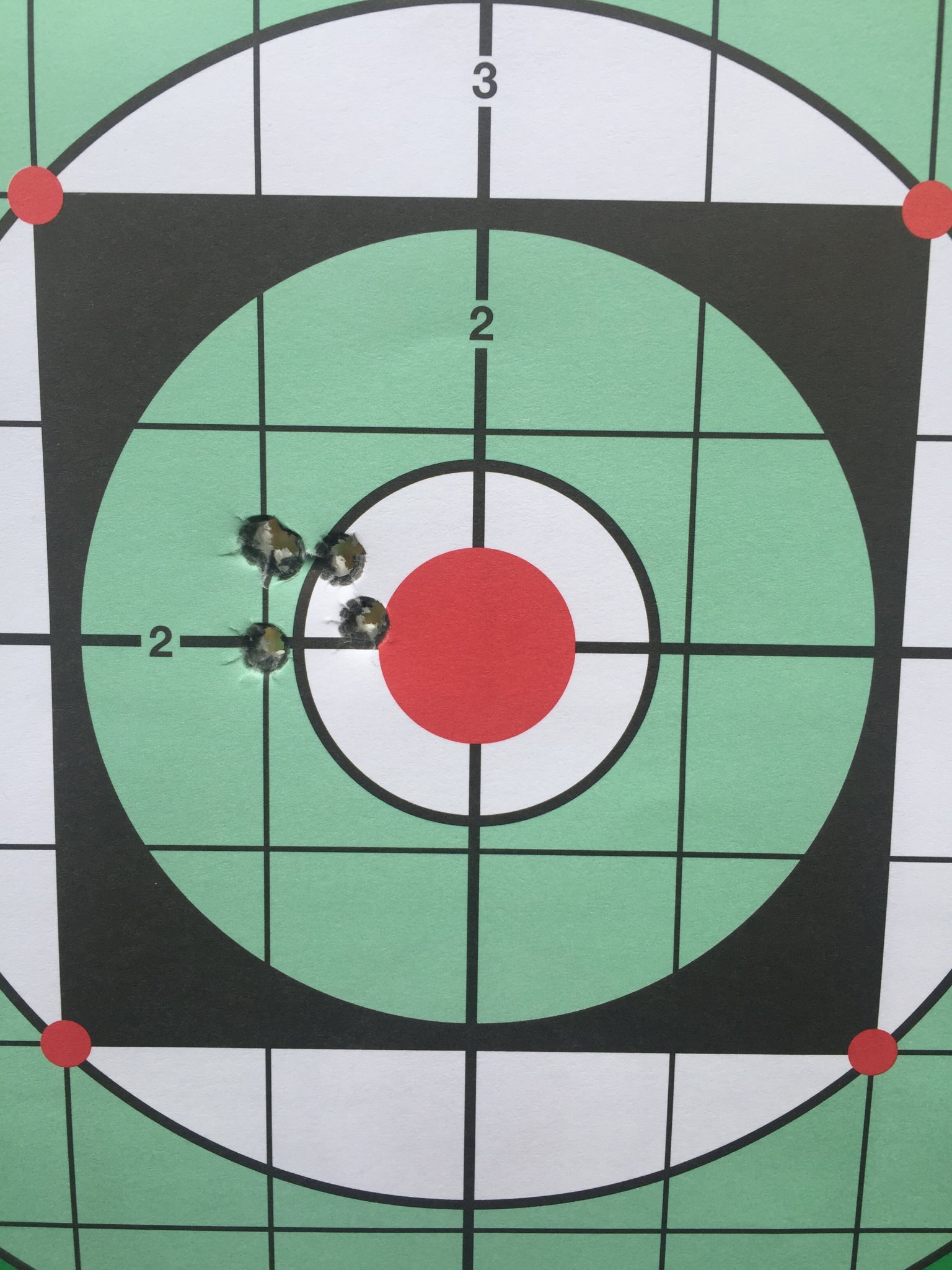

Hasty groups, but even then not terrible. I think with a seating depth test this will be phenomenal.

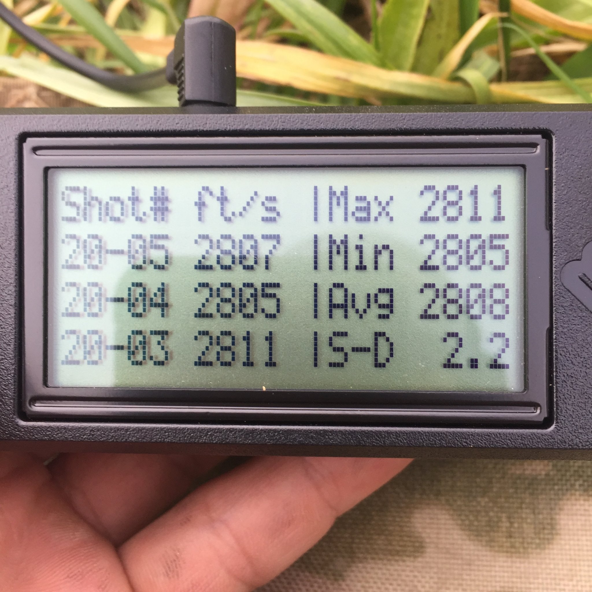

41.5 and a 140 seems to be the ticket for me.. I'm about 30fps faster though w/eldm's
I stopped at max charge weight 42 (per Hornady

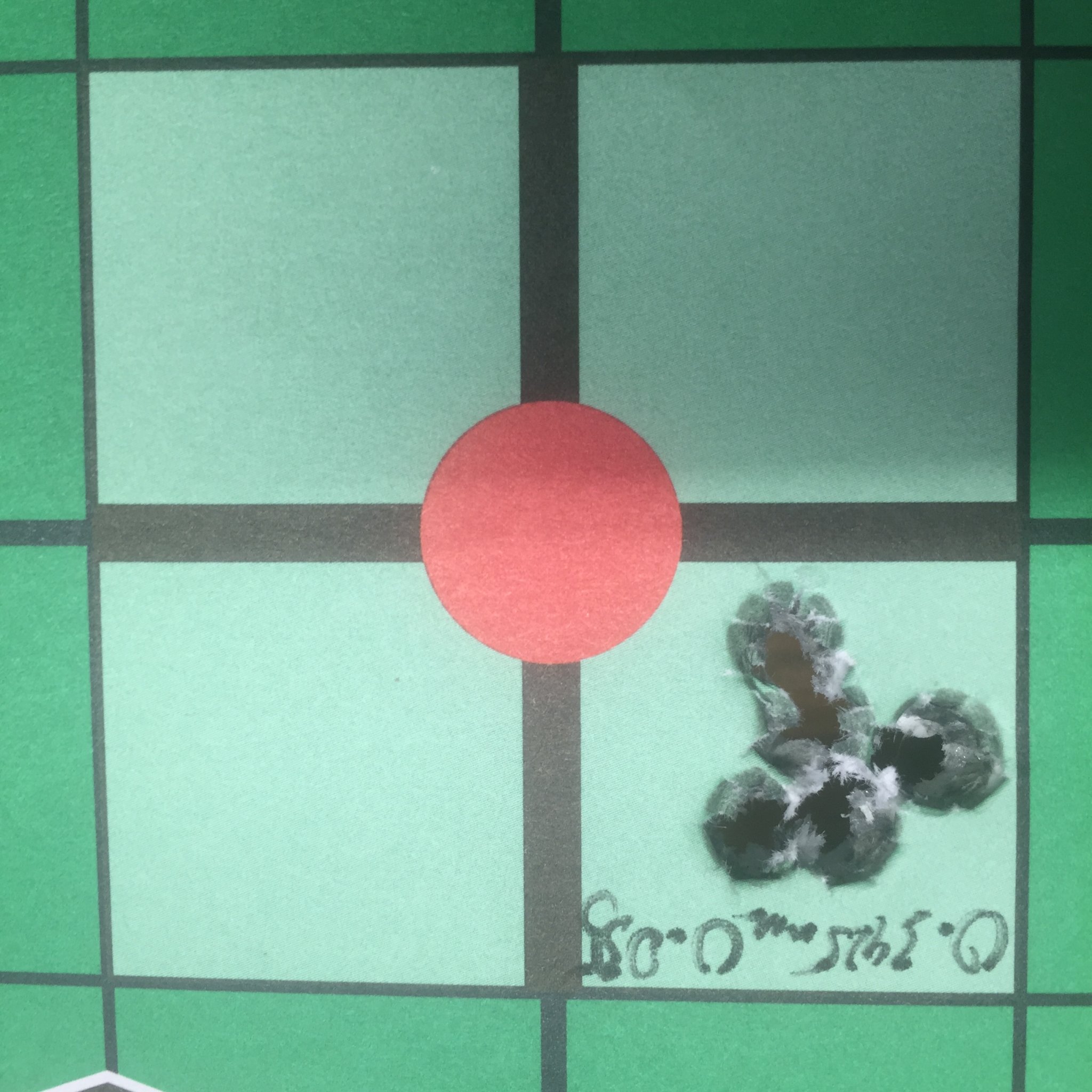

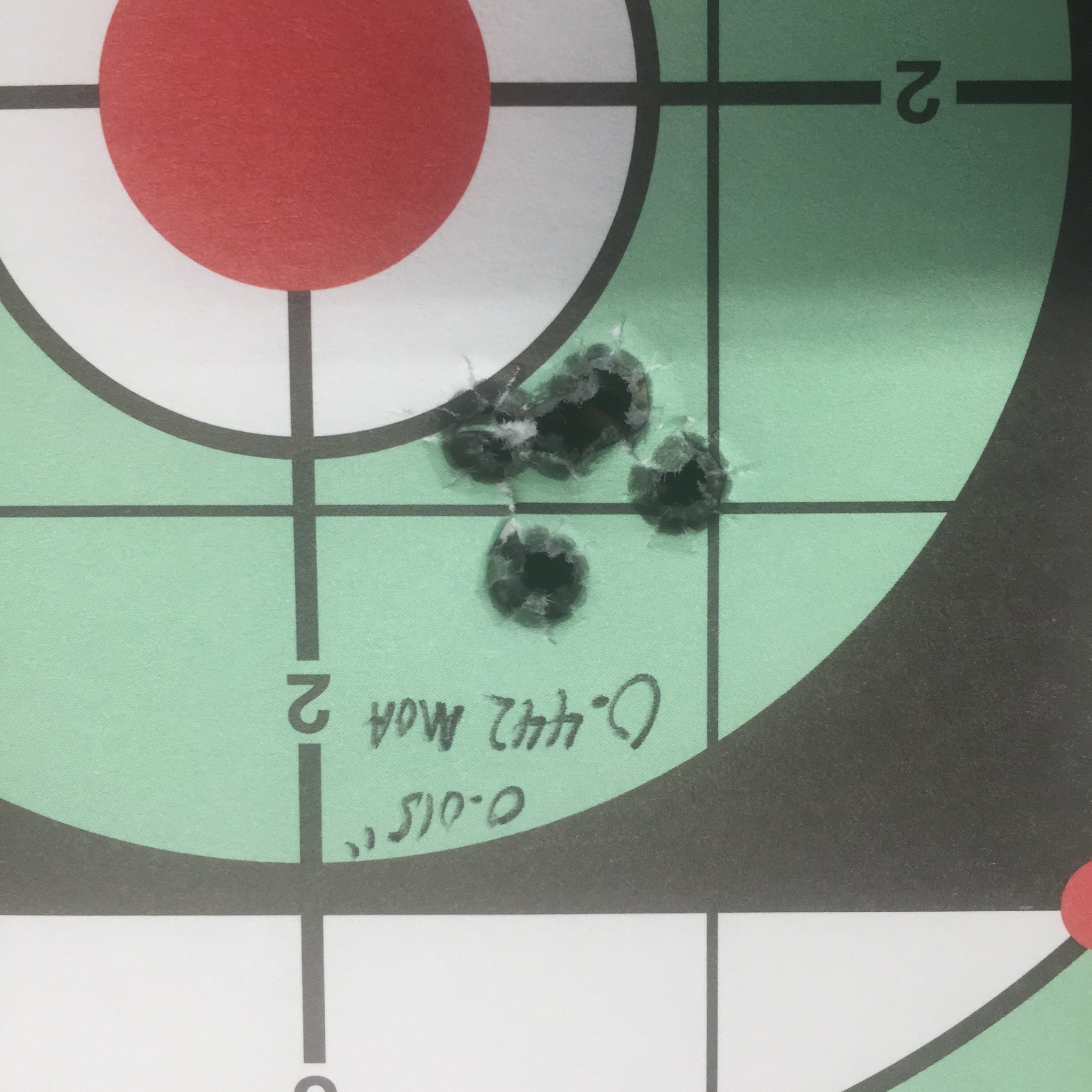

Ok, seating depth test today. Two pretty solid groups. The .015” jump group included the cold bore and came in at .442 MOA, and the .035” came in at .3925 MOA.

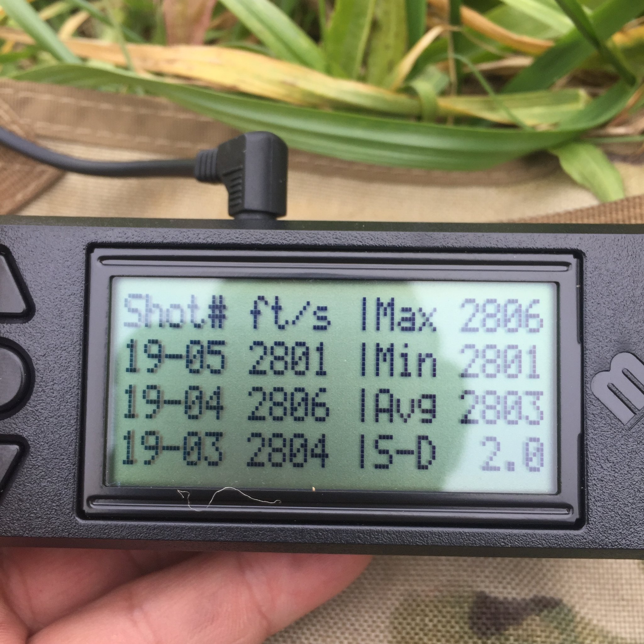

I didn’t run these over a chrono because I wanted to see what they did with zero influence from the Magnetospeed.
If everything works out, I’m going to load 10 of each tomorrow and run them over the MS. I’ll let you know if the ES/SD hold up @CanSniper
I have a feeling the .035” jumped load will send the numbers up a bit, but if it doubled it, I’m at 4.4 SD lol.

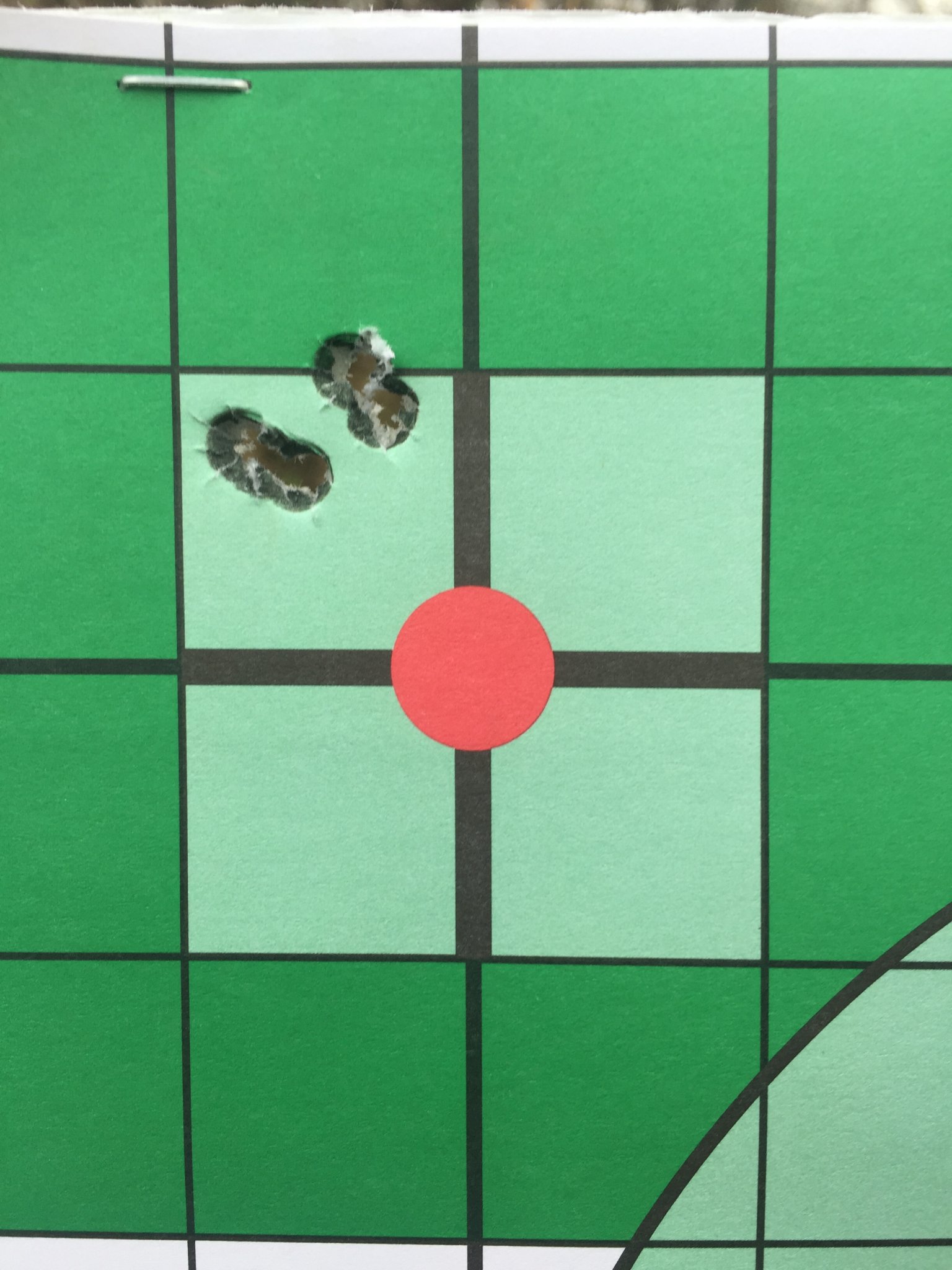

Pics I took upside down like an idiot.

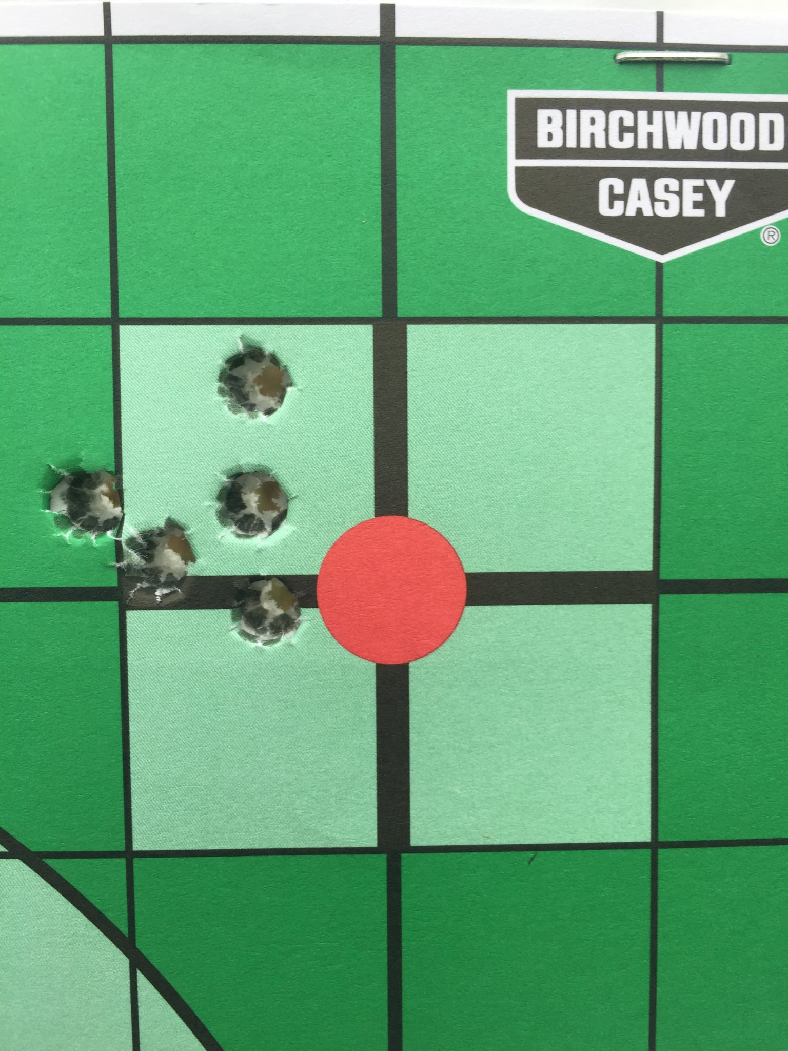

@CanSniper it held up and I’m running with it.
