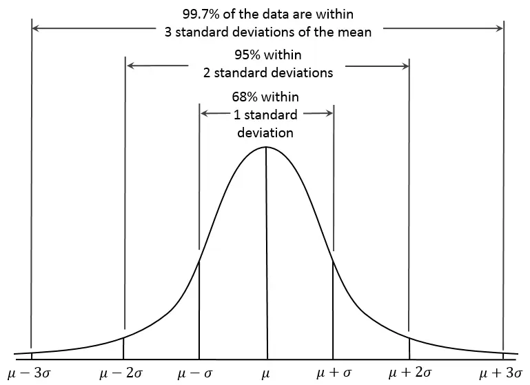

SD and ES are connected at the hip. They aren't independent of one another. One won't do something on target that another will such as smaller groups vs dropping fewer points.
Whatever your true SD is, your ES will be six times that amount for 99.7% of your shots. The other .3% will consist of increasingly larger ES, but obviously will be pretty rare since it's 0.3%.

Your graph is for a large sample of a process "IN CONTROL".
While we HOPE that our reloading and shooting processes are in control,
any rogue variable introduced will skew that curve.
Bullet making is a process.
Case making is a process.
Primers have their own distribution (which may or may not have an impact).
Powder charge, the one thing we try to control is a process.
Independently they may skew the final process of making rounds.
Your graph is for a large sample of a proces "IN CONTROL".
While we HOPE that are reloading and shooting processes are in control,
He’s smug and condescending but the graph is true for all stats. That’s just how sd works. You’re pretty close though - keep your sd and es low and it will shoot better at distance.
It’s best not to engage with him he doesn’t try to help people just talk over them so he can feel smart for once
That doesn't change how SD and ES work. There's a reason no one outside of the firearms community uses ES. It's all but worthless and SD tells you about where your ES is going to be.
Your scenario of "sd is smaller groups but ES is more points" isn't possible. It's not the way it works.
