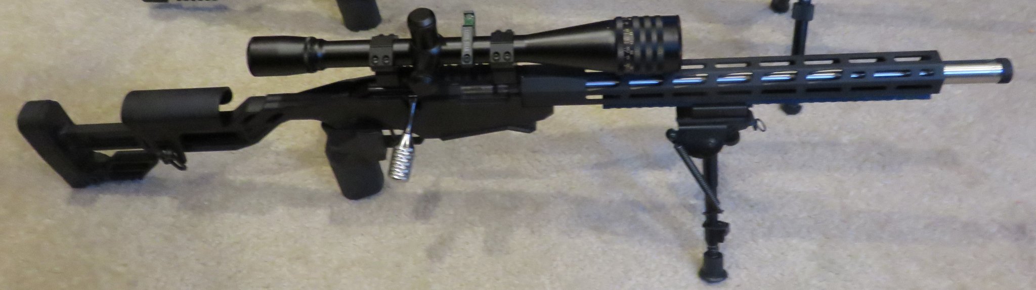

Here's an old pic when I first got the RPRR and set up the Magnetospeed.
7036910

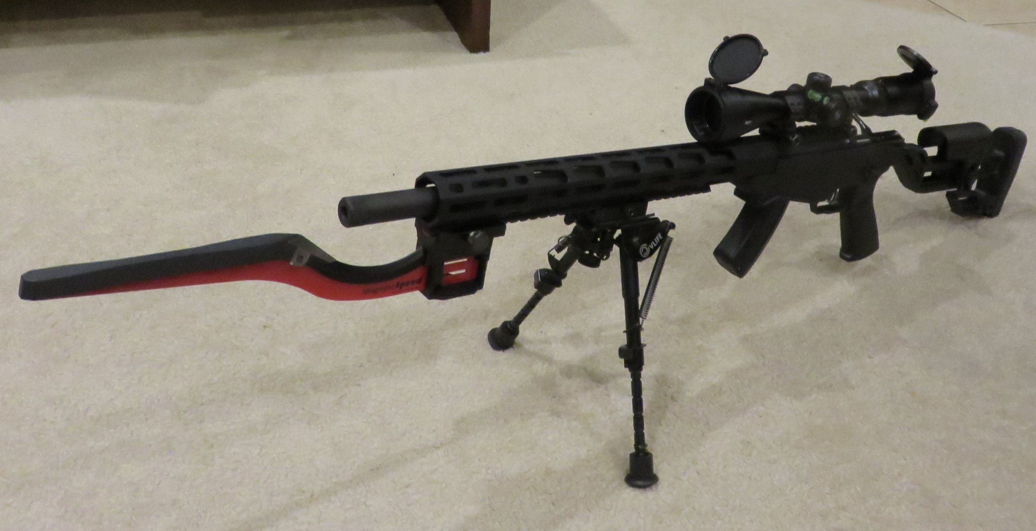

A few changes since:
7036914
