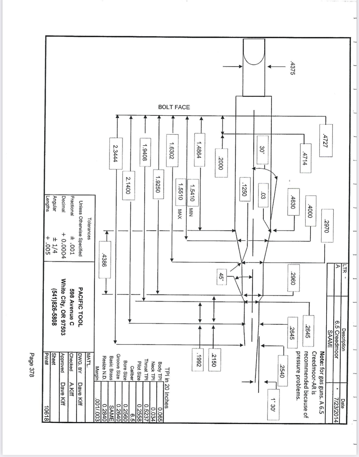

I recently built a 6.5 creedmoor AR10. I don’t want to mention any barrel manufacturers names but I ordered a custom one and not sure if there are any issues (using with aero upper and lower and toolcraft 6.5 BCG). After shooting some factory ammo I Loaded up test ammo with 130 eld-m’s to 2.776” for mag length. Couple shot well then one wouldn’t go in to battery. Saw marks of hitting the lands. Now I’m in the gun room seating them deeper and I had to sweat to 2.668” for them to cycle freely without forcing the bolt open. I feel like this is too short. Am I right in the feeling this or just keep with that seating or switch bullets. Note: was hoping to go with the 130gr to help gain some velocity. Also going to attach the reamer blueprint that was provided by the barrel manufacturer.
I recently built a 6.5 creedmoor AR10. I don’t want to mention any barrel manufacturers names but I ordered a custom one and not sure if there are any issues (using with aero upper and lower and toolcraft 6.5 BCG). After shooting some factory ammo I Loaded up test ammo with 130 eld-m’s to 2.776” for mag length. Couple shot well then one wouldn’t go in to battery. Saw marks of hitting the lands. Now I’m in the gun room seating them deeper and I had to sweat to 2.668” for them to cycle freely without forcing the bolt open. I feel like this is too short. Am I right in the feeling this or just keep with that seating or switch bullets. Note: was hoping to go with the 130gr to help gain some velocity. Also going to attach the reamer blueprint that was provided by the barrel manufacturer.View attachment 7461874
What's your CBTO measurement on your loads?

I feel like there is something else at play here. What are your other measurements? Headspace compared to fired, case diameter at the base, length of factory ammo, etc.
