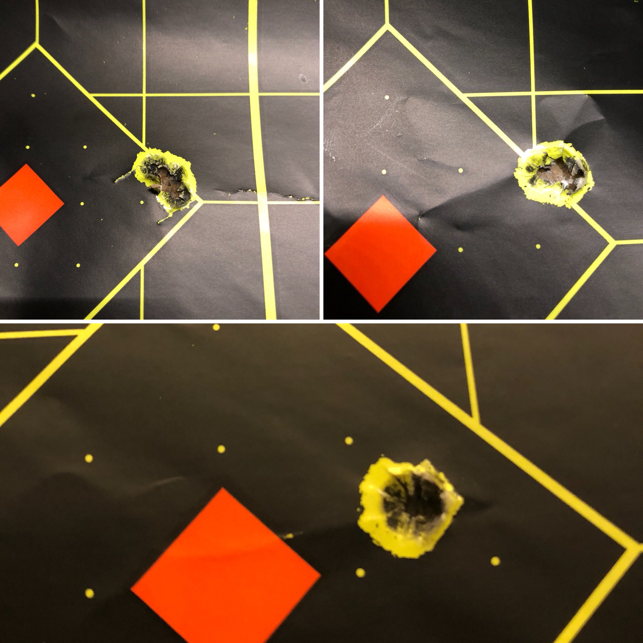

    Shot multiple groups of 5 lots of seating depths for the 6.5CM because for some reason, I like splitting hairs and dicking around with things.
    The results, other than the last 2 lots (the most jump) being really terrible, probably due to the 'hotdog down a hallway' syndrome, everything else was fantastic.
    The thing that has me wondering if I should even change anything from my initial testing of rounds that are sitting exactly where the rifling begins, shoot almost identical to any other further seated (more jump) bullets. Would there be ANY advantage to having it jump more? The rounds that are touching the rifling are not jammed, so there is 0 change of a stuck bullet when ejecting a live round; so again, any purpose to jumping rounds if the accuracy is the same?
    Lot 1 - 2.243 ogive measurement; sitting on the rifling - average of groups was .475
    Lot 2 - 2.233 .10 jump - average of groups was .497
    Lot 3 - 2.193 .50 jump - average of groups was .453 and then went to further shoot another 5 shot group in the .4s
    Lot 4 - 2.153 3 groupings ranged from sub MOA to 1.25 inches
    Lot 5 - 2.113 3 groupings all sucked
    Lots 1-3 basically shot the same. There is probably more involved with trigger control and what fraction of an inch the reticle was on more than the actual bullet depth. Is there a reason to either stay with the round on the rifling, or go with one with a little jump? Or at this point it honestly doesn't even matter?

    Splitting hairs, one of the top 5 PRS shooters in the country told me over the phone when I was pulling my hair out doing load development that, "A well made gun is going to shoot". I shoot a GAP rifle so I know I'm good there...
    Then, he said to set that bullet .01 off the lands then do a powder charge ladder test. If the load has ES of 20 or less and can shoot a 1/2" group. Call it good and start practicing. This method has taken all the stress out of me and look at my results. I was doing ladder tests with gun powder in .2gr increments. These are 3 3shot groups going up .2gr on each one. ( I know 5 shot groups are king but again this is ladder test targets). Is their really an doubt...

    There's quite a bit of POI change. Is that intentional?
    That's not much POI change at all for ascending charges. Pretty much the same impact point. Take his charges up another .4 to .8, and you will likely see the group open up and shift to the other side of the bullseye or something similar

    The only thing I noticed was some groups would get very obvious horizontal stringing which is usually tied to the seating depth. I'm going to seat them further forward to 2.233 and 2.223 and see if it likes the .10 jump (which it did on the initial testing) as well as the .20 jump and then settle on one.

    I'm guessing the .50 jump initially tested well but ended up having quite a few groups that were very horizontally strung. That usually can be remedied via seating depth. I agree (and mentioned it in the OP) that I didn't necessarily want to have it touching the lands in case I wanted to unchamber a round, but seems that the final tweak will be either a .10 or .20 jump.

    I have never heard of this being the cause. Can you elaborate?
    Go onto 6BR or any of the heavy reloading based sites; its been mentioned for a long time that the effect of a 'bad' seating depth can be worse accuracy as well as horizontal stringing. Obviously there's other causes of horizontal stringing as well, but when you are testing and it never happens until it happens multiple times testing multiple groups of the same seating depth, its probably that.
