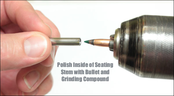

A properly fit seating stem will not mar the nose, so either way, I'd recommend replacing the stem or polishing out the little burr that causes the ring

Polish out the seating stem, or use epoxy to create a custom profile in the stem.

A bullet will be harder to seat into a hard neck set to .002” tension vs a soft neck. The harder the bullet is seating the bigger the mark on the bullet nose. I never had to lap any seating stem.
