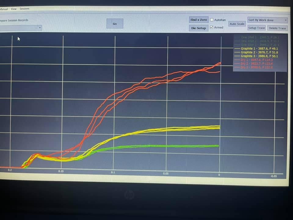

    This is where things like amp press shine.
    You can see exactly where seating pressure spikes or drops off. Allowing you to experiment and figure out why.
