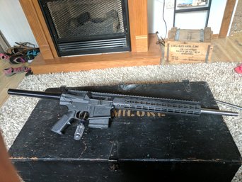

Mines done, just received the rest of the parts an hour ago. All put together and ready for testing. Mine is 100% AR15 rifle length gas, not armalite rifle gas. On my way out the door to test this baby with some factory ammo since my Forster dies wont be here till tomorrow. I had a Slash 308 heavy buffer and spring sitting around so thats whats in it. Will be shooting surpressed. We will see how it goes. may switch out to a standard 308 rifle buffer.
Just about to mount the Vortex Razor HD 5-20x50 MIL/MIL then Im off to test it.
Nice looking rifle if I do say so myself! It will be a little while until I get the rest of the parts in unfortunately. Waiting on gas block info since mine is exposed and I really want a 3 position like the noveske/micromoa/paladin machine. I also have to make a muzzle device to reflex my suppressor a bit but that's a night in the garage away.
