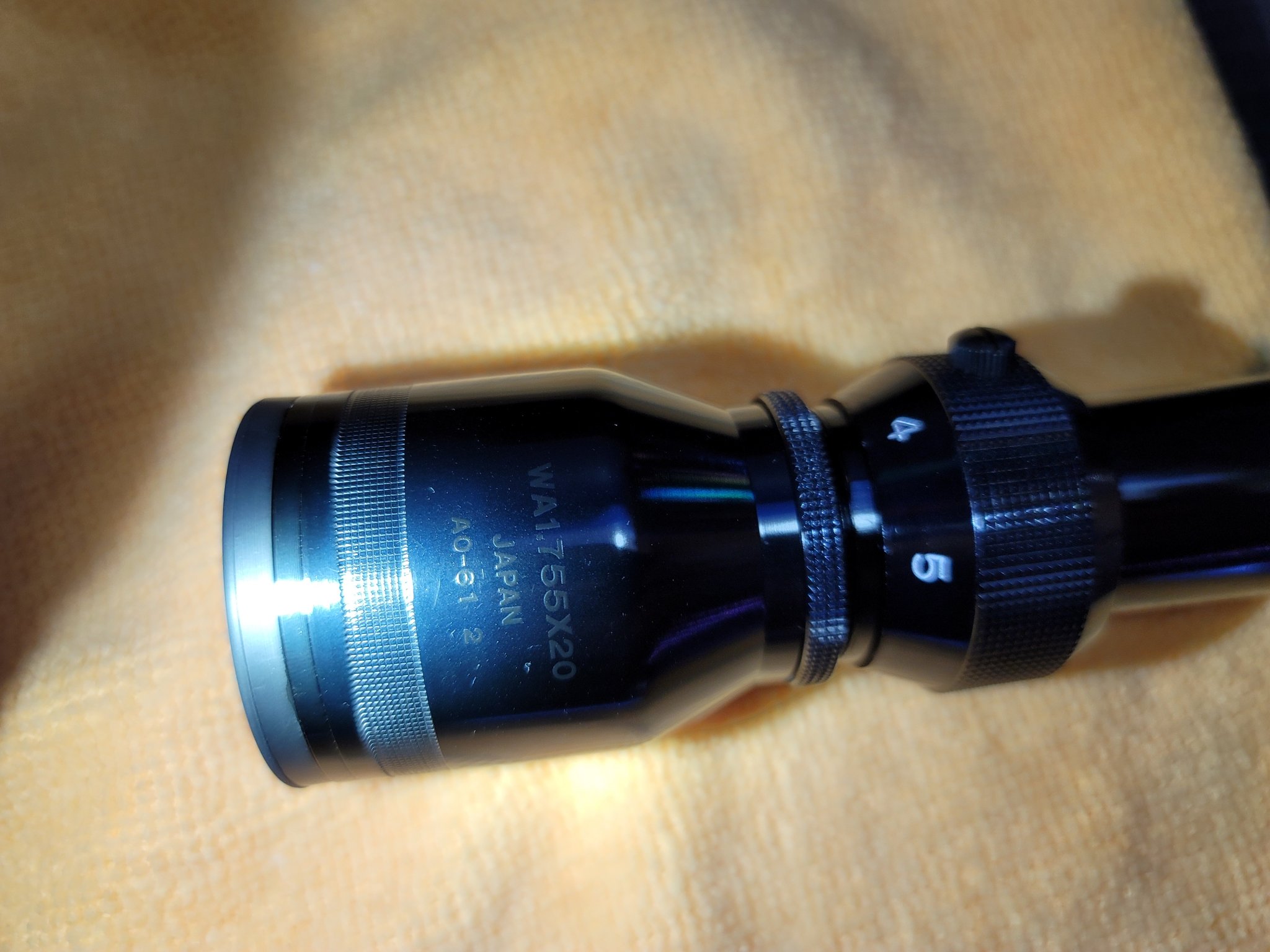

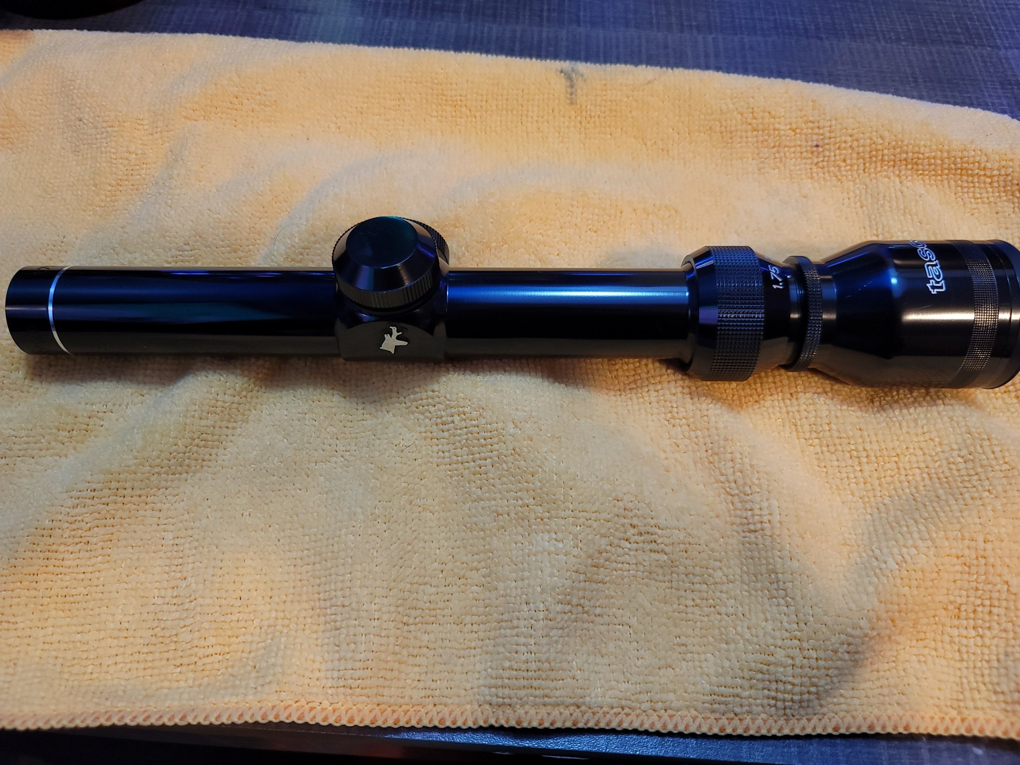

    I have an old Tasco Japanese scope. It's a 1.75-5x20 that my father had. I was going too mount it to my lever gun but after cleaning it I gave it a shake for some reason. Glad I did. That's when I heard it rattle. Sounds like a loose lens past the turrets. Glass is still clean and clear. I sent Bushnell a ticket, but doubt they will even want to look at it.
    So I was wondering if there is a company, or person, who repairs old optics. Disassemble, clean, new seals, purge, whole nine yards.
    Or is this just a shiny paper weight? Was looking for a gloss black scope. Nobody makes them any longer for some dumb reason.

    For maybe 50 years I've had a Tasco Olympian 4x32 made in Japan unit.
    I do not recall the issue since it's been so long ago, but I do remember having to open it up and fix something to do with the prism.
    It is not a gas filled scope, so no worries there.
    I remember that it was nothing hard to do and to this day it still works perfectly.
    Surprisingly good glass too.
    I say go for it, just remember to keep everything pristine clean (wear surgical gloves or something).

    Well if it's not gas filled then I might go ahead and do that. I work for Eotech, so handling optics is nothing new to me.
