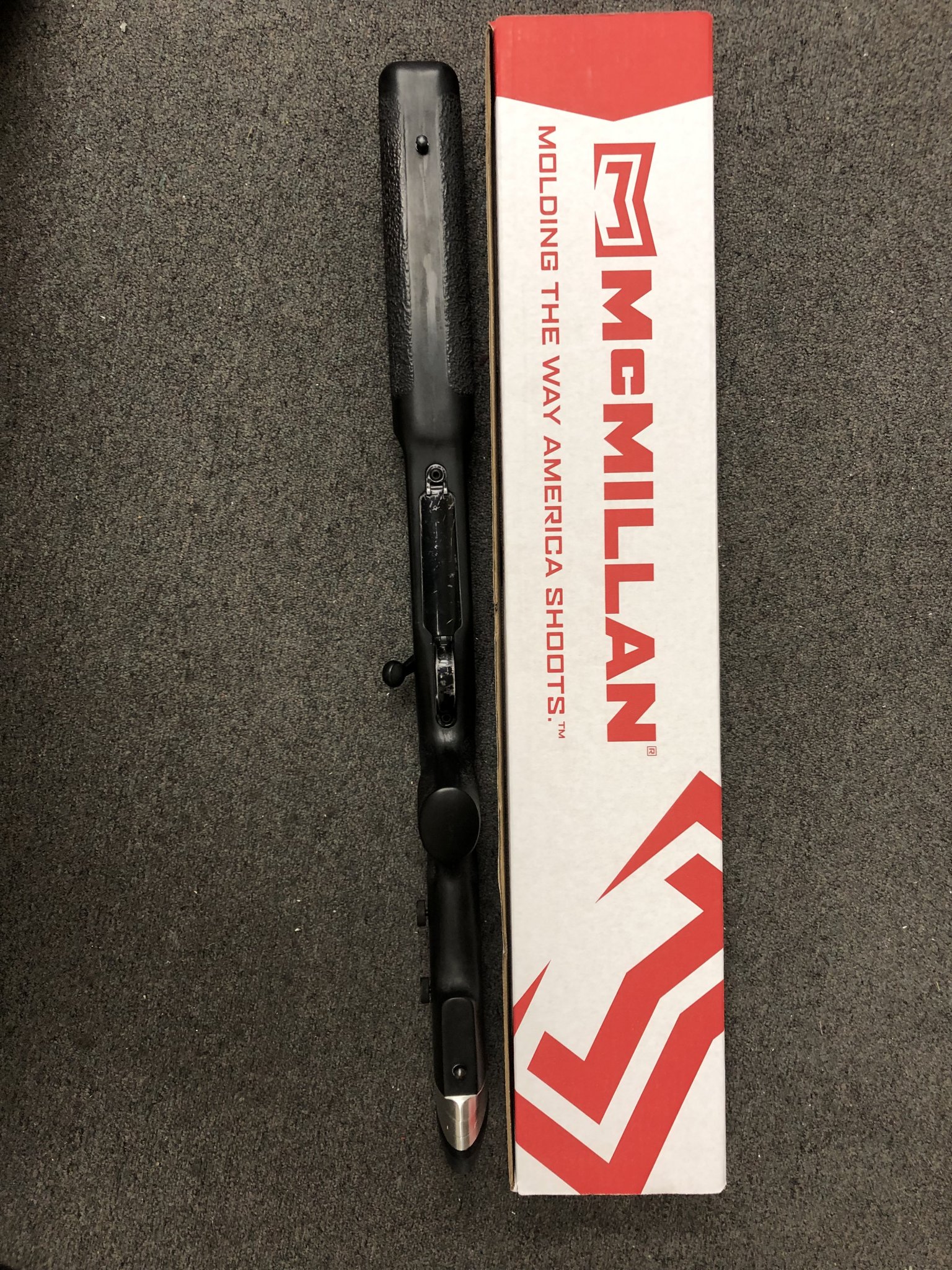

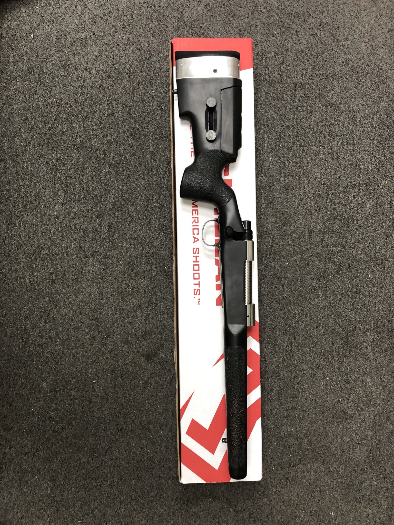

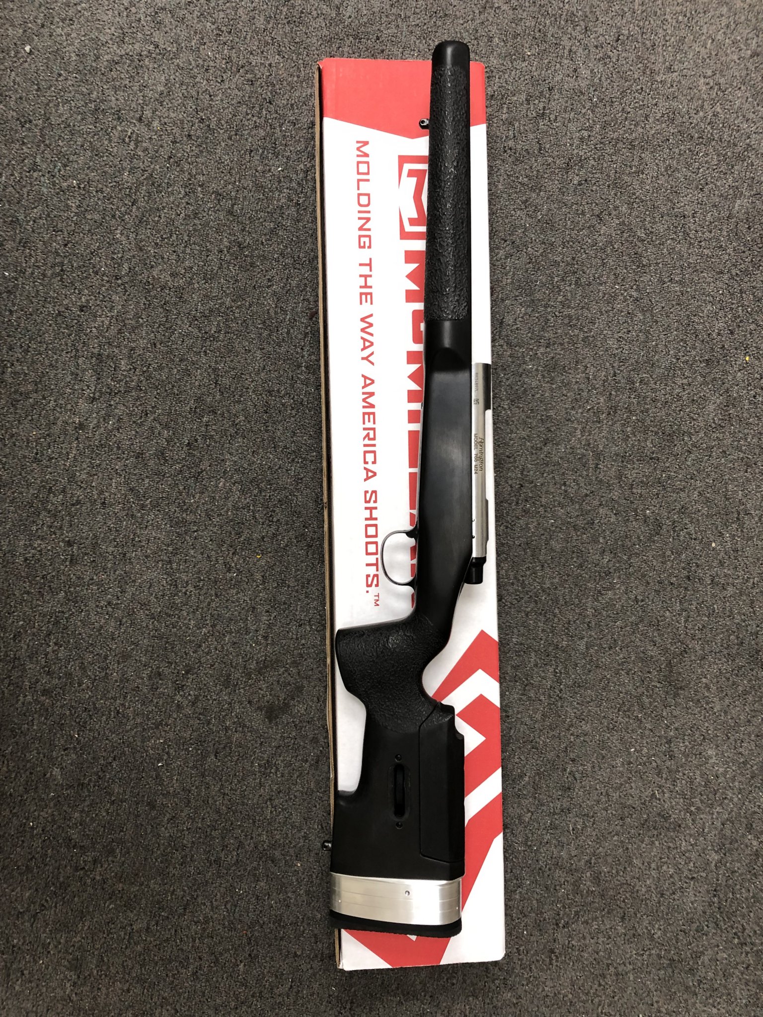

    I am in the process of trying to build a clone of the “JAR” rifle that the Secret Service used. I am specifically wanting to build the McMillan stocked version. From my research I come to find that they used 7mm Rem Mags and later switched to a 300 Win Mag some time later. Does anyone know how these Rifles were built out? Remington 700’s or M24’s? Barrel maker, profile, length, twist? Suppressed or not? If so, what suppressors did they run? Trigger? Optic and mounts? I have also read that the bottom metal was an aluminum BDL unit. Can anyone confirm this?
    I already have the McMillan stock for the build. I have an M24 action available and an M24 trigger. I also have several old Walker triggers I can pull from.
    Any help is much appreciated and if anyone can post any pictures that would be awesome!
    Thanks everyone!

    The version I am after is the McMillan A5 stocked rifle. I have included a few pics. The stocks were black gel-coat finished with an adjustable LOP and cheek.
    I doubt that the M24 is the correct action but it’s what I currently have available. I believe that the aluminum BDL bottom metal is correct but clarification would be appreciated.
    This is probably the toughest rifle I have tried to clone so far. The M40’s, M24’s, and MK13’s have such a following other than actually finding legit parts for those, they have been pretty easy to figure out. The JAR is a mystery of sorts.
    I appreciate any and all information!!
