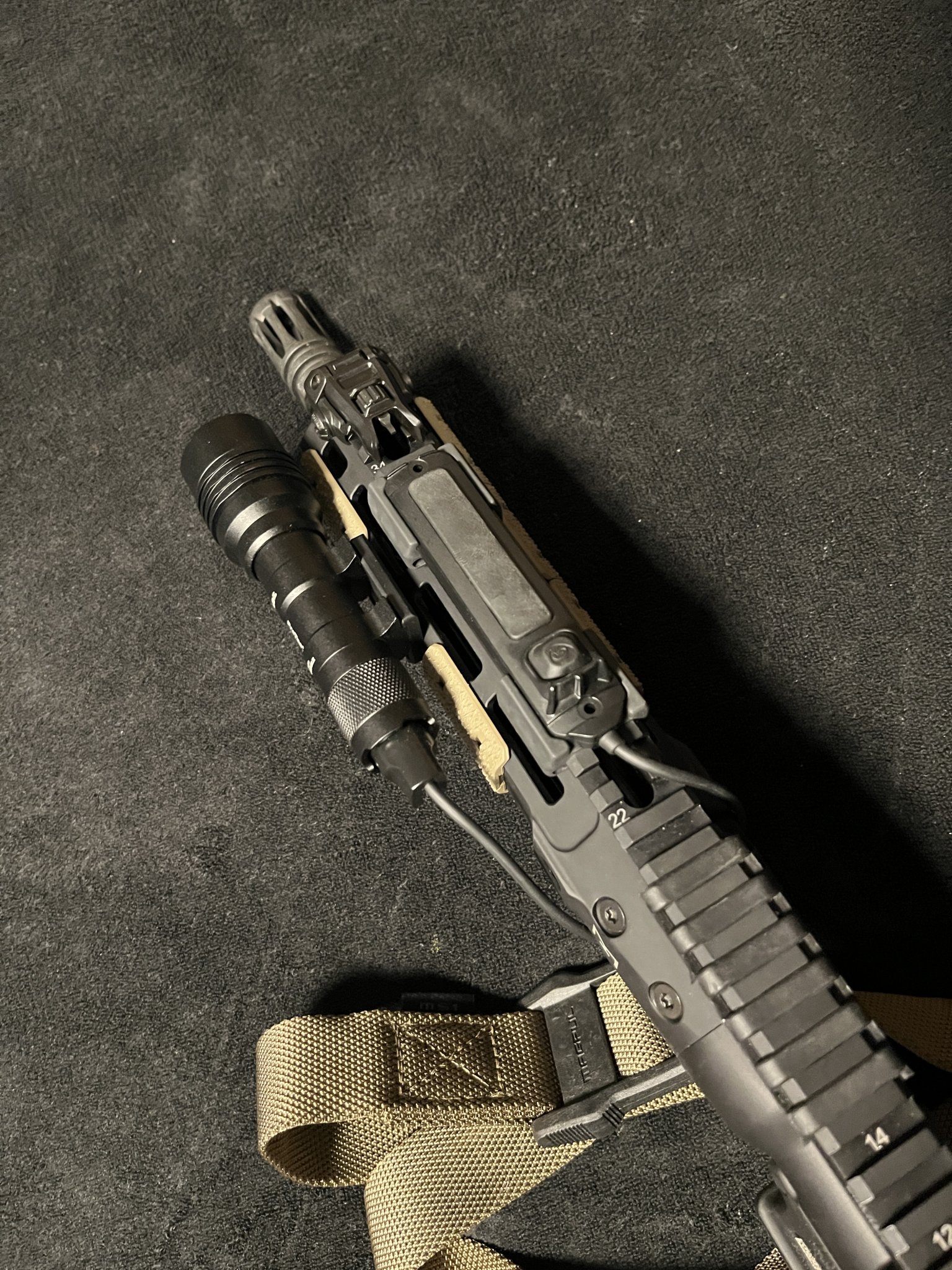

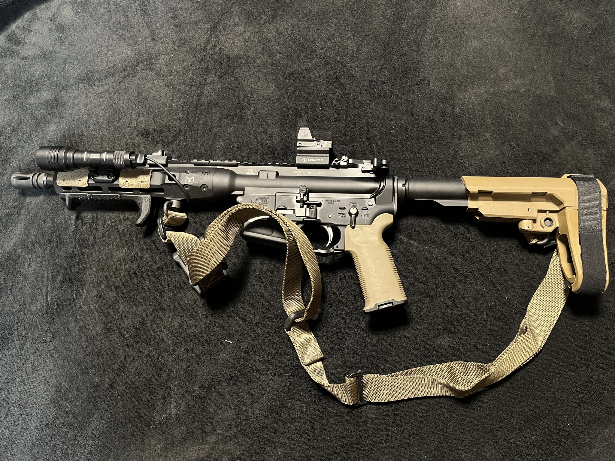

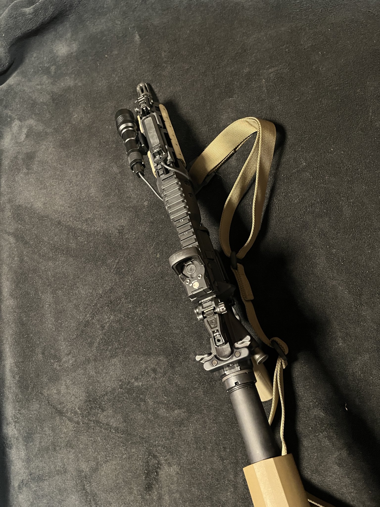

Since you’re asking specifically about AR pistols, here is how I have my RM1 on my 10.5” LWRC DI 5.56. It’s on an Arisaka flat mount:
This pad is a newer style than the one on my LMT (or my previously issued rifle). The older ones looked nicer, but they both work.
